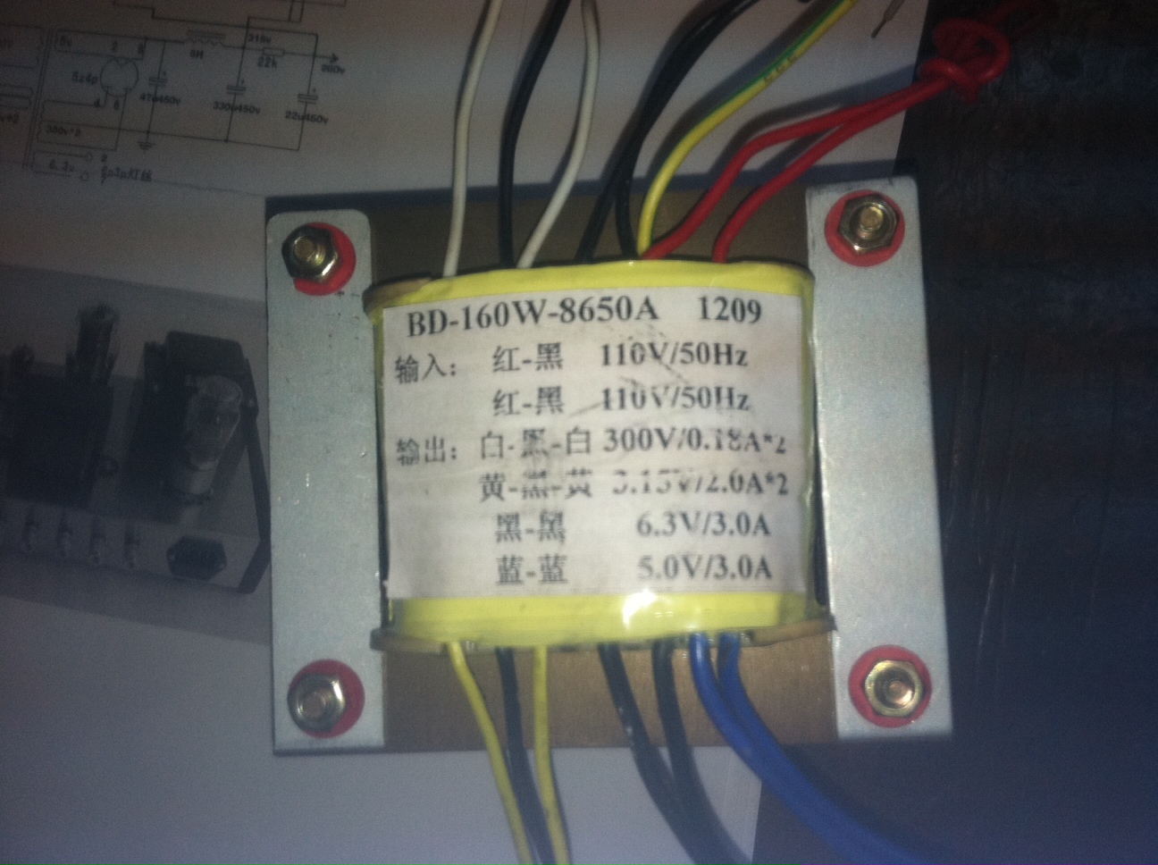

Hi Siliconray, I ordered you 6p3p amp kit, but the power transformer I received looks completely different than the transformer you posted earlier in the thread. Can you please label all the leads coming out of the transformer I received from you?
Sorry for the troubles..
this is the new version transformer. It can be configured in 110V and 220V. the pins are:
red-black: 110vAC
red-black: 110VAC
white-black-white: 300V 0.18Ax2
yellow-black-yellow: 3.15V/2.0Ax2
black-black: 6.3V/3A
blue-blue: 5V/3A
