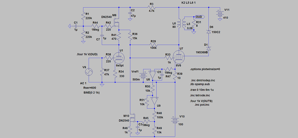

Hi Ale,
That is how I simulated in LTSpice. Will be interesting to see if it works IRL.

Hi Lars,
Ok will try to trace both set of curves. I will see if I can get the tracer up and running and do this.
Should R1 and R2 be a pot (e.g. 200K) and then calculate feedback based pot position? Interested in looking at the Schade curves anyway...
Ale
Feedback is said to work well in the region of 10%. I would start with a 100k R2 and then try with down to 47k. Wonder how it will work then? Lots of DC on the grid from the anode.

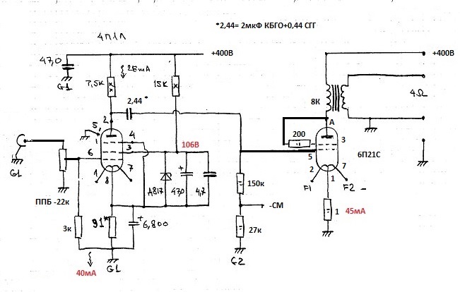

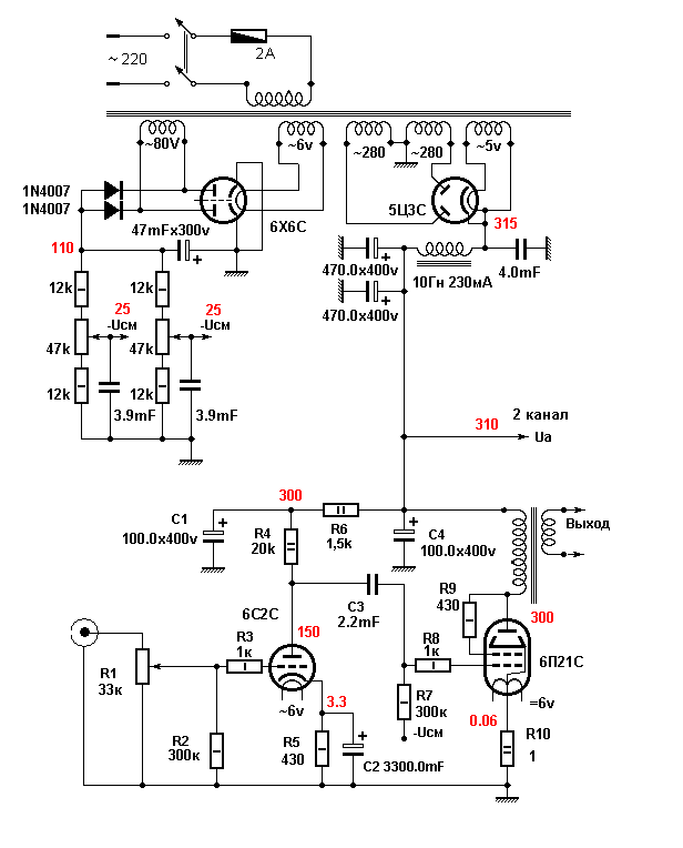

A bit of action over on the Russian board
https://sites.google.com/site/sever...esevernyjpribojzimafotosessii/usiliteli/6p21s
ñõåìà SE 6Ï21Ñ - Ñòðàíèöà 4
TANk likes it "По звуку в триоде, на мой ух, лампа не хуже 6С4С. Друг, для которого делался этот макет очень хотел именно прямонакальный усилитель и он остался им доволен. Забрал, хотел сам потом сделать красивый корпус, но поскольку усилитель у него постоянно "на слуху" новый корпус ему явно не грозит"
"As for the sound in triode, to my ears the tube is not inferior to the 6C4C..."
There's a schematic also which has 300v on the plate - my 425v was clearly the wrong operating point. I should give it another go I suppose. I note that the resistor between screen and plate is more like 430 ohms - I was using 100 ohms.
Although the last post has a schematic running it at 400v and 45mA which is exactly what I was doing, and with a 4P1L driver.

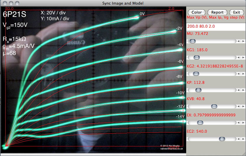

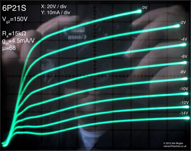

Hi Lars,
Here they are. The model is using Dmitry's pentode tool, and fit them the best I could. I'm good at the triode model, but fitting the tetrode is a challenge. Anyway, do you think is good enough for the basic test?
Ale

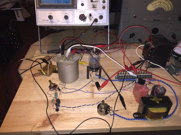

My test setup for 6P21S:
I got almost 5W out of it in triode mode with 350V/55mA across the tube, a 3,5k plate load (with CFB from the 8 ohm winding) and some A2 operation🙂
