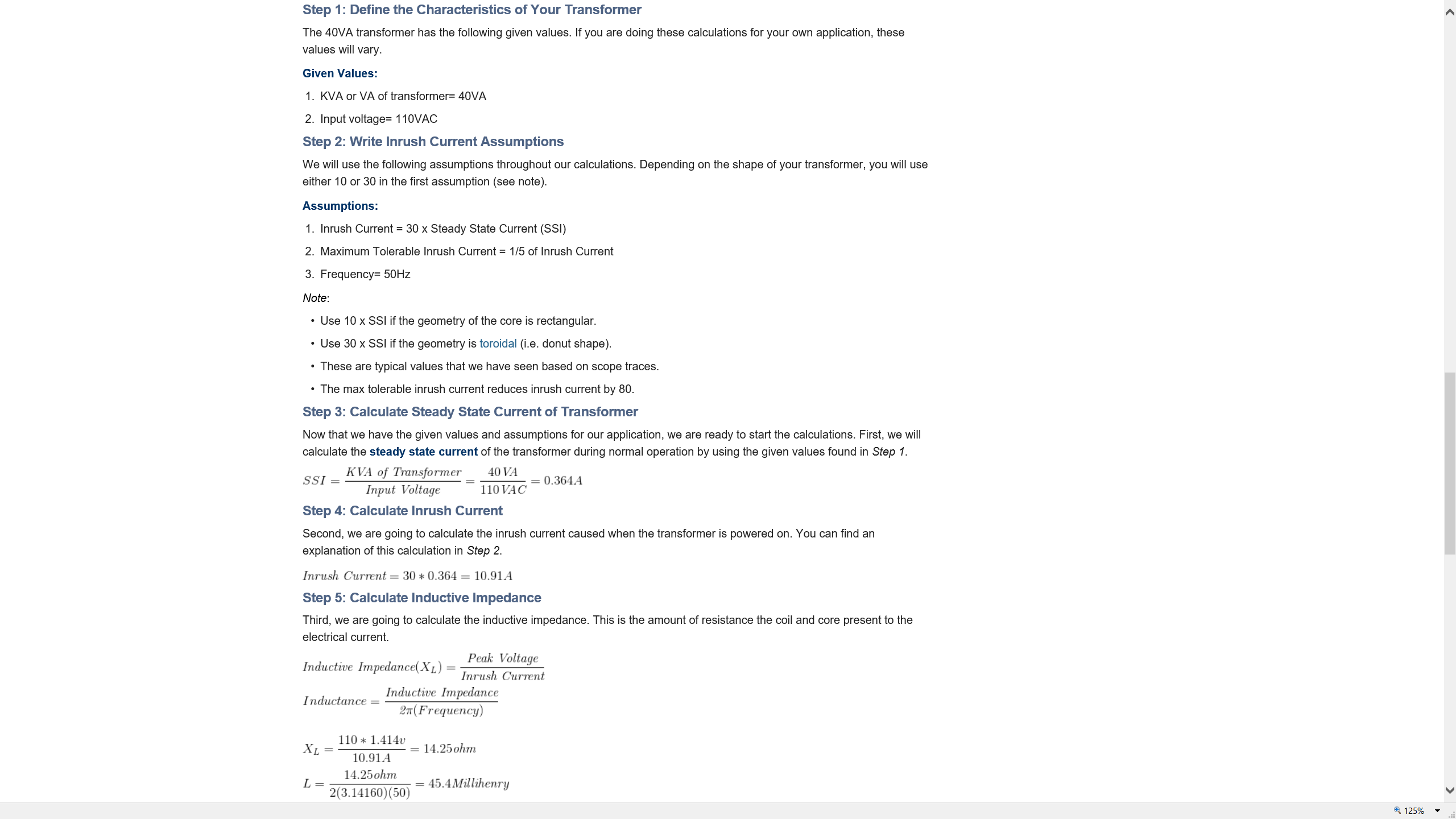

I am going to use a similar relay - I assume you want a soft start after the tubes' filaments have warmed up.
I have worked out what to use on the primary winding as NTC's and am going to use a 6NO60 instead. I will use three 200D9 NTC's in series with the primary winding of a 80 Watt mains transformer @ 240V. Short NTC's after 60 seconds and the filaments will have about 5V while cold and when the tubes start to heat up then the NTC's start to loose their resistance and the HT gets higher. After 60 seconds the delay relay will come on to short the NTC's so ensuring that they are cool when the amplifier gets restarted. I've calculated that there will be not more than about 30V across the NTC once they've heated up.
I did something similar with an amplifier I build in the ast and it worked fine - the filaments did not suddenly light up like a light bulb and HT was limited at startup.
By the way: the delay relay is rated at 115VAC and only 30V DC.
Met vriendelijke groet vanuit Nieuw Zeeland.
A lot of time was spend researching NTC use.
I've attached a few screengrabs from Ametherm that I used for NTC calculations. Epcos remarked that NTC's have to work between 30% and 10% of its capacity.
Just note that NTC's from different manufacturers have different current ratings for the same size. Check the spec' sheets!
In my case I checked the current rating and based the resistance on the amount of voltage drop that I wanted in order to prevent the filaments lighting up and the HT going above the 300VDC (the driver tubes had that as a maximum cold rating).
