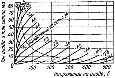

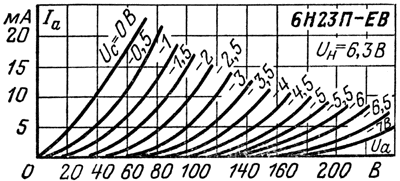

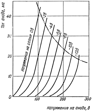

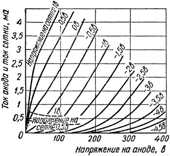

Here are some curves for 6N2P:
6N1P:
6N23P:
6N6P:
