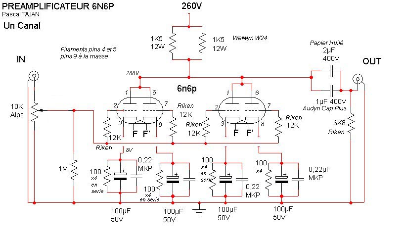

I found the website below which documents a 6N6P-based preamp design.
http://www.ptsoundlab.com/tubes/preamplis/6n6pcj/pre6n6pcj.htm

Hi Ruach
The traditional question when thinking about an preamp is the amount of gain needed.
The preamp is quite a heavy beast...it's dragging about 80ma per channel (My power amp produces 15W from the same current, but slightly higher voltage). The gain will be aprox half the gain of the 6N6P. Paralleling tubes will lower the output impedance, what is better for driving long cables. But paralleling also seems to 'kill' the sound (there was a recent thread on this). Other options to lower output impedance is the use of CF or variations... so, what do you need?

I have my doubts that paralleling tubes will always “kill” the sound (it doesn’t have to), but I do think that the low plate load resistance (~ equal to rp) in this design will make it a second-harmonic generator. This may please some, but it won’t be true to the music passing through it. If someone is hellbent on using these triodes (times 4), then the plate either needs a beefy CCS, a beefy choke, or bigger power resistors connected to a higher B+, wasting a lot of heat.

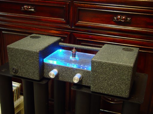

I have managed to modify my existing 5687 preamp to accept a 6N6P tube. It is based on a simple anode follower design, using a single piece of 5687 tube (see attached photo).
I had some help from James D. Thanks James.
The 6N6P is the most natural sounding tube that my 5687 preamp has ever worked with.
I have tried 6900, 7119, 7044, E182CC and a whole lot of various makes/brand of 5687 and the 6N6P (IMHO) has the nicest balance throughout the audio spectrum, and it does not have the aggression/thin sound of the 5687.
I am running it at Rp=10K, Vg= -5.5V to -6V, Va=160V, Ia=18mA
I tried running it at Rp=10K, Vg= -6V, Va=140V, Ia= 9 mA and there was a mid bass/lower mids bloatedness.
James suggested giving the 6N6P more juice and the 6N6P really sang after that.
Thanks to all who helped
