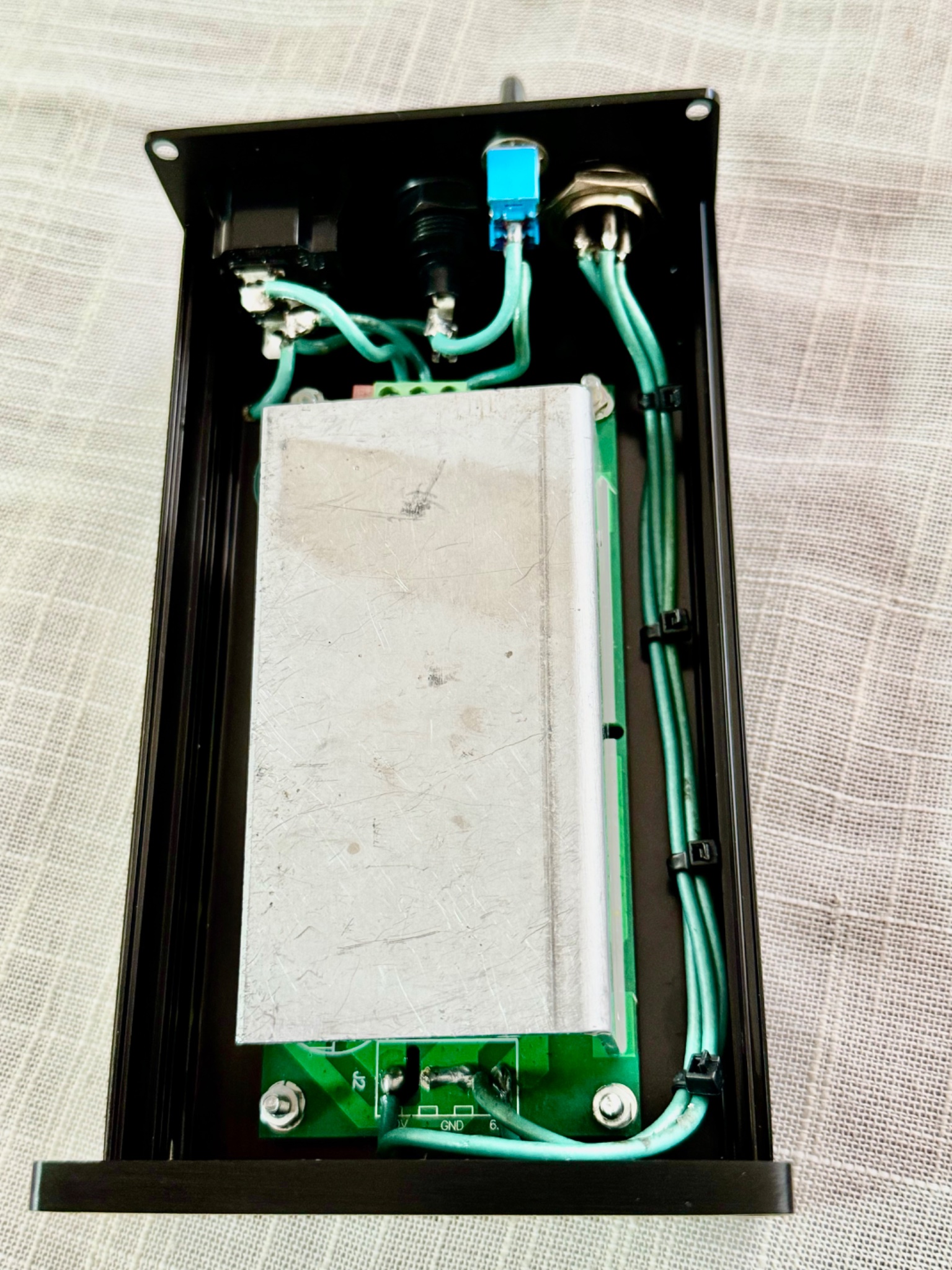

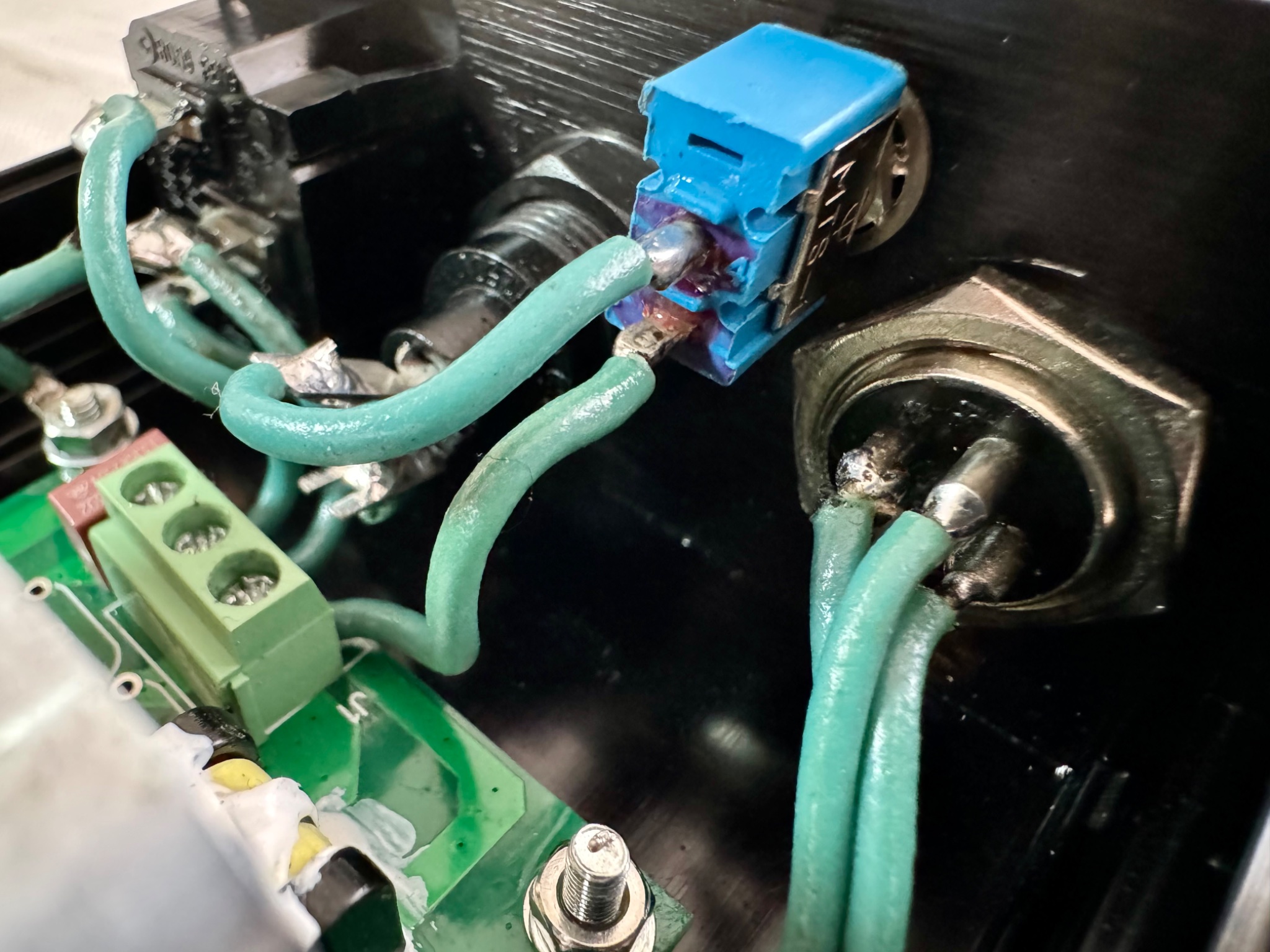

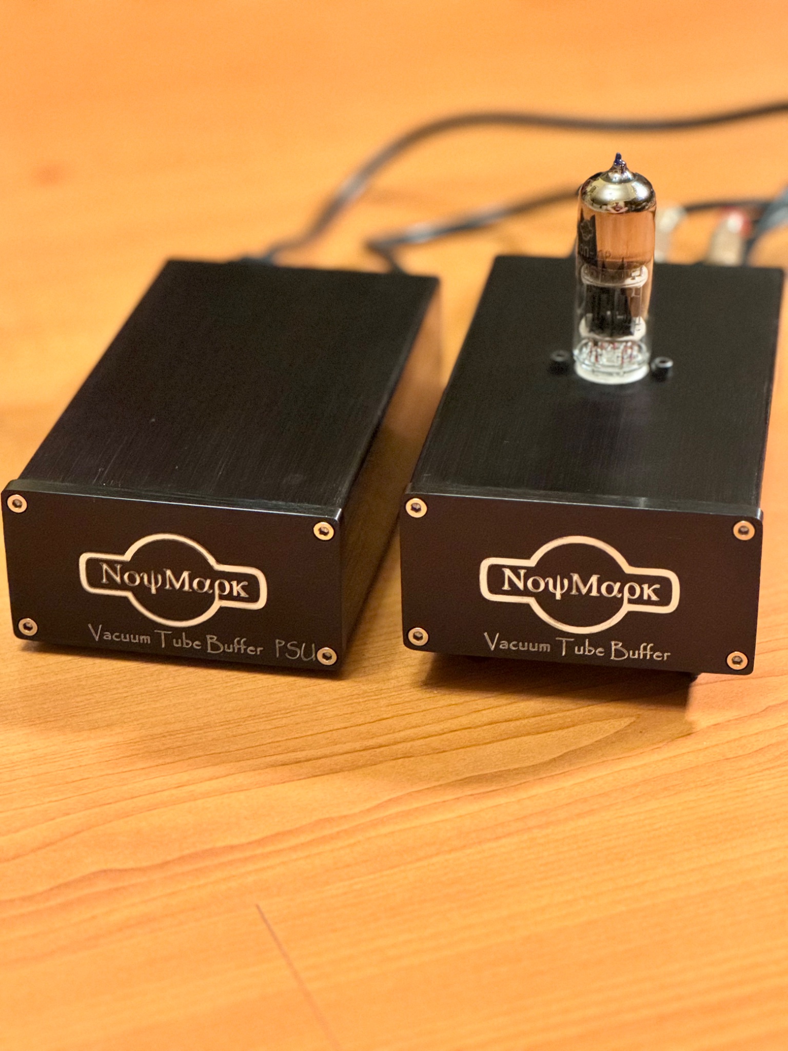

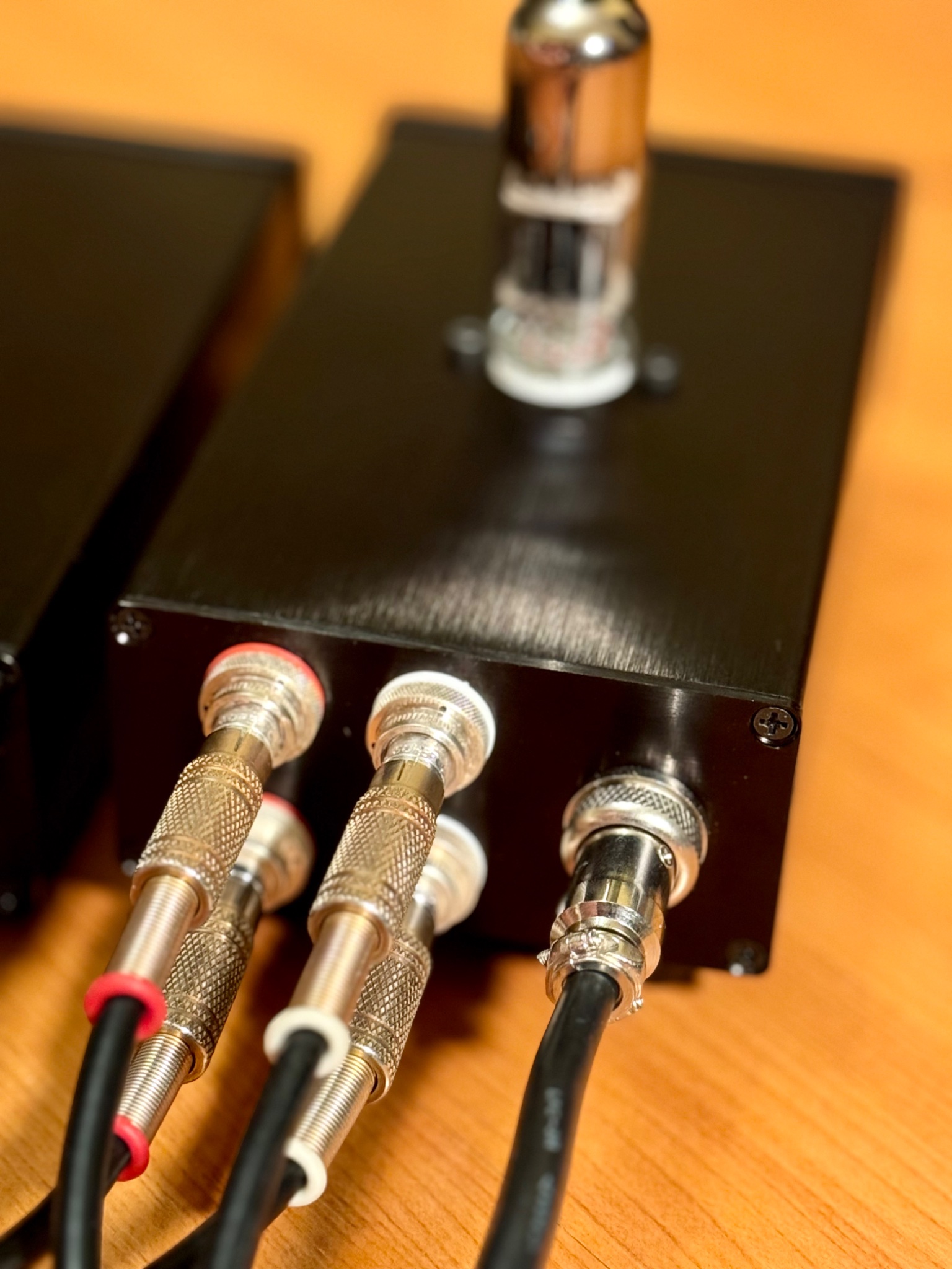

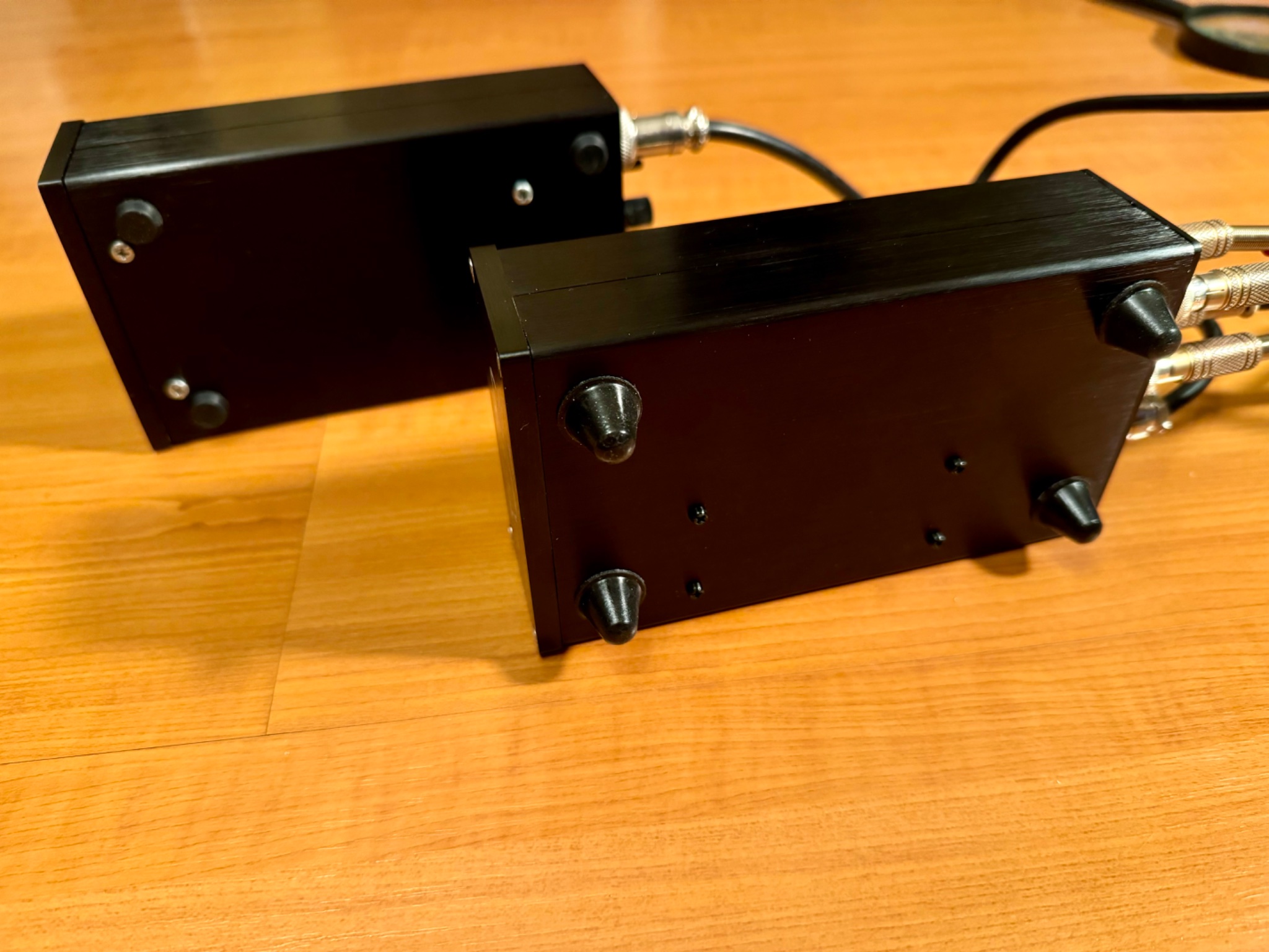

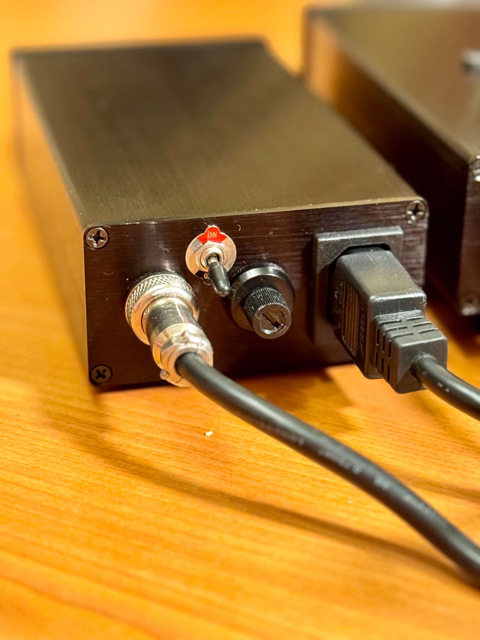

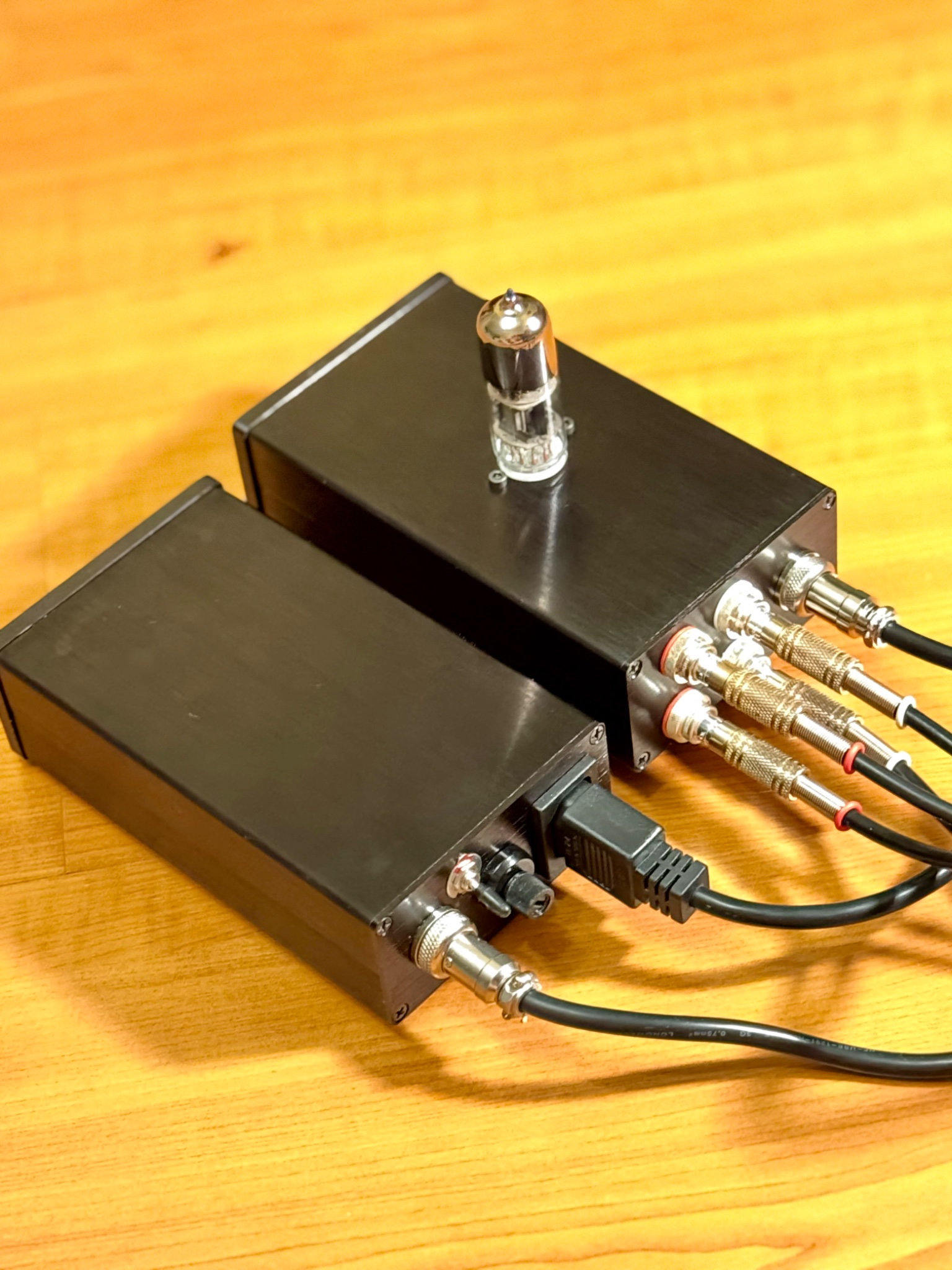

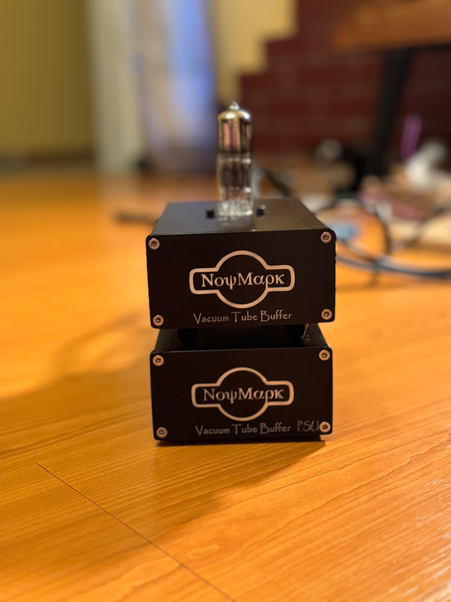

I built a zero gain tube buffer. Sounding awesome. It works with 6n30p-dr, 6n6p, ecc99, 6n1p types, 6922, 6n23p-ev. Output impedance is 230 Ohms with 6n30p-dr tube.

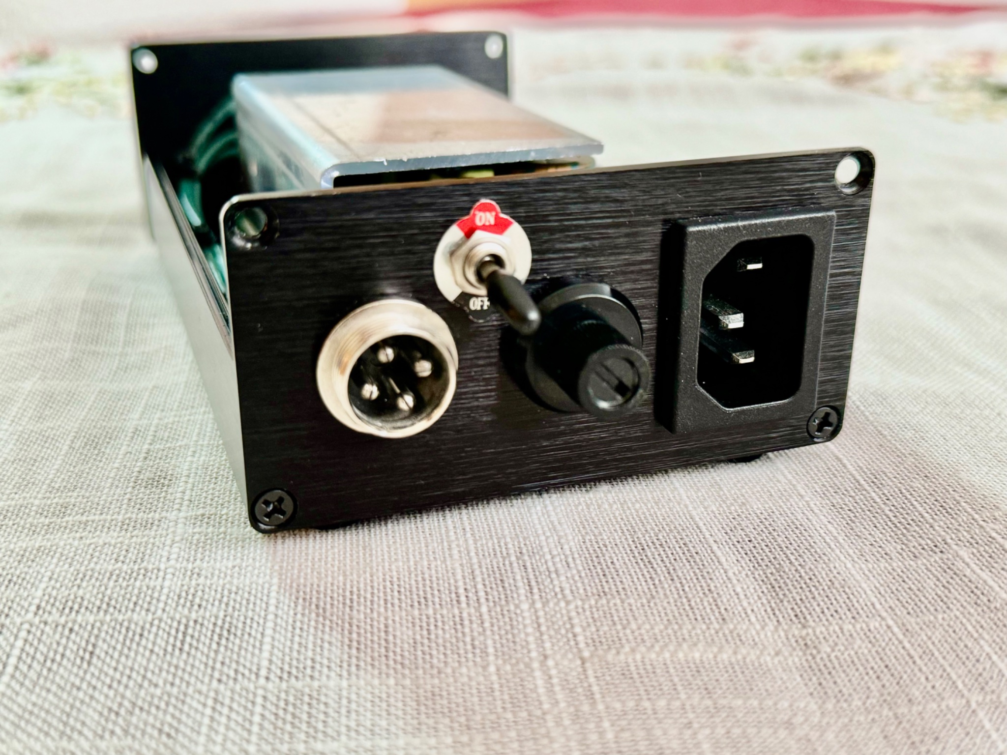

This is really good work! Congratulations on the construction choices that you made. The power cable from unit to unit is high on my list when I build this sort of project. I am curious about the AC in voltage-- 200 or 120?
Is 6H30 still available as recent production, or is it NOS? Wouldn't want something with a tube that is made out of unobtainium.

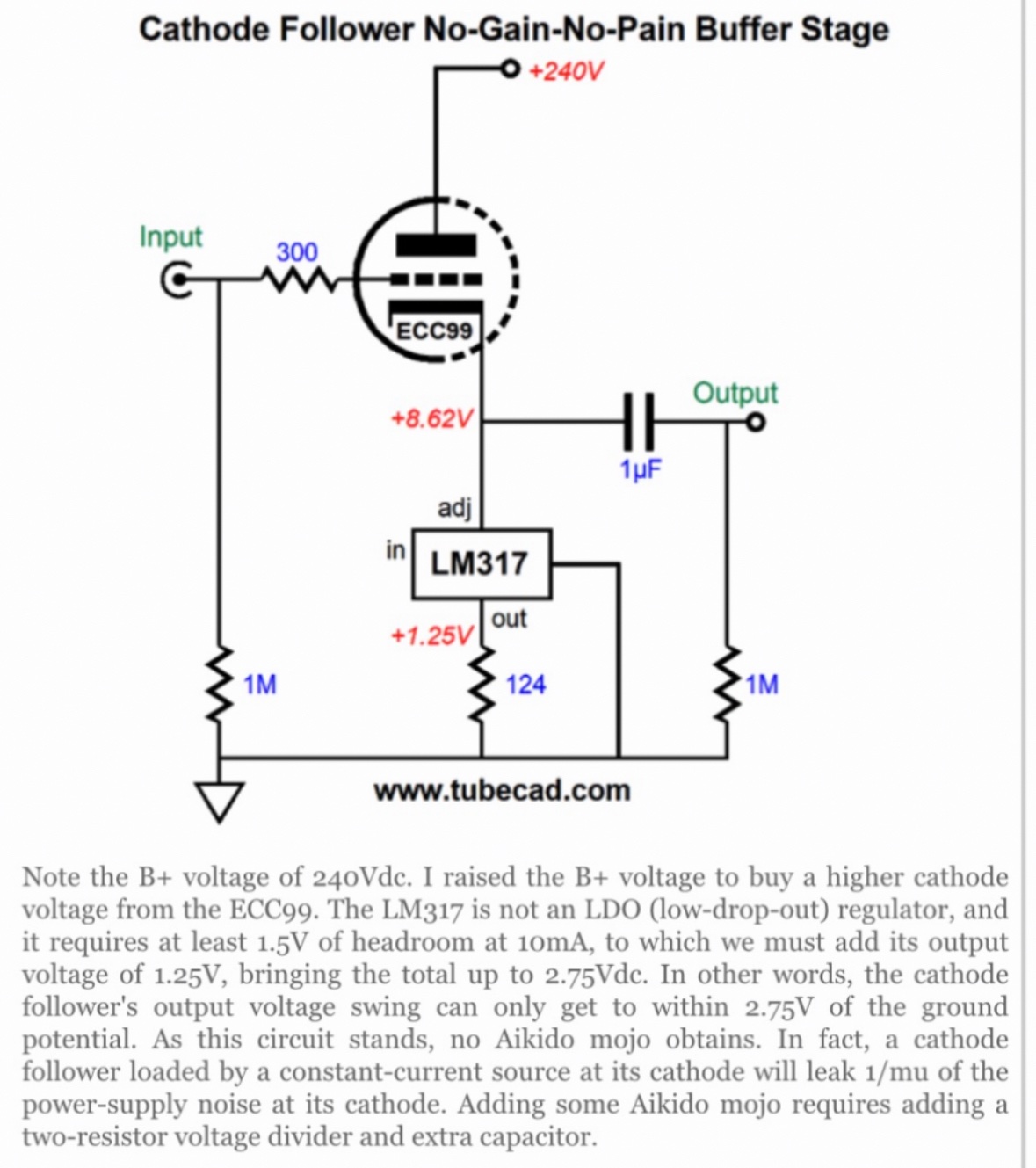

I used this schematic.Could you share a schematic please?
New production ones are not good. Use NOS, (Before 1990). I have them if you need.Is 6H30 still available as recent production, or is it NOS? Wouldn't want something with a tube that is made out of unobtainium.
This device accepts between 110-230V.This is really good work! Congratulations on the construction choices that you made. The power cable from unit to unit is high on my list when I build this sort of project. I am curious about the AC in voltage-- 200 or 120?
