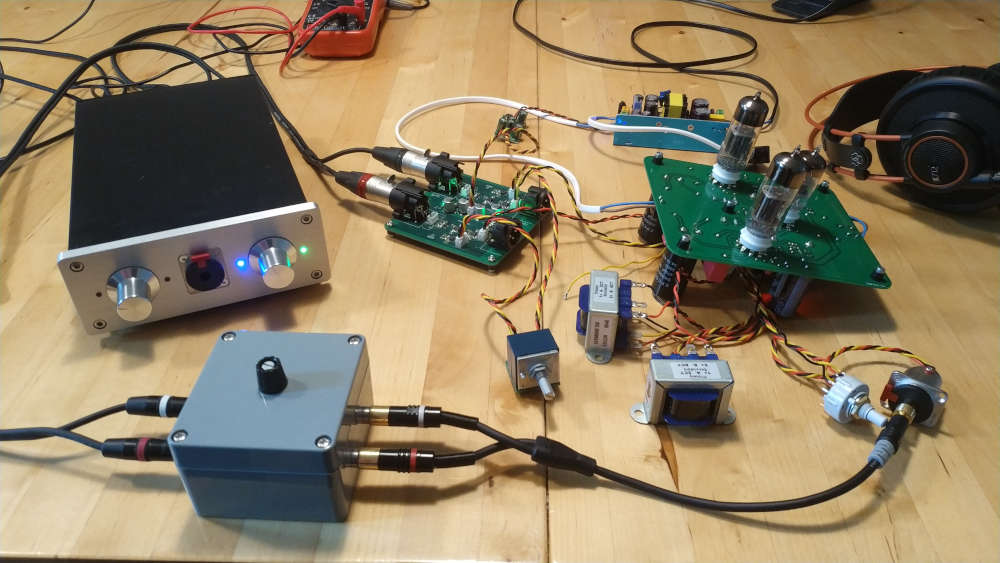

ok... no test fixture - I was too curious to test the amp. As you can see, the tubes are now on the PCB side without components, as I successfully mirrored the tube footprint Anyway, now I have no excuses why I can't put the amp in a proper housing...

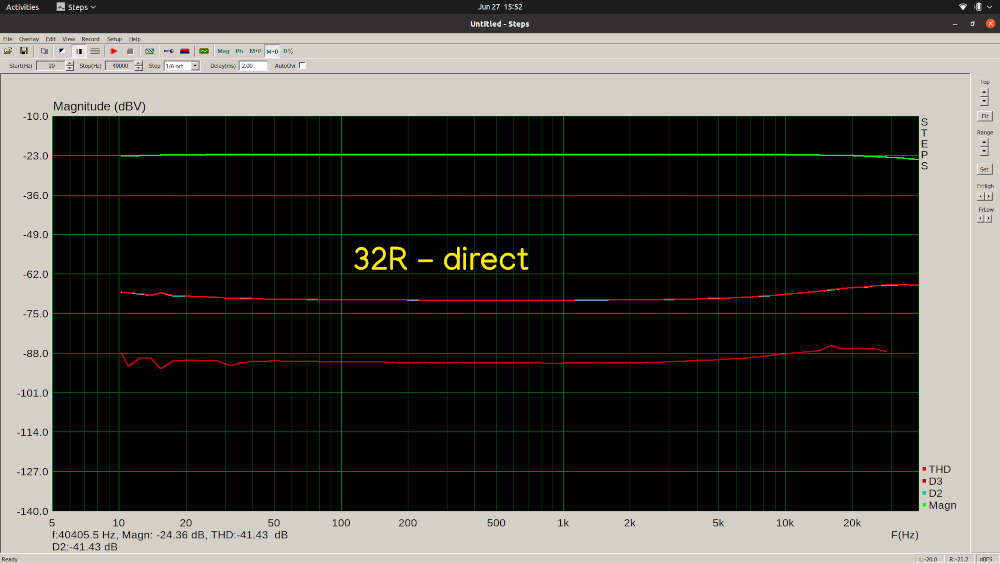

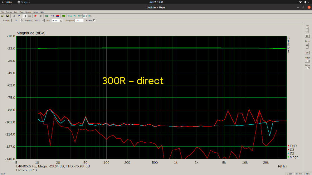

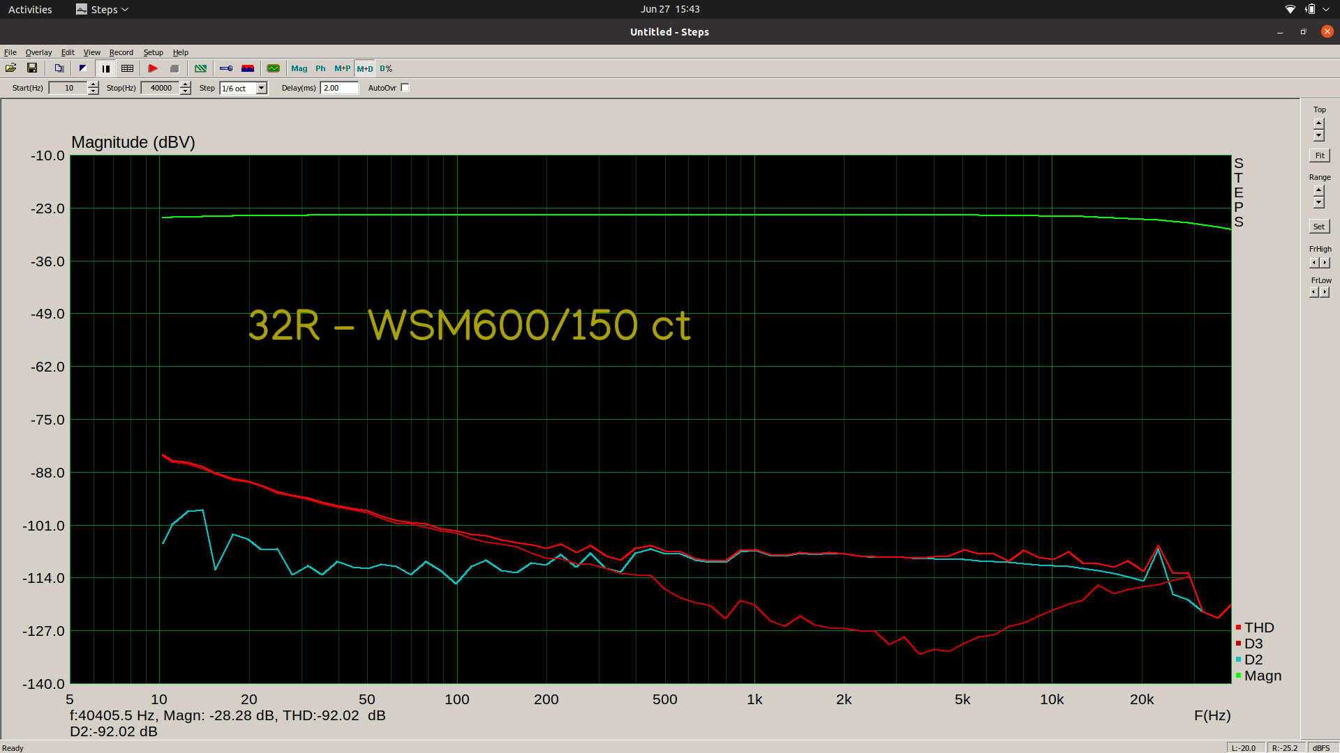

It works. No changes compared to the schematics. Honestly, it works quite nicely. No complaints about the sound from my side. It drives everything from 32R to 300R without transformer, but as you can see in the measurements, the transformer improves the THD significantly when using 32R headphones.
The spikes at "300R-direct" between 5k an 10k are some very high order harmonics; no clue if this are some measurement artefacts or interactions with the transformers. When listening, I noticed nothing in this spectral area.

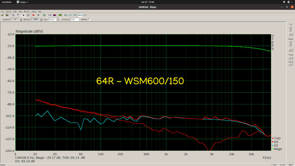

The slightly higher THD at the low frequencies comes from the preamp. I used NE5532 (whyever...). This circuit with LME4562 or OPA1612/1656 gives a flat THD...
The transformers are Edcor WSM600/150.
B+ ist at 210V currently. 190V-200V should be enough, but when turning down the voltage, the power supply also decreases the heater voltage.
Measured with my audio interface, PCM1794/OPA1656/OPA1632 output, OPA1612/PCM4220 input.
Compared with the HPA in my audio interface (LME49600/OPA1656), there is almost no difference; very nice stage, wide, open, clear; punchy, fast attack, clear mids, nice high tones. It's dead silent; no hum or hiss... I am honestly surprised about the results you can obtain with this relatively simple HPA.
Next task: make a nice power supply

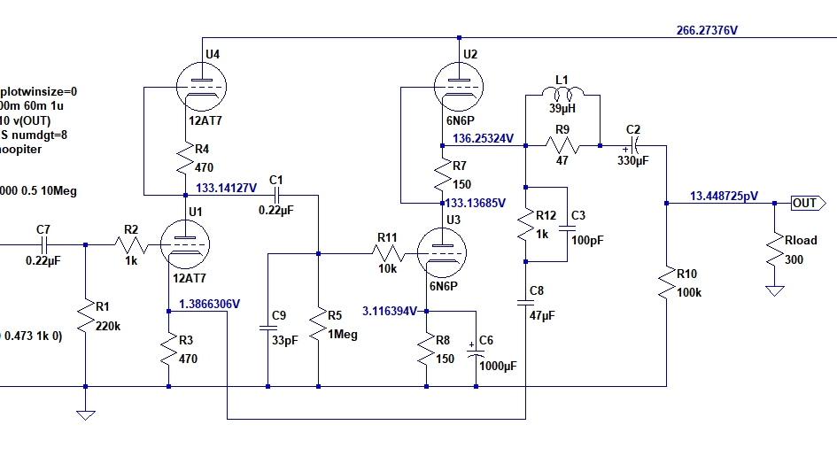

I have a sim of a Broskie Aikido headphone amp circuit (not one of his original circuits, but a circuit that would fit into one of his Aikido 9-Pin PCBs). It's a 12AU7 totem-pole DC-coupled into a 6N6P ALCF. The THD figures are very similar to those of the previous
12AT7 totem-pole/6N6P SRPP with NFB circuit.
- The THD of both circuits is about the same, but the Aikido/ALCF does it without NFB.
- However, the ALCF/Aikido completely gives up into 32 ohms, while the SRPP with NFB soldiers on, but with higher THD (1V rms out = 0.7% THD).
The big difference is that the NFB allows the SRPP to drive 32 ohm cans, while the zero-NFB circuit clips prematurely.

Simulation seems to think it will work spectacularly well. Well below 0.01% THD. However, it's a really inefficient way to get 3X gain. Two 6N6P heaters will consume 10W of electrical power, plus two 12AT7 heaters consume almost 4W, so there's 14W of power you're paying for just to light up the tubes. Then the plate supply is consuming another 14W or so.
The large electrolytic cap on the output could be a problem. I'd reduce the value of R10 to 22k or maybe 33k, to speed up the charging of C2 (the output cap). Otherwise there may be a lot of DC at the output on startup, while C2 charges up.
You could also add a pair of 15V zener diodes in anti-phase from output to ground, to prevent output voltage from going beyond 15V. That could save solid-state devices downstream and wouldn't affect performance either into headphones or a power amp.
But it looks like it could work really well as a line stage, yes.

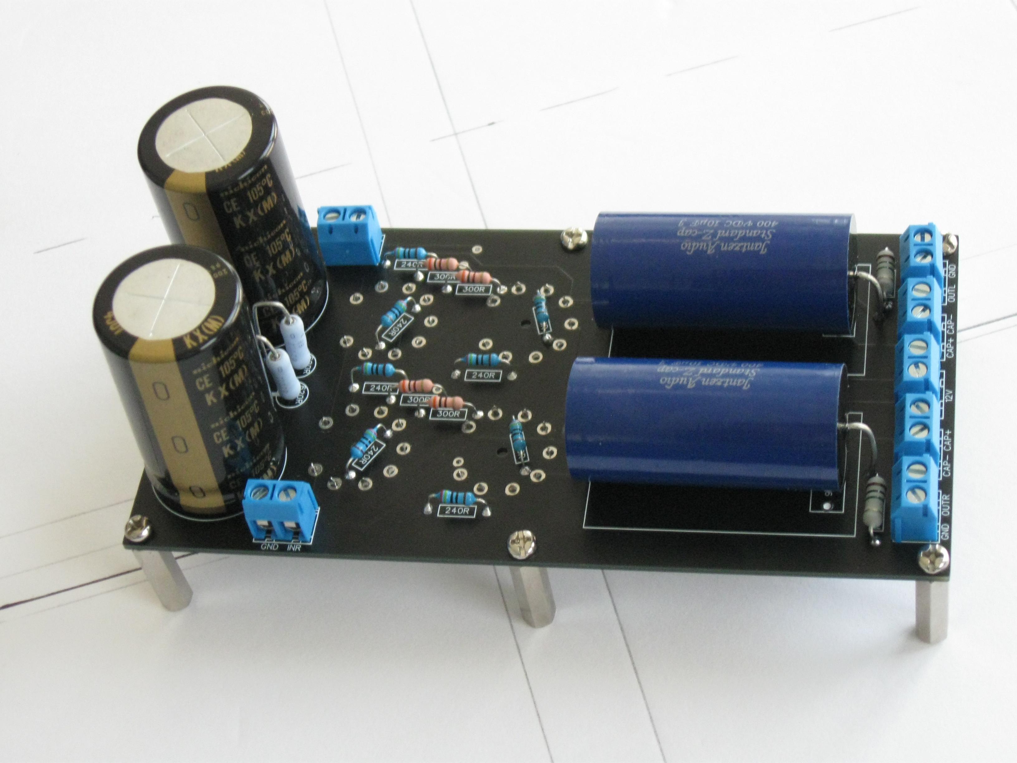

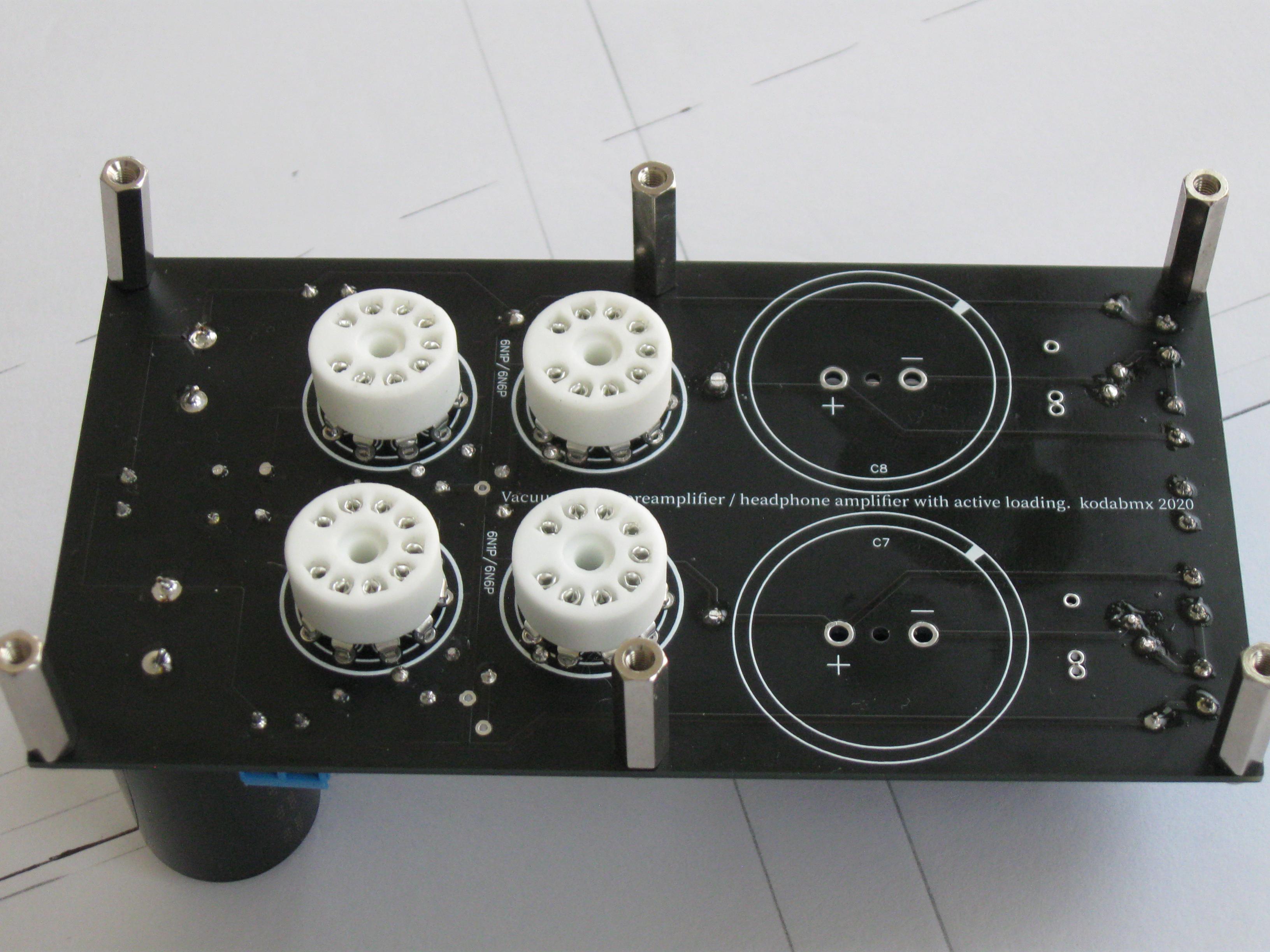

I have started building a line stage. I haven't soldered the tube sockets yet still need to use the PCB to mark the chassis for the sockets. Waiting for power supply and chassis.
Nice kit Koda, Thanks!
