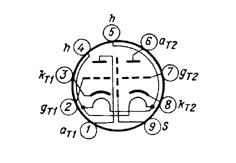

The 6N2P has slightly lower plate resistance, and this will effect it's output impedance and therefore the frequency response when used in RIAA or other active filter stages when used in some circuits expecting to see a 12AX7.

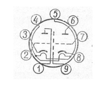

I’m wondering how best to adapt a 12ax7 riaa stage for use with 6N2P.

The answer is different depending on whether you are using passive EQ or EQ in a feedback loop.
For passive you will generally need to compensate for the change in rp unless it is very small and the network is insensitive to small variations in source impedance.
For feedback based EQ the situation will depend on the effect the substitution has on the overall closed loop gain, some minor changes to the design may address or adjustments to the feedback network may be required.

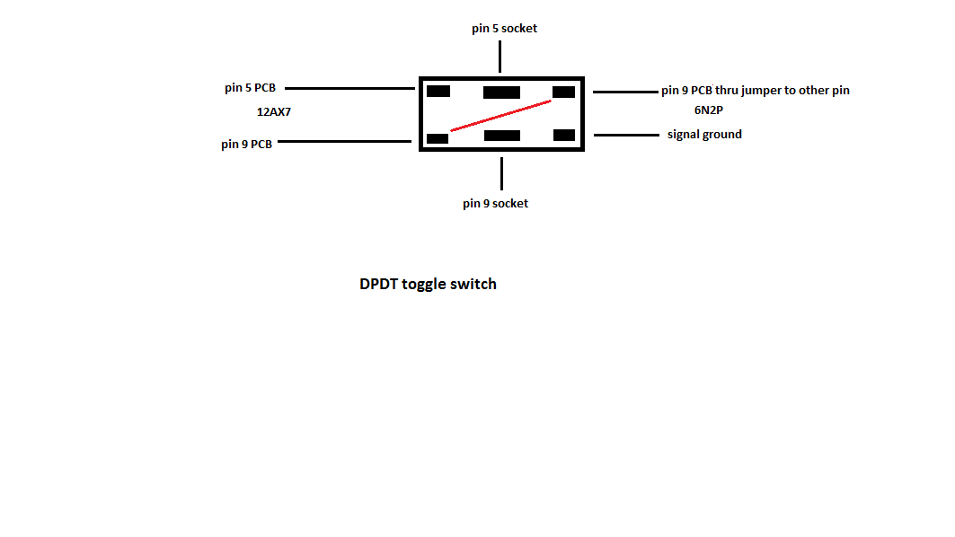

I have been using 6n2p-ev in my Hagerman Cornet2 phono stage off and on for a few years. I put switches in so I could go back forth between the 6n2p-ev and 12ax7. I tried the adapters but they were noisy, maybe because you can't connect the shield to ground.
I am still working on optimal circuit changes for the 6n2p-ev, but I have to go by my ears.
Hi, I like the idea of being able to simply switch between the 12ax7 or 6N2P-EV
Can you please specify the type of switch and spec that would be suitable and a diagram as to how to wire it?
Will the switch in circuit affect the sound?
Thanks 🙂
This is what I did, a quality switch will not affect the sound, it is quieter than using an adapter. The red line is a jumper. Needless to say pins 5 and 9 on the socket must be disconnected from the PCB first.
Do this at your own risk, a wiring mistake could be dangerous. I was a CET and have had training.
