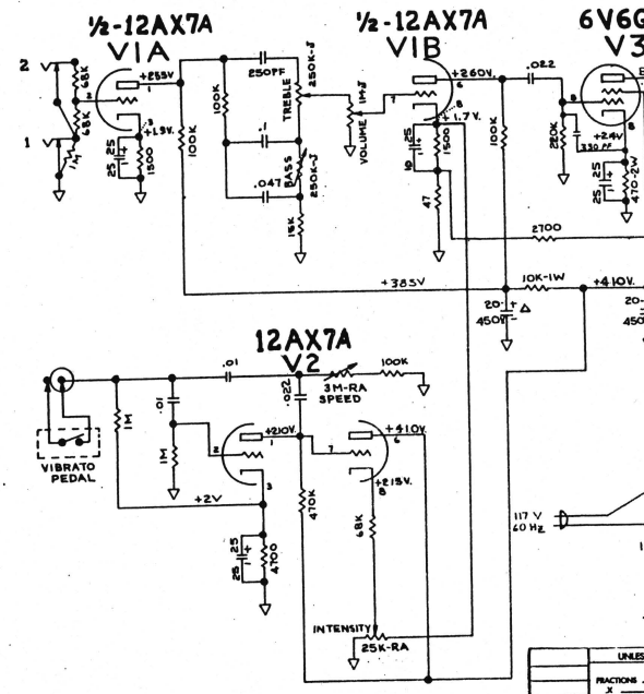

6n2p as oscillator
Can i replace a 2n6p tube instead of 12ax7 of vibrato ?

I have knowledge of the heater wiring, I was concerned that the 2n6p would not withstand the direct 410v as I never saw that direct voltage on that tube

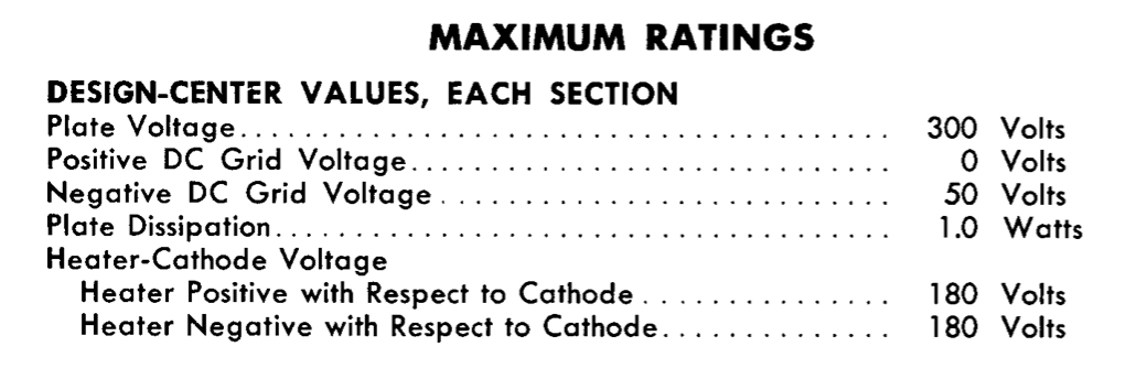

The voltages between the cathodes and the anodes of V2 in the schematic are 208 V (left side section) and 197 V (right side section). Both are well within the limits of the 6N2P and the 12AX7, so that's no problem, like Depanatoru already wrote.
But maybe the maximum heater to cathode voltage is a problem. For the 12AX7 that maximum is 180 V. For the 6N2P that maximum is only 100 V.
The cathode of the right side triode sits at 213 V, so already over 180 V. But maybe the filament supply is lifted up in this amplifier (or, if not, maybe the designers knew that a 12AX7 can withstand this). But I would not count on a 6N2P being able to withstand this.
