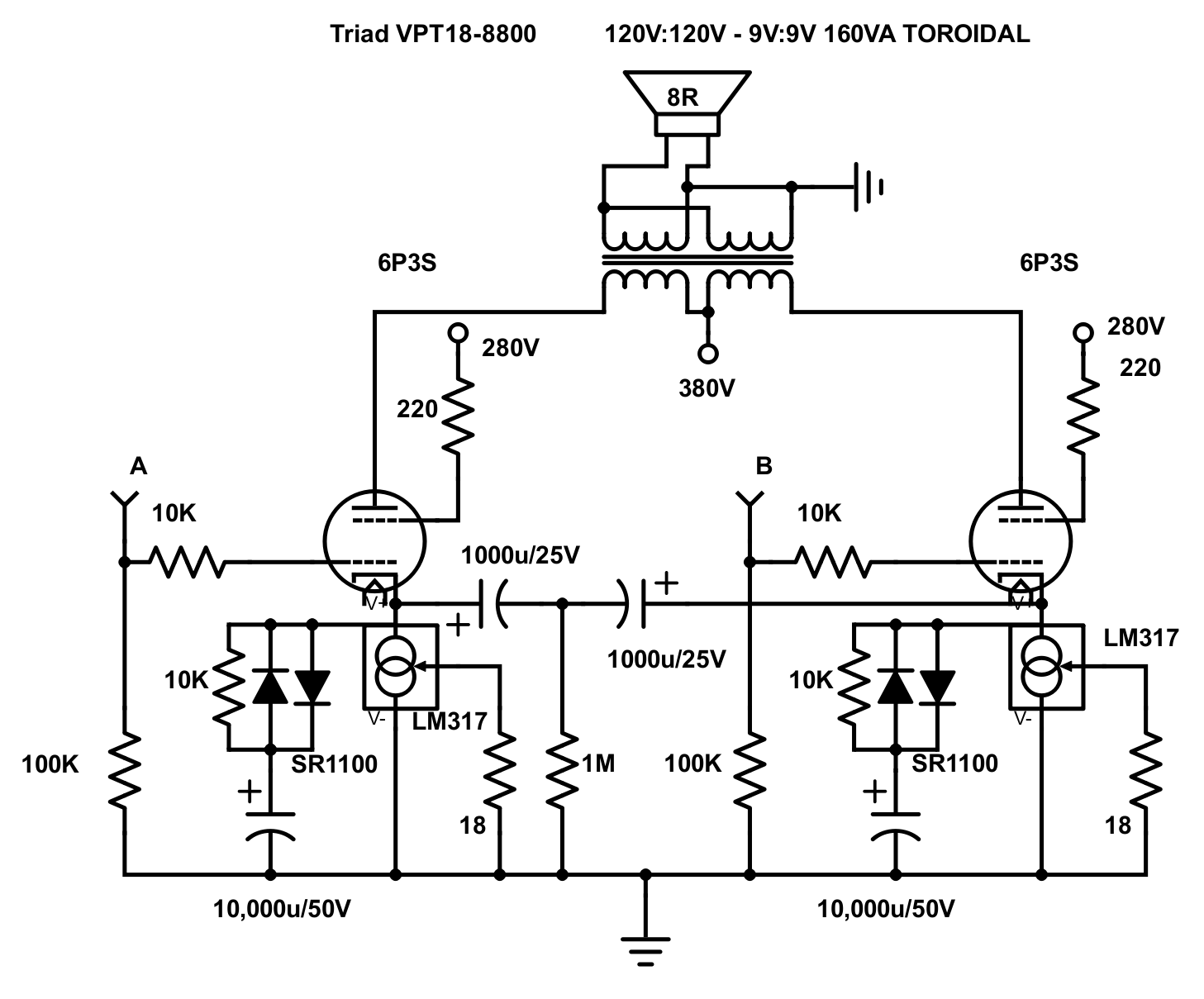

I drove it with a 100w SS amp fed through a 150 ohm resistor to primary.
also tested with 6922 with 150v B+, this is where the DC bias balance is critical.

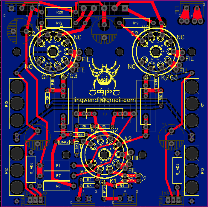

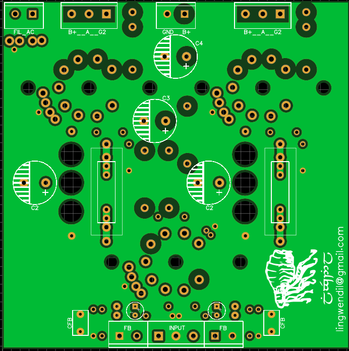

Alright, worked on moving as many signal traces to the top of the board as I could (based off of GoatGuy's suggestion in another thread, as always his advice makes sense, especially for the low-level signal at the input/splitter) and started cleaning things up a bit. Also added some extra clearance around the higher voltage pins and supply connections. Starting to look close to final.

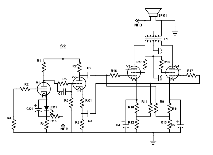

Thanks to Digi-key Scheme-it (thanks for the recommendation, Kodabmx!) I've got a presentable (if busy) schematic. This is not fully annotated with all the options (and I can't find a suitable outline for the LM317 in the listed library that isn't really funky) but is more or less complete, and the parts values should (emphasis on should) match the board as of now. As shown, it is set up for the "step network" bias that I like to use.
You may notice a similarity to my Flea Amplifier (along with John Broskies "Unexpectedly good" amp, and some of Morgan Jones' stuff too) and you are very right , as they are much the same with added features, and a swap to pentode outputs. The cathode circuitry looks redundant, and that's because it is, its all on the schematic to make the board easier to understand 🙂
The board assumes an offboard power supply of your choice (my mosfet board would be useful here🙂) however it features a basic CRC filter on board for the input/splitter stage to help out if needed, and has provision for two separate connections for two separate supply voltages to feed the input/splitter and output tubes separately if so desired.
Basically, the following options will be supported by the board-
For the input stage-
-Capacitor bypassed resistor, populate CK1, and a resistor will go in the LED1 postion, standing vertically, jumper out R4, leave R15 open, no global negative feedback
--Same as above, with added R4/R15 resistor combination for negative feedback
-LED bias, populate LED1 position, leave off the CK1 capacitor position, jumper out R4, leave R15 open, no global negative feedback
-Unbypassed cathode resistor, jumper out either CK1 or LED1, populate R4, do not populate R15 no global negative feedback
-Same as above, with added R15 for negative feedback (this is my preferred use!)

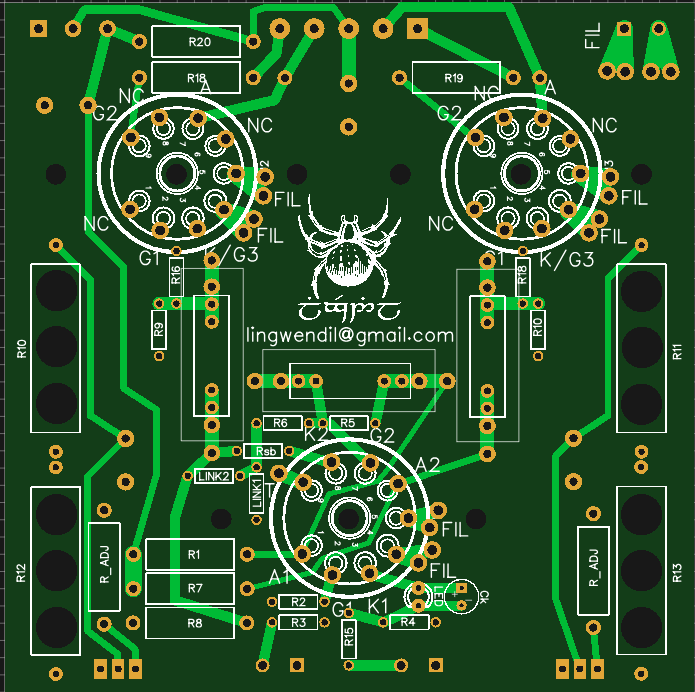

For the phase splitter-
-Direct coupled grid to preceding stage, populate RSB cathode resistor with wire link, do not populate C1 or R6. Install wire link (or small value grid stopper) for R5.
-Self biased or "floating" concertina, populate C1, RSB, R6, populate wire link LINK2 between R6 and RSB/R8 junction. Do not populate R5 or LINK1.
-Step-network bias, populate C1,R5,R6, install wire link in RSB position. Install wire link in LINK1 position. Do not populate LINK2. (this is my preferred use!)
For the output stage cathodes-
-Standard cathode bias, populate R10, R11, C4, C5. Install wire link in R12 and R13 positions. Do not populate LM317, or R_ADJ.
-Garter bias, populate R10, R11, R12, R14, C4, C5. Do not populate LM317, or R_ADJ. (this is my preferred use!)
-LM317 CCS cathode bias, populate C4, C5, LM317, and R_ADJ. Install wire link for R12, R13.
For the output stage screens-
-Triode mode, connect R18, R19 to the anode of the respective tube (additional pads are provided) rather than to the output connector. populate the output terminal with a 3POS terminal (or a 5POS for later experimentation)
-Ultralinear mode, populate R18, R19 as shown on the board. Populate output terminal block with 5POS terminal. Connect off-board as shown on chosen transformer wiring diagram.
-Pentode mode, Connect as above for ultralinear mode, and bring leads from output terminal to external (adjustable, if possible) power supply. (this is my preferred use!)

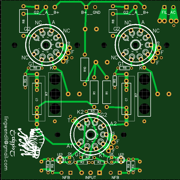

I wanted to go for an all-noval design this time, so went with the wonderful and affordable 6N2P for the front end, and went with rather boring but effective values to set it up.
I am following your progress with great interest. Especialy like your approach to enable multiple heater voltages. One question - do you actually need the amplification factor of a 6n2p in the first tube? I am interested in trying other tubes in that position also.
Well, I like it there to give headroom for global feedback, and the cathode is not bypassed in order to increase linearity with the side effect of lowering overall gain. At my operating point each grid needs 16 volts peak for full output, but if going without global feedback and either bypassing the resistor or using an LED and running something like the EL84 with lower drive requirements you can easily use the 6N1P, 6DJ8, 12AT7, or even a 6CG7 if your source is hot enough. That's one of the main reasons that I'm working different options to the PCB, to give the ability to make something very nice with many different possible tube types one may have on hand.
If I'm not mistaken the 6N2P gives a gain of ~60 or so the way I've implemented it.

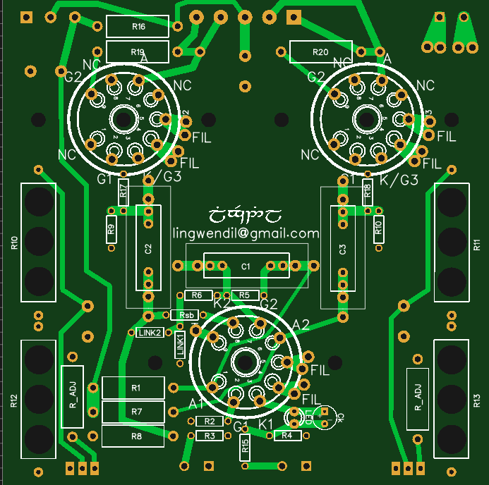

In particular, I have two ideas I would like to build-
EL84 triode connected version with a 6CG7 front end, likely with LED bias and no overall negative feedback. Should be nice for hot sources and efficient speakers 🙂
6P43P-E triode connected, with 6N1P front end, a smidge of global feedback, overall supply voltage of ~250 volts, should be good for 7~8 watts or so.
I also build a bunch of regulated G2 pentode connected or UL mode EL84 builds from time to time, so that's also a need for this board. Being able to accommodate a customer's needs/requirements with a single board is handy when you build a bunch each year.

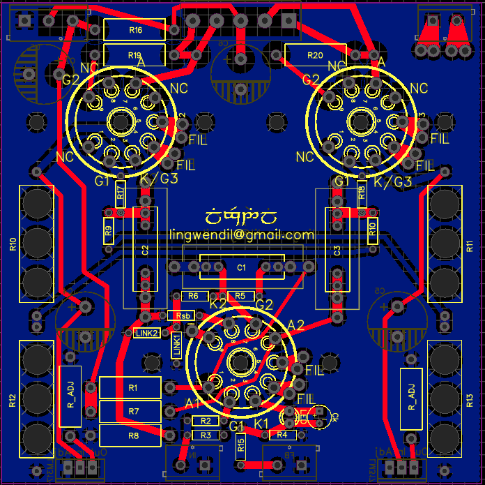

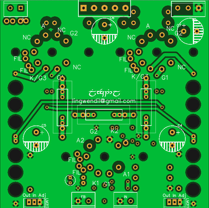

Well, I figured this board needs a name. So, while trying to fall asleep last night, thinking myself into a stupor, the name "Spider" came to me. I feel it fits the idea of the board, many legs and possibilities, so, "Spider" it is. It fits the theme with the Flea amplifier I think.
The Spider logo silkscreened to the PCB is from Openclipart.org, and has an unlimited public/commercial use license.
I'm thinking of including a feedback capacitor on the board, but just unsure of what lead spacing to use. There seem to be plenty of quality film caps in the pF range with 5mm lead spacing, so I think that's what I'll do, unless there are any other suggestions. I'll likely incorporate this into the noval SE flea board as well.

Please add mounting holes for M3 standoffs. Not all tube sockets have "wings" and no one building this device should be able to even attempt to use loose boards.
As shown there are M3 mounting holes on either side of each socket currently, in order to work with 12mm/1/2" standoffs or spacers... I placed them near to the sockets to reduce strain for those that may wish to swap tubes frequently. Are you suggesting a set of additional holes? I avoided them in the outside corners to reduce board flex and fatigue of solder joints at the sockets.
To keep in line with the SE board, I added a feedback compensation cap outline, assuming a 5mm box MKS type or similar. Otherwise I think it's done.

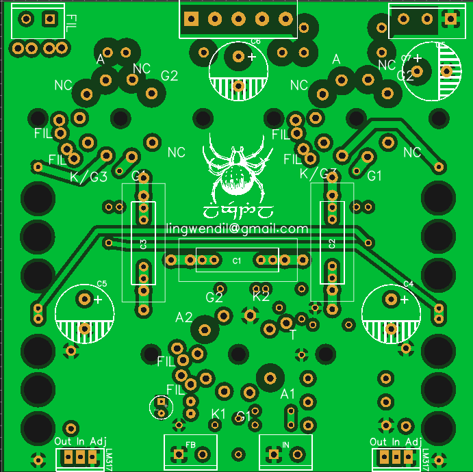

The board design looks good, and I like the flexibilty to easily use different heater voltages for the power and voltage amp tubes, without board surgery. (I happen to have a bunch of PL84 tubes (oddly numbered EL86s with 15 V heaters).
One suggestion, since you have plenty of space, is to allow for physically larger coupling capacitors (like fat Clarity Caps), and move them away a bit from the big (hot) cathode resistors.
Screen voltage is about ~225, plate voltage about ~310, cathode voltage ~32 (across both garter bias resistors, so 16 volts x2) so actual operating parameters are close to 190 screen, 280 plate actual, -16 g1. Not too far off, and you get a little more potential power with a smidge lower (in theory) distortion. You could run them hotter at idle but I see no need to, I like them to last and have efficient speakers that are happy with a smaller class A area.
I've noticed these really don't like the screen voltage to be too high once you run the plate higher- they will get towards red plate territory above 300 volts screen, even if you run the grid quite negative.
Also- the Russian 6P43P-E doesn't like these points either, it wants twice the negative bias and maybe ~70% of the same screen voltage, unless you bring the plate voltage below 280 or so. Otherwise very promising tube.
For the caps, get me lead spacing dimensions and I'll see about making a couple pads/holes to mount them, it shouldn't be too tricky to pull a couple traces further out... The assumption is that the caps will be under the board, and the bigger resistors would be on top, so I don't think heat will be too much of a concern in most instances. I haven't played with them boards much lately, but I think they are nearly done.
Thanks for the approximate HV targets. I think my stash will provide.
Regarding lead spacings; I don’t have any specific coupling caps in mind, so just provide multiple options as much as your PC board real estate could accomodate. I have some great Jantzen Superior Z caps that measure 17x43 mm. I will build your amp using those after convincing myself it could benefit from high quality parts.

PCB design is pretty much done, I want to have some made and tested before I declare it "done" enough to give out files (or sell boards) for now. I actually think I may do a PCB order this next week, as I have several designs ready to order, more or less. I need to redraw the schematic, too, my handwriting sucks 🙂
Any other questions or suggestions let me know, I'm going to try and be more active here again, I have several projects that really need finished 🙁
