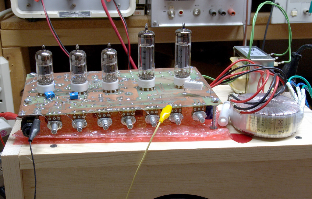

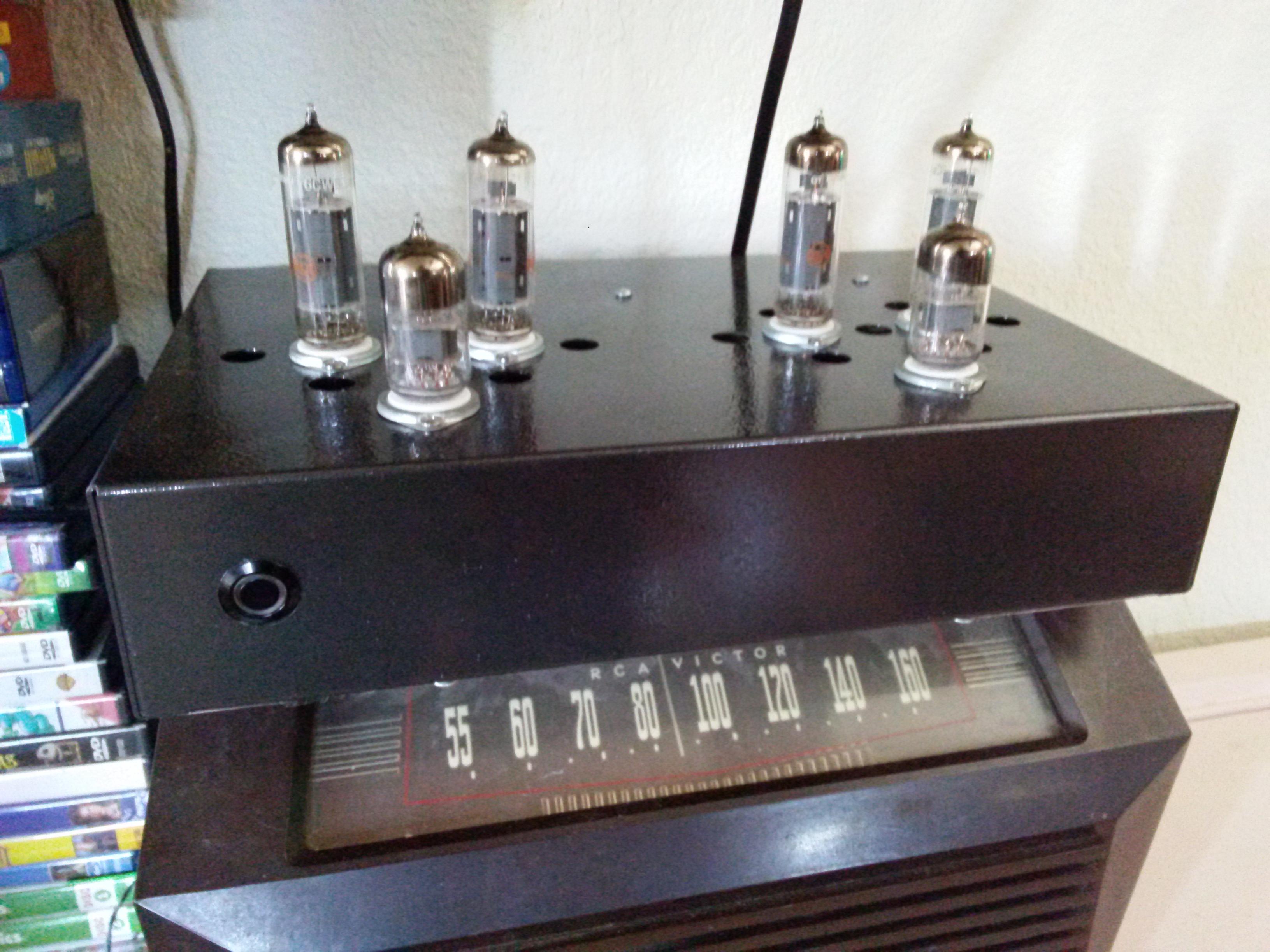

Well, since this has been in daily use for the last couple months I figured it was time to declare it a success, and post it up to show off 😎

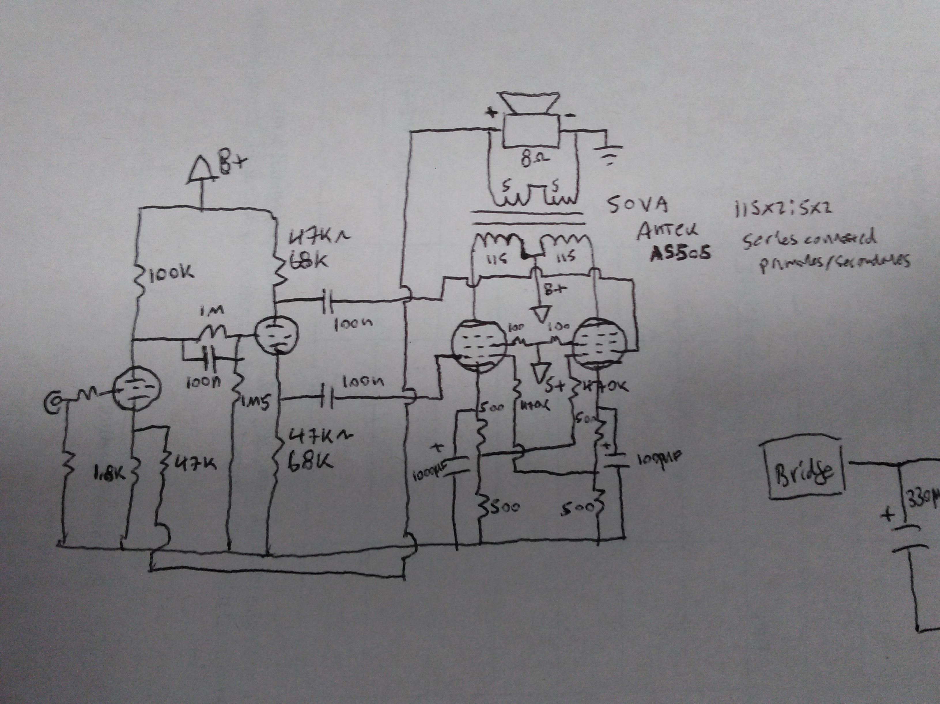

Its a variation of my favorite topology, the unbypassed cathode voltage amp, step-network biased concertina, and garter bias. Very similar to my flea amplifier, with a few tweaks. I wanted to go for an all-noval design this time, so went with the wonderful and affordable 6N2P for the front end, and went with rather boring but effective values to set it up. Unbypassed cathode lowers gain and distortion, and the distortion there is will end up primarily 2H from past experimentation with this set of operating points. A little feedback to the cathode is a nice way to tighten everything up 😉
The output stage is where things get a little unusual. For the first time in a few years, I'm actually going with a pentode output stage😱. Since garter bias works so well I decided to try it out on here, and it works pretty damn well, even on pentodes that are reasonably matched. I went with the 6CW5/EL86 for this use, with a nod to trying out the 6P43P-E later on (I have 21 of them, may as well 😉 )
I went with the Antek AS-0505 power toroid for my output transformers, which works out to 4232 ohms, with both primaries and secondaries respectively in series (for the relevant maths, 115+115=230, 230/10=23, 23x23=529, 529x8 ohms=4232 ohms) which should give pretty good linearity for these affordable and lovely, overlooked tubes. I'm running them a little conservatively at 32mA per cathode, for about 9.2 watts of combined plate/screen dissipation, but will likely increase this soon now that I know this setup works well. Of the tubes on hand, I find the Polam EL86 to be particularly nice.
Interesting to note, that if you connected the secondaries in parallel, and used 4 ohm speakers, these transformers would work well for EL84 or 6V6/6P1P as well, showing a primary impedance of 8464 ohms. Some minor changes to the screen supply would be needed to give a higher range of voltage. Easy, add another zener in the string 🙂
For power, an Antek AS-1T230 - 100VA toroid gets rectified through a 1N4007 bridge, fed to a pair of IRF820 mosfet filters, one of which uses a string of five 1N5262 50 volt zeners, with a pot/resistor in series feedig the mosfet gate for adjustment range. This gives an effective way of setting the screen voltage. The output tubes get their plate supply straight from the first reservoir cap, and the additional unregulated but smoothed mosfet filter feeds the preamp stage.
All resistors are basic type stuff, concertina resistors matched, and the garter resistors are 10W non-inductive bulk lot wirewounds, selected to within a couple ohms of eachother. All coupling caps are siemens poly films. Most everything I had onhand other than a few power caps, but it's all basic grade stuff for the most part. Used some leftover hammered texture paint for the affordable 12x8x2.5" BUD industries aluminum chassis. I went ahead and sprung for a fancy swooky purple power button LED this time, though 🙂
How does it sound? Well, very, very nice, if I do say 😉
I'm not one for audiphool jargon, but compared to my flea amplifier it is noticeably different, owing to that pentode sound. Overall it is much more powerful, of course, but it's super clean and accurate, not too clinical or sterile. Sounds like a nice EL84 pentode amp, but with a little more mojo that one seems to find with low impedance tubes. This thing makes thunderous bass, and has a wonderful midrange/high end. Nice general-use amplifier.
Total iron cost, $34.50 power, $17.50x2 for output, plus $13.50 shipping, makes for $83 total. Not bad 😎

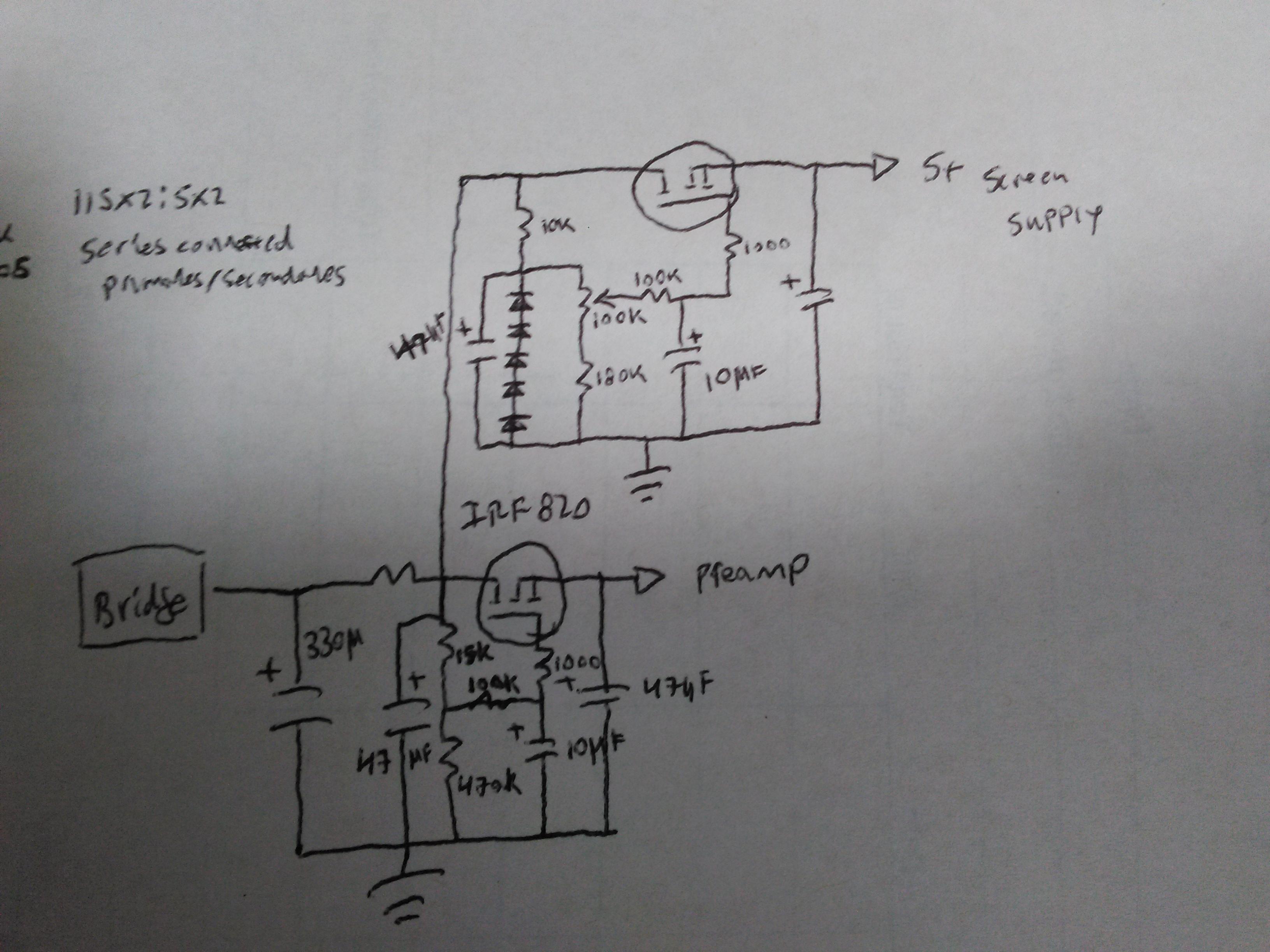

Pardon the terrible picture and sloppy schematics!

Novice question about your schematic:
What is the purpose of the paralleled RC network on the grid input to the 2nd triode stage?
Is it merely to form a potential divider with the grid leak resistor, I.e. to lose some voltage from the first stage?

mondogerator,
The RC network is a voltage divider that drops the DC voltage by half to get the second tridode where it needs to be DC wise to act as a concertina. The capacitor shunts the AC and allows it to bypass the upper resistor on the voltage divider to restore all of the AC gain of the first stage.
Sorry, yes. It is to reduce the DC voltage at the second triode grid, while preserving the AC signal level.
In this particular case, the first triode is set up to have ~60-65% of the supply voltage at its' plate, and the divider brings this down to approximately 25% of the supply voltage in order to bias the cathodyne at a good operating point.
Also, a little error, the 1M and 1M5 resistors should be switched on the schematic.

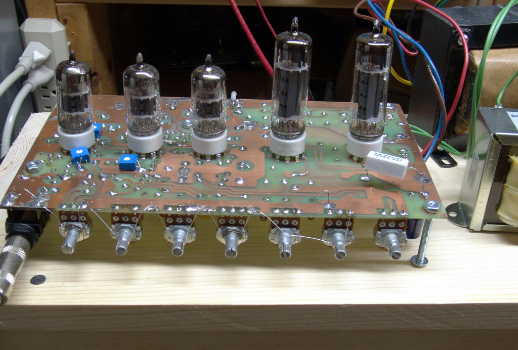

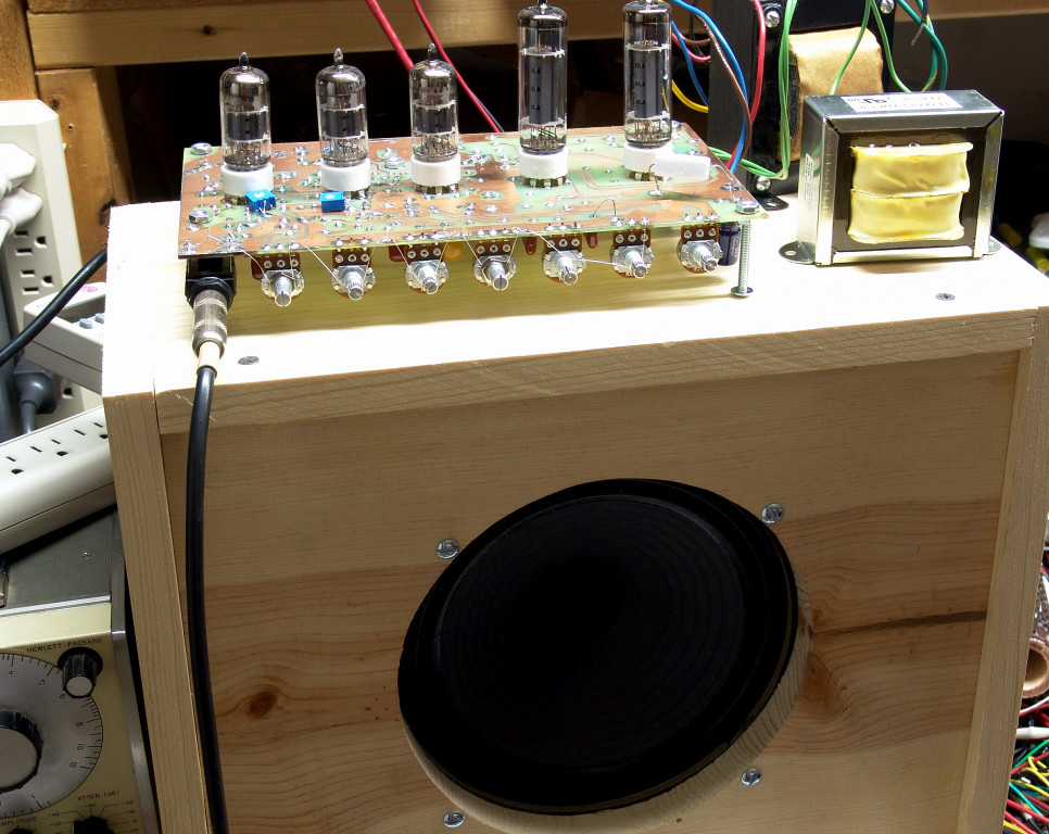

I also made a similar amp. It was a guitar amp, but the output stage was tested for power and frequency response before the preamp stage was built. I torture my HiFi amps by playing guitar through them, and likewise I test the amp stage of my guitar amps by playing music through them. This one sounded quite nice in glorious mono and the bass was surprisingly deep and solid considering the use of a similar Antek toroid for the OPT.
The amp ran 45B5 / UL84 output tubes. These are 6CW5's with a 45 volt 100 mA heater. The power supply used a Triad 100 VA isolation transformer. B+ was derived from a voltage doubler and ran about 340 volts. The screen supply was derived from a FW bridge on the same secondary for about 170 volts. The OPT was an AN-509 with both 9 volt secondaries wired in parallel providing a 5200 ohm load. Power at clipping was 22 watts, and the THD was around 3% at 20 watts. A bit more power could be had with a lower load impedance, but I have the Antek already so I tried it. I also tested the amp with a real OPT rated at 3300 ohms. It made 26 watts at clip and under 2% THD at 20 watts......but broke the $100 budget for the amp.
The 6CW5 is pretty good little tube and I have squeezed 30 watts from a pair in my SPP amp boards.

Main supply voltage is around ~320-315 volts at the first cap and rectifier, the fixed mosfet ripple filter knocks that to ~300 or so, and this feeds the preamp circuitry. The screen supply is through the separate adjustable mosfet ripple filter/regulator, and is around ~200 or so, depending on tubes and what sort of screen voltage they want, with maybe 75-100 volts of adjustment. The output tube plates take their supply right from the bridge rectifier/cap, before the filters. Any 230V secondary should give you a pretty close raw supply if going for silicon for your rectification, and all the voltages aren't too fussy.
The mosfet filters sure do work well, it's dead silent with no music playing, on my 91db efficient speakers. I'll never buy a choke again with how cheap these are to implement 🙂
There is a minor error in the schematic, the voltage divider at the concertina grid should be 1M5 up top, 1M on bottom, opposite to what I've drawn. You could also make these both equal at anything from 470k~1M each without hurting anything really.
You could leave out the screen regulator circuitry, and triode connect the outputs too, for a nice 8-10 watts out, but this would of course require some work figuring out new cathode resistor values, or reducing the supply voltage to the outputs slightly. Whatever you need to get dissipation in a safe range, really.

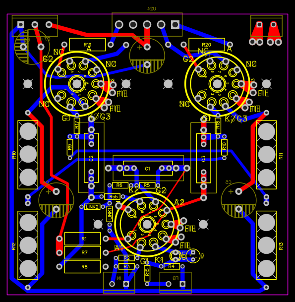

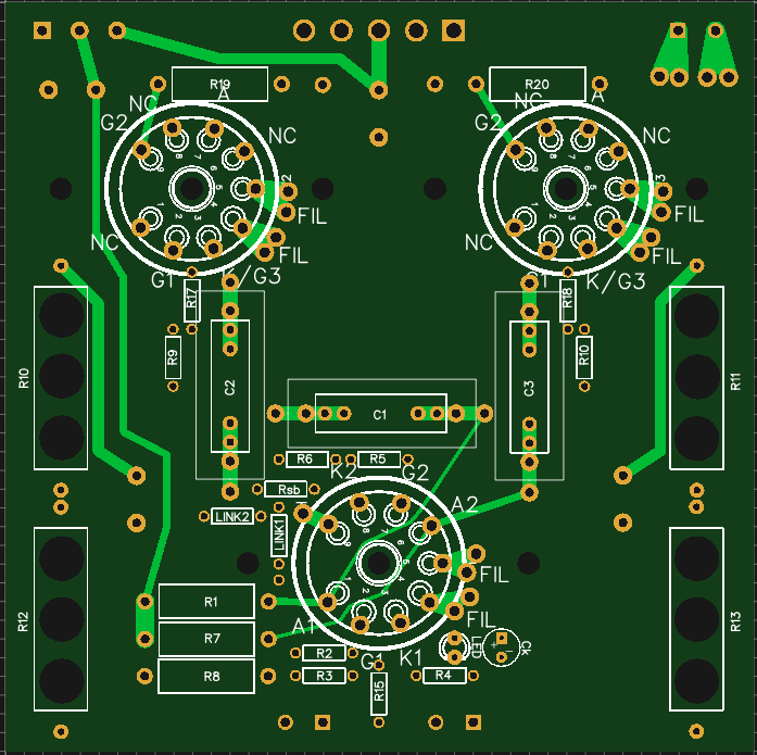

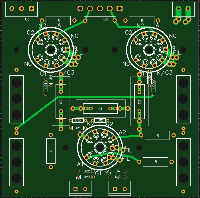

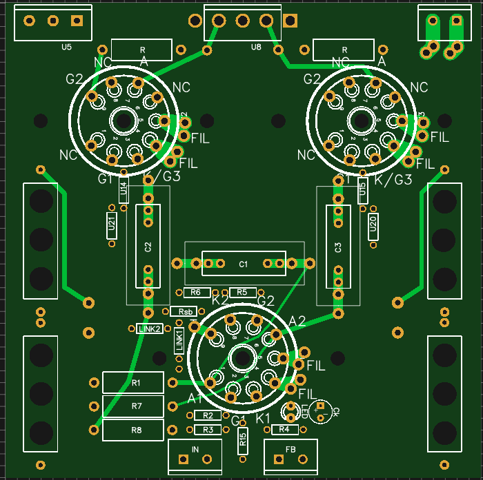

Well, I have some downtime at work, so started to draw up a PCB for this rig. Goal is to have it be semi-universal, one channel per PCB, and be 100mmX100mm. The idea is to use a separate PSU board, or traditional chokes and caps with a vacuum rectifier. Going for a modular, load it out as you like type of setup.
The connections for the plate and screen can be easily jumpered on board, or brought out to a screen supply and UL taps if desired, allowing for triode, pentode, or UL mode connections. Since the original build used garter bias successfully, I've allowed for that on the board as well, with ventilation holes under the resistors. Again, it can easily be jumpered out if standard cathode bias is desired. I may add the choice for cathode CCS loads if anybody has some good ideas for them, I'm just not sure what to choose, as everyone has their favorite CCS.
I'm considering modifying the cathode setup on the front end to allow LED or resistor/cap bias for situations that may want higher gain, with a resistor underneath to still allow for NFB to be used. Could be handy when using medium-mu tubes up front like the 6N1P, and still being able to run some NFB. It's easy enough to add the pads to the existing layout. The cathodyne setup can be biased with the step network as in the original schematic, or self-biased in the more traditional manner, too.
The front end is otherwise the same as the Flea amplifier and the posted schematic at the beginning of this thread, otherwise. should be a neat little board, and especially handy for a garter-bias, triode mode build with the 6P43P-E, 6P14P/EL84 types 🙂
Keep in mind this is very preliminary, nothing is labelled correctly yet, and I'll be modifying things as I go a bit more. Yes, I know there a few missing components, and no ground/power connections yet 🙂
Any suggestions, just let me know!

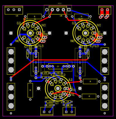

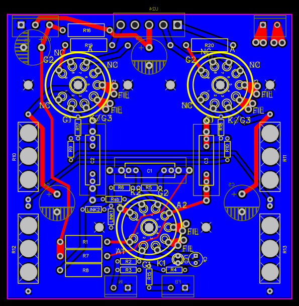

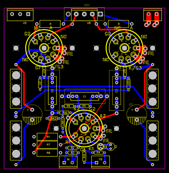

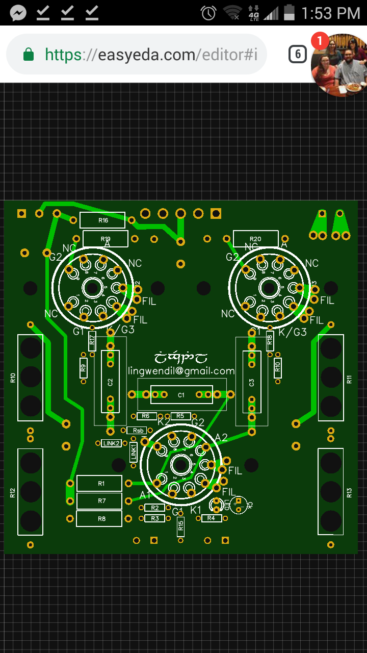

Alright, I'm in a groove, so to speak. Some more work on the PCB. I incorporated the options I listed for the cathodyne and input stage, and started labeling things. I figured having it in the documentation that you populate either the cathode LED or a cathode resistor/capacitor would mean a single LED footprint would work for both the resistor/cap and LED option, or one could simply use a wire link to run the standard cathode resistor/feedback resistor combination.
I decided to keep the same numbering scheme for things as used on the Flea amplifier, just to make it easy for refferring to the existing schematics I have drawn up on hand, and the options will be labelled differently as needed to show function a bit. Spots where wire links are intended to be placed for standard configurations are labeled "LINK" with a resistor outline on the silkscreen to make it easy to figure out at build time. As before, the intent is for you to wire up the heaters with twisted pairs of wire and jump them from socket to socket off board, but a few extra pads will be provided to make DC heaters easier to implement without jumping wire to existing components. Caps are intended to be mounted underneath the board, but will work on top if desired, everything else can go whichever way you want, although the silkscreening is on the top of the board. I'm assuming that most of the warmer resistors will end up on the top of the board so they can breathe a bit.
Yes, there are holes under the sockets for those of you that can't help themselves and feel the need to shove an LED under each tube, but wiring them up is on you 🙂
About to leave work, so likely the last one for today (I have limited PC access at home) starting to look pretty good and complete...

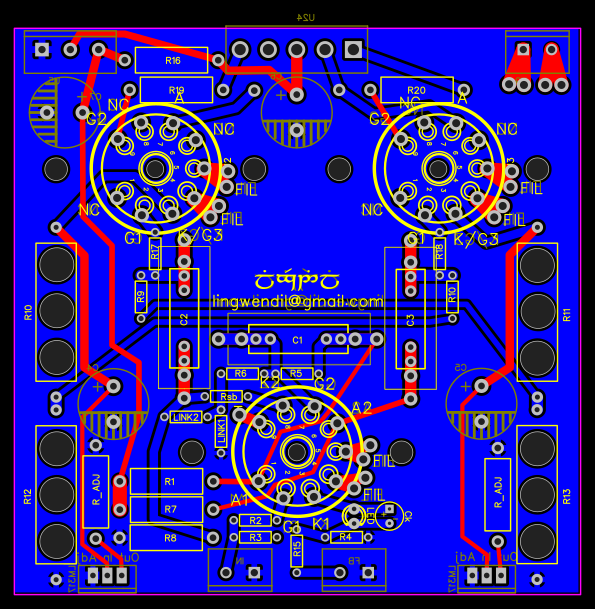

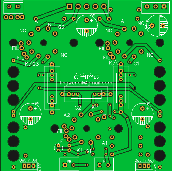

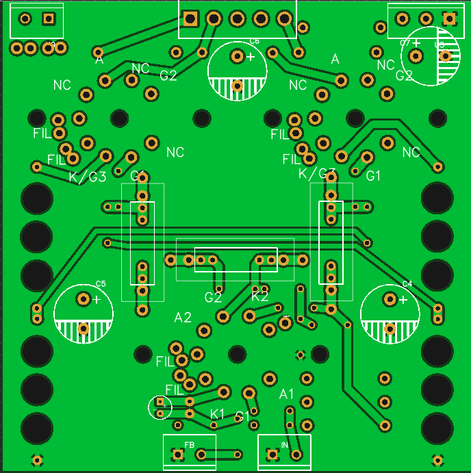

More progress. I decided to change over to a ground pour on the bottom plane of the board instead of traces this time, and I'm liking it even better so far. Added the ability to run separate supply for either driver and output, and added a place to use a resistor to drop the main supply to feed the driver from the output stage supply as well, for single supply use you simply populate it with a resistor and a 2P terminal block, or a 3P terminal block for separate supplies.
Toying with the idea of putting a mosfet screen supply regulator (simple cap multiplier type) on the board, but I'm afraid of "scope creep" making things more complex than needed. It may be best to keep that on a separate PCB... I'm still not sure how I want to go for that. I do have plenty of room for one. Hmmmm.
Little in the way of updates, but worked up my signature into the board (heh) along with my email address. I'm a huge Tolkien nerd, so my username in elvish is my usual signature for most DIY projects.

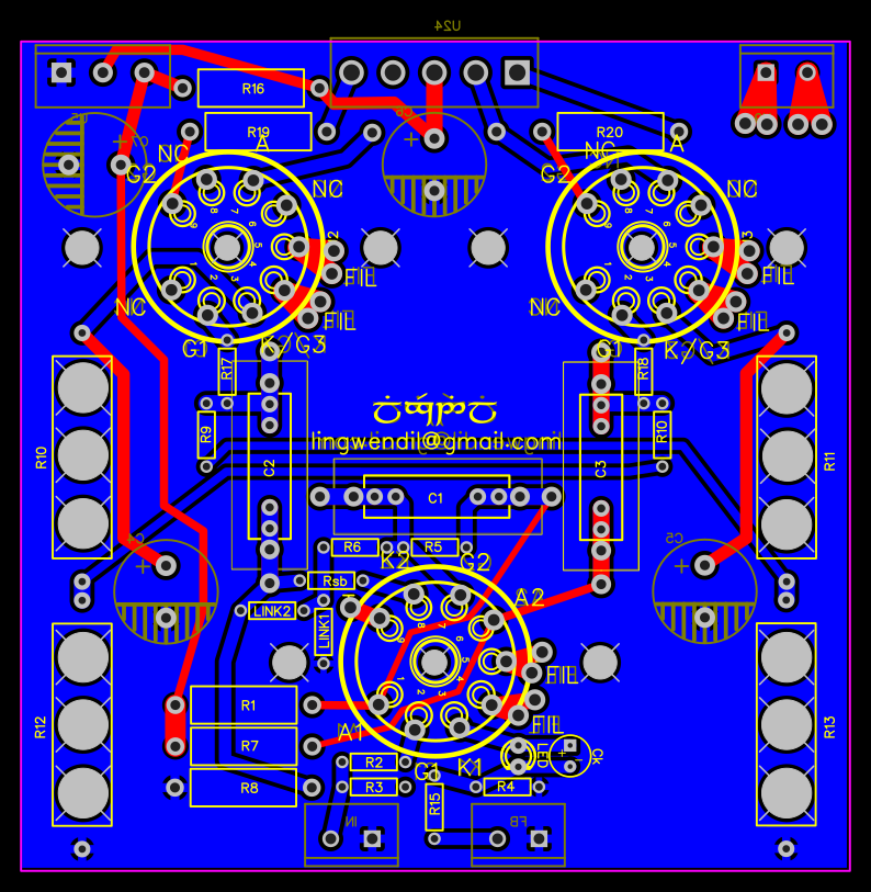

Well, I did a little more screwing around with he board. I've incorporated the option to run an LM317 as the cathode load as a simple CCS by request of several of the folks interested. To use it you simply populate the LM317 and it's current set resistor, and jumper out the bottom garter resistor. While not perfect, it is a pretty popular option and should be a cheap and cheerful way to go for those of you who would like to use it 🙂
I'm thinking that this board is pretty close to being done as far as the general idea goes. I'm not sure what (if any) other features would be useful, or even fit 😎
