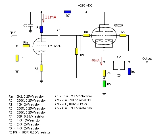

Hi everyone.
Sorry for mistakes in my English.
I have read plenty of threads about 6n23p preamps, I have listened to 6n23p preamp at home and I love the sound of it. I know that this is not a superb tube, but it has this "something" I like. The pre I was using was AVT2729 polish kit preamp. It sounded best with 6n30p tubes, but there was no "magic". Just the 6n23p tubes destroyes the sound the way I like. It will work as a preamp for my chipamp or d-class power stage.
And here is my question to You.
Please help me to choose a good preamplifier scheme for 6n23p (ecc88 equivalent) with as low output impedance as it is possible, as simple as it can be (I like simple audio things, the fewer parts, if applied properly, the better sound). And the most important thing - with as good sound as we can get from this tube.
I know, it may be a stupid question, but since I had contact with the preamp only once, I love the sound and I definitely want to build one, but not necessarily the AVT2729 one as there can be better schemes and better preamps using this tube.
Please help me.
Thank You.

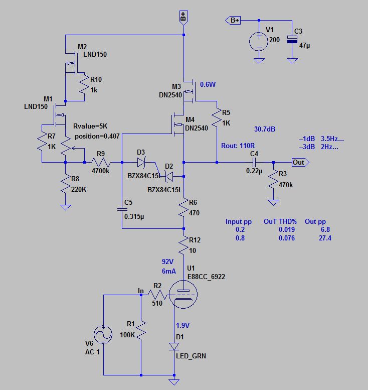

I like the scheme given by you. I is very simple and has the lowest number of elements - kodabmx - could you please tell me where did you get this scheme from, was that ever built and how does it sound? Could you give me any forum threads about building and using (listening) this preamp architecture?
This is a design of John Broskie of Tube CAD Journal.
There is a diode missing from this simplified drawing. I have included one with the diode. It acts to protect the second tube while it's not conducting. The diode becomes reversed biased and falls out of the circuit in operation. Without it the tube might arc over during warm up.
The other nice thing about this circuit is only one coupling cap!
EDIT: The 100 ohm resistor in this design acts to linearise the output at a cost of 100 ohm more Zo. If you need REALLY low Zo you can omit it but try it both ways, it's easy to short a resistor.
AFTERTHOUGHT: If you use 6N23P/6DJ8 tubes you can actually use this circuit as a descent 300 ohm headphone amp. If you use 6N6P and change the values accordingly you can drive 32 ohm loads.

It eliminates the bypass cap. And according to Broskie it widens the soundstage and lowers the gain. It can be wired as normal by doubling the cathode resistor on the first tube, and connecting the second tube cathode resistor directly to ground. I've built three of these using 6SN7 or 6N1P and it indeed is an excellent sounding circuit.

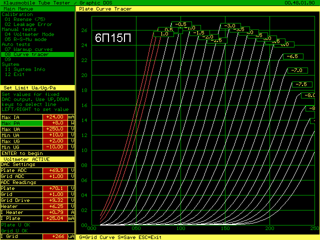

newandrew, I have only built a separate line stage once (I consider separate preamps unnecessary now and put volume controls in the power amp) and it would certainly be much more complex than you are looking for; it is part of my fully differential main system and comprises balanced cathode followers (2 x 6SN7) with pentode constant current sinks (4 x 6P15P-ER) operating on 200V negative supplies. I built this just to see how it would work and wouldn't dream of building something like it now. I mean, 500V from the +ve to the -ve rails just for a unity gain preamp is crazy. I would use semiconductors now.
Why would you need 6SN7 if 6P15P is itself extremely linear tube designed for video amplifiers? 😱
Yes, Anatoliy, I quite agree! This was a long time ago and I didn't know of the great characteristics of 6P15P. I had just bought a box cheap thinking they would make good current sinks. Now I think it one of the best tubes in existence.
