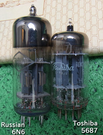

6N6P - may be substituted with 12BH7 (different heater pinout) or 5687 (totally different pinout). 5687 is electrically closer.
Goog luck!
Attached a photo herewith.
Datasheet of Russin 6N6 can be downloaded as below.
http://www.mif.pg.gda.pl/homepages/frank/sheets/113/6/6N6P.pdf
