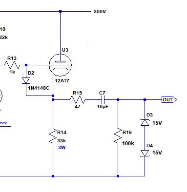

Thanks for the advice, I will definitely add them.
The location is also very simple, they will put them directly on exit rca.
I hope the implementation does not interact with the audio signal in any way.
Honestly, it's the first time I've seen them. 😱
