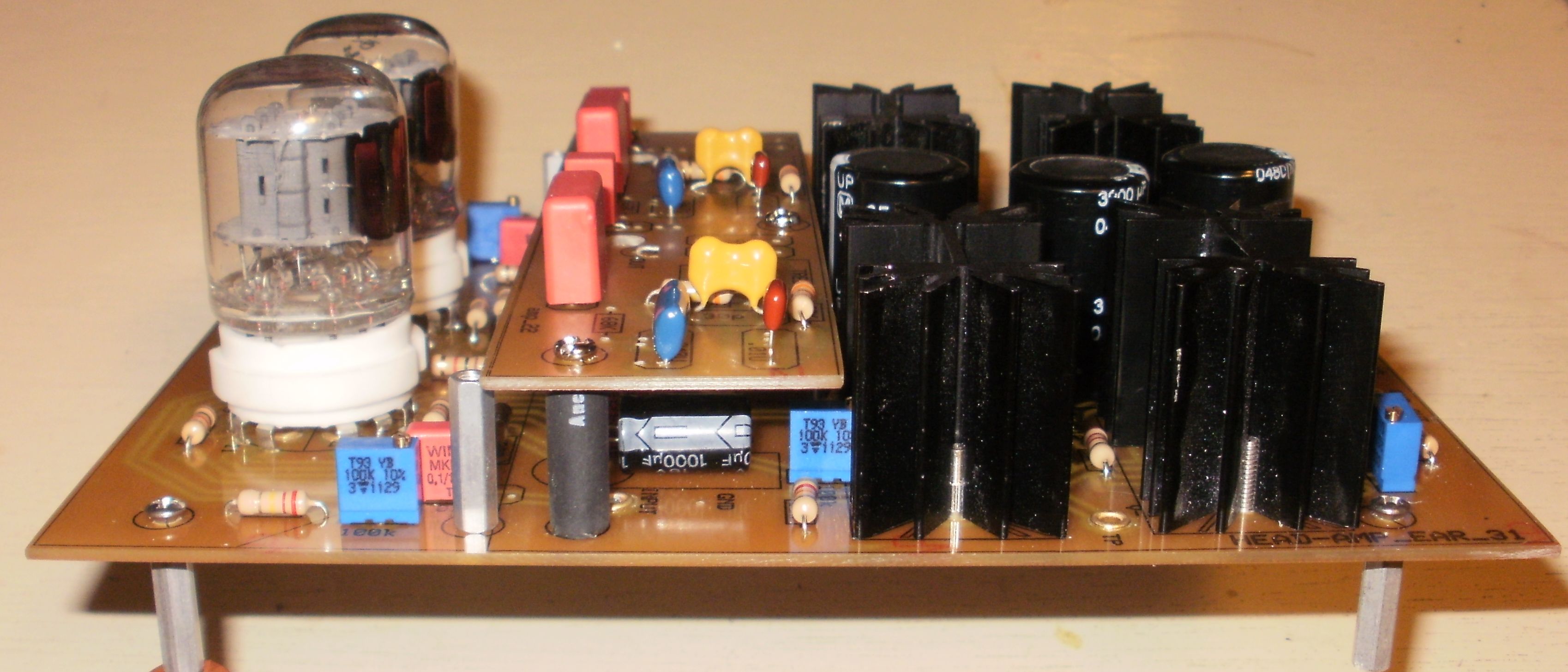

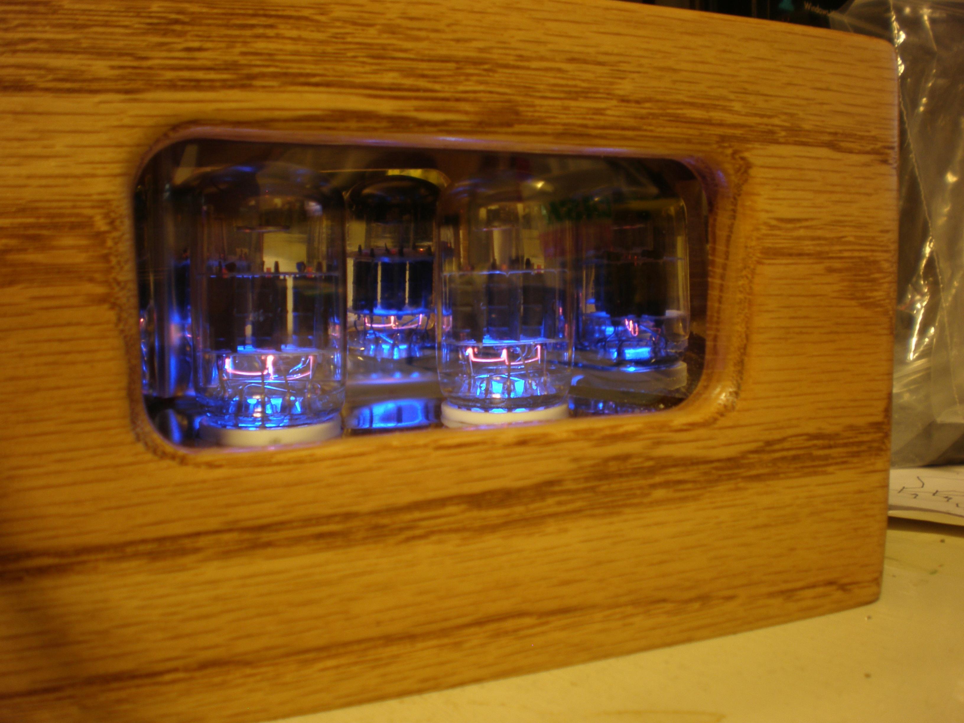

I cheated, tube mosfet hybrid, tube front end and mosfet follower for low output impedance. I guess that you could say it is quite similar to the 6N1P-6N6P design but with a low impedance follower output. It can drive a small 8ohm speaker when biased higher than needed for headphones...
The input gain stage stage drives a tone section that feeds the SRPP with the class A follower output. Minimal feedback is used from the capacitor coupled outputs. The tone section is the little PCB that sits between the tubes and heat sinks. 1/2 height heat sinks are adequate for headphones, full height are needed when biased up for small speakers. Works for all headphones tested down to 32 ohms.
Some folks balk at sand in the signal path so I have another all tube design for this winter using 6JT8 tubes in a PP configuration with small Merit PP output transformers. It should be capable of 3-4watts/channel so driving headphones should not be an issue. If this design does not sound better than the hybrid, SE would be the next project. The hybrid is quite good so it has set the chin bar quite high to compare the other designs too.
I have said this many times before but it is worth repeating. Low output impedance does not necessarily mean high drive capability. The OTL amplifiers being discussed already have a very low output impedance but they do not have a very high drive capability. High drive capability comes from a high standing current which is much easier to achieve with an FET than a tube.
