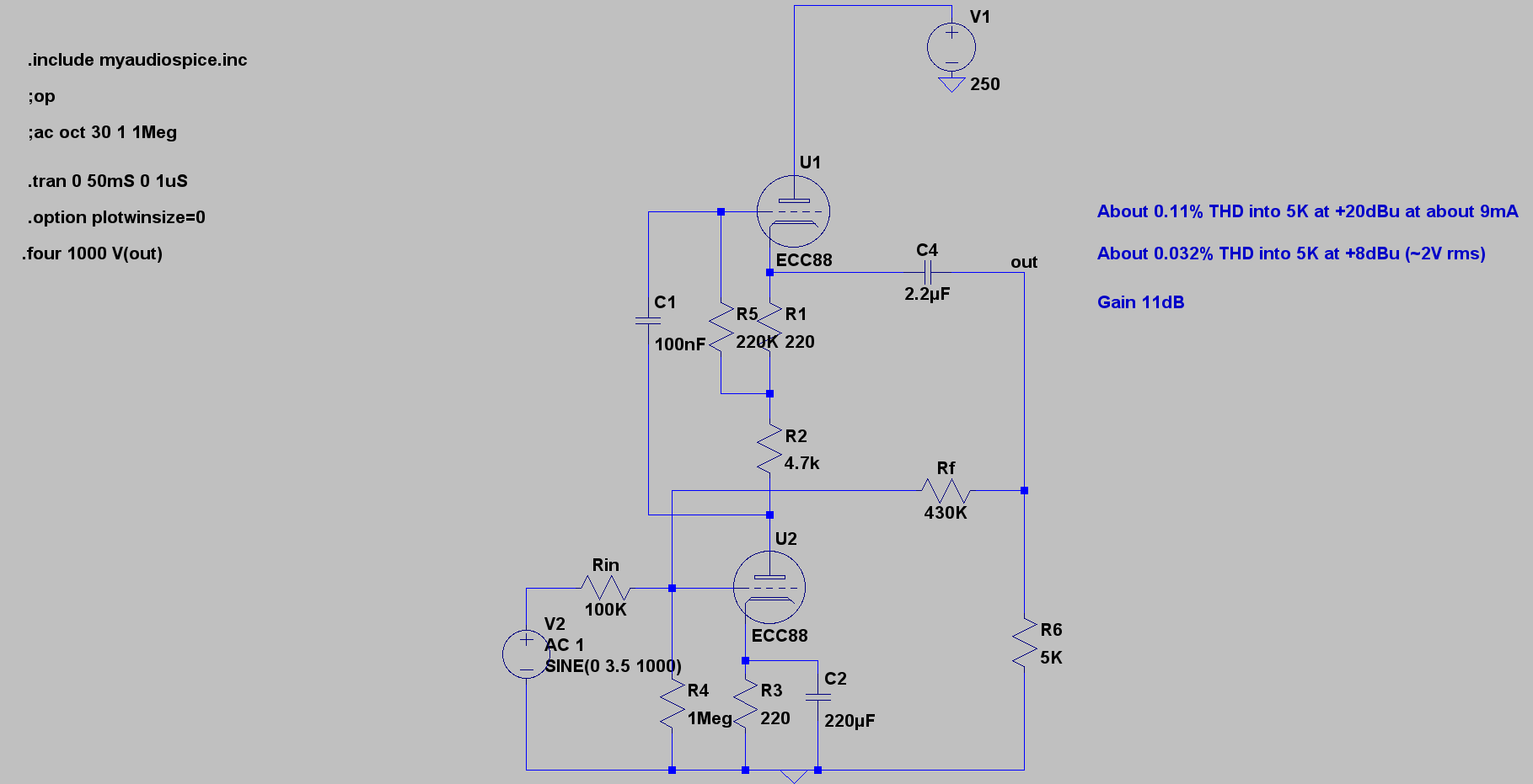

Hello, I have from last year this cheap preamp board:
Buffer 6N11/6DJ8 Tube SRPP Preamplifier Headphone Amplifier Board Preamp PCB DIY 699917213049 | eBay
Since I'm interested to a circuit possibly with a lower Z out (maybe good for driving later an amp stage or so), I wonder if it's possibile to modify it simply for a mu-follower circuit, I was thinking to something like this schematic here

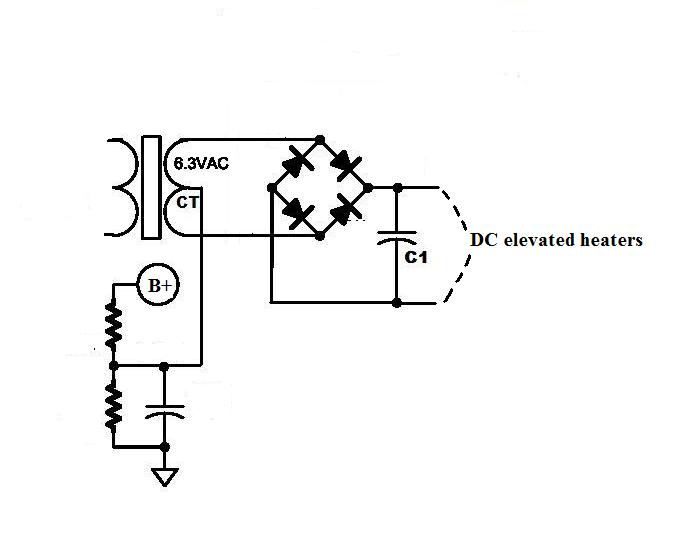

I have this image on my PC as to diagram for 6N11/6DJ8 headphone preamp

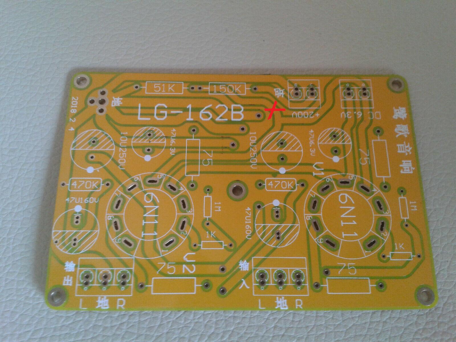

As I remember from the board there is a small discrepancy in the wiring of the heater circiut, A divider is missing from the diagram which is 150k/50k from B+ to gnd with tsp going to one side of 6.3v
Maybe do you mean a part is lacking about the heater elevation circuit for the SRPP upper tube?
