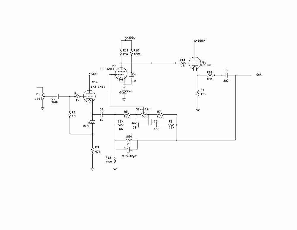

6M11 Compactron Preamp with Tilt Tone Control
PRR:
An earlier (simpler) version was published by SY- see pic.
It doesn't have the 1uF bypass caps or separate anode resistors, as in your schematic.
Only the 100R stopper is different from your suggestions.

TRY IT!! So it oscillates on the test-bench.... what harm happens?
With all respect to SY, it is more robust if the NFB does not share the same output damping resistor as the Outside World. In a Hi-Fi with 3-foot cables, it is probably no difference. Hang a 1,000 foot cable on there and there is considerable phase lag inside the audio band.
Yes, any amplifier will oscillate if layout is bad. I think you can wire this up tight and neat. One gotcha is the length of wires from the tube to the controls. As in many audio chores, you realy don't want long wires here.
It's fine, however.....
I did try it - it makes no difference that I can see whether I wire it with/without the changes in the bypass caps and anode resistors, or whether I move the NFB inside or 'outside' the last stopper.
There seems to be a very small amount of oscillation consistently 'widening' the scope traces - but I'm not sure if that's important. The oscillation I had previously seems to have been eliminated with the 220pF across the NFB resistor. I have some pretty long wires (antennas..) attached to the circuit now - power wires up to the bench supply and the leads from the audio generator to the input. Scope leads shouldn't be much of a problem, but they are hooked up to input and output as well. Question: Right now I just have the scope attached across the output.
Should I be loading the output with a resistor to mimic the input stage of a (tube) power amp?

It's still on the breadboard but doesn't seem to have much bass getting through, even with the pot at full 'bass end' rotation. Anything below 200 Hz is half (-6 dB?) or worse
Lots of treble though - double the input voltage at the output (6 dB?).
I'll check the wiring again tomorrow.
I don't really understand how the tilt circuit works, so I have problems troubleshooting it.
And, it may be an amplifier problem and nothing to do with the tilt control at all, I suppose.

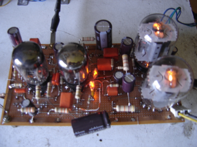

Changing C6 - the coupling cap after the first tube section - seems to have brought the bass response up. I had to use an electrolytic there - there's about 160 volts across that cap, so a 10uF film cap is out of the question.
I checked the bias across the LEDs - 1.9 volts each.

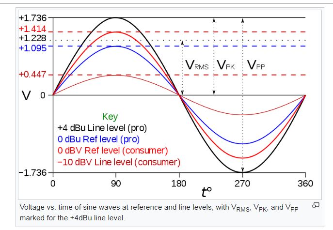

For the first tube section - this seems about right to handle the 2 v signal from a CD player?
I usually accept line level to be 1VRMS over 47/50KΩ. In any case the bias seems to be a little high, but not the responsible for the poor bass response.

a)The whole point of the preamp/linestage is to act as a tone control with no gain. I want to see lots of bass boost at one end of the pot rotation, and corresponding treble boost at the other end. I'm not sure what the mid-point of the circuit is - what frequency will be unaffected by pot rotation, so that needs some experimentation.
b)'Removing the passive elements attached to the pot wiper' - I don't understand what this means.. The pot and the tone/tilt control are interacting with the NFB in a way I don't understand- it's not simple to try to 'bypass' parts of the tone control. c)Also, I don't understand the 45 deg phase rotation idea, at all - don't I have to use Lissajous (X-Y) patterns to determine this? d)'tip attenuator' in the probe - do you mean to use a 1X probe not the 10x I'm using?
