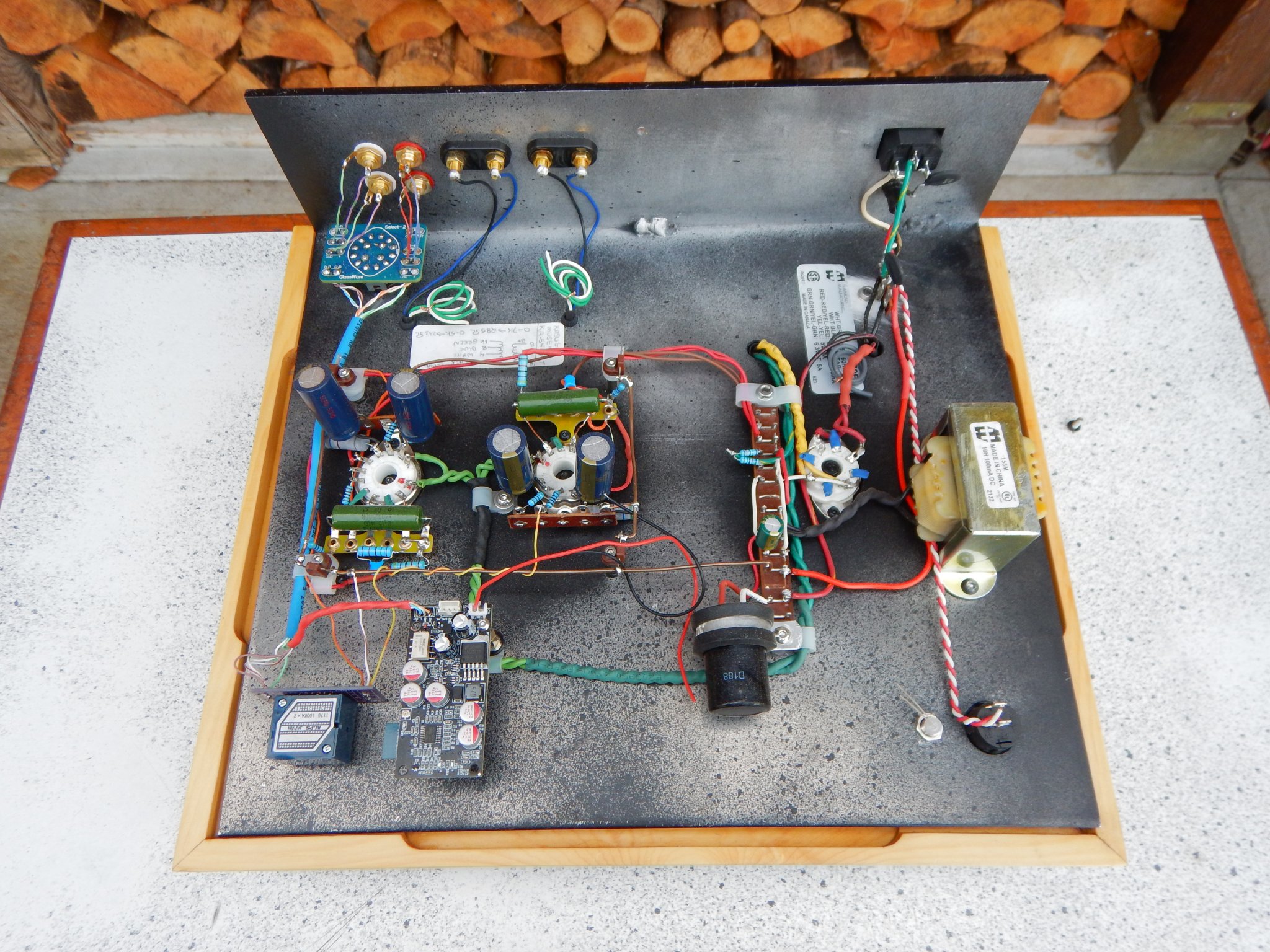

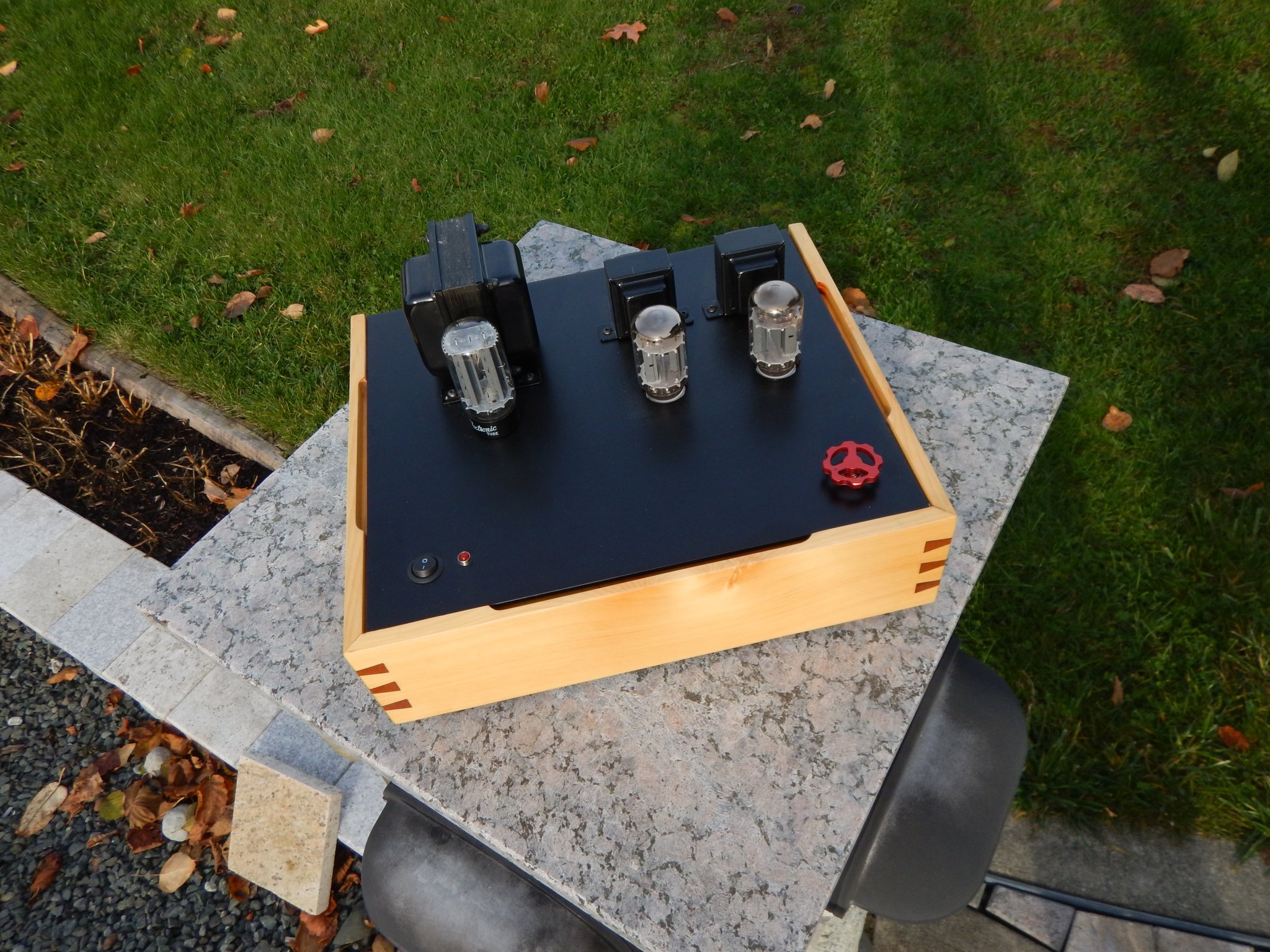

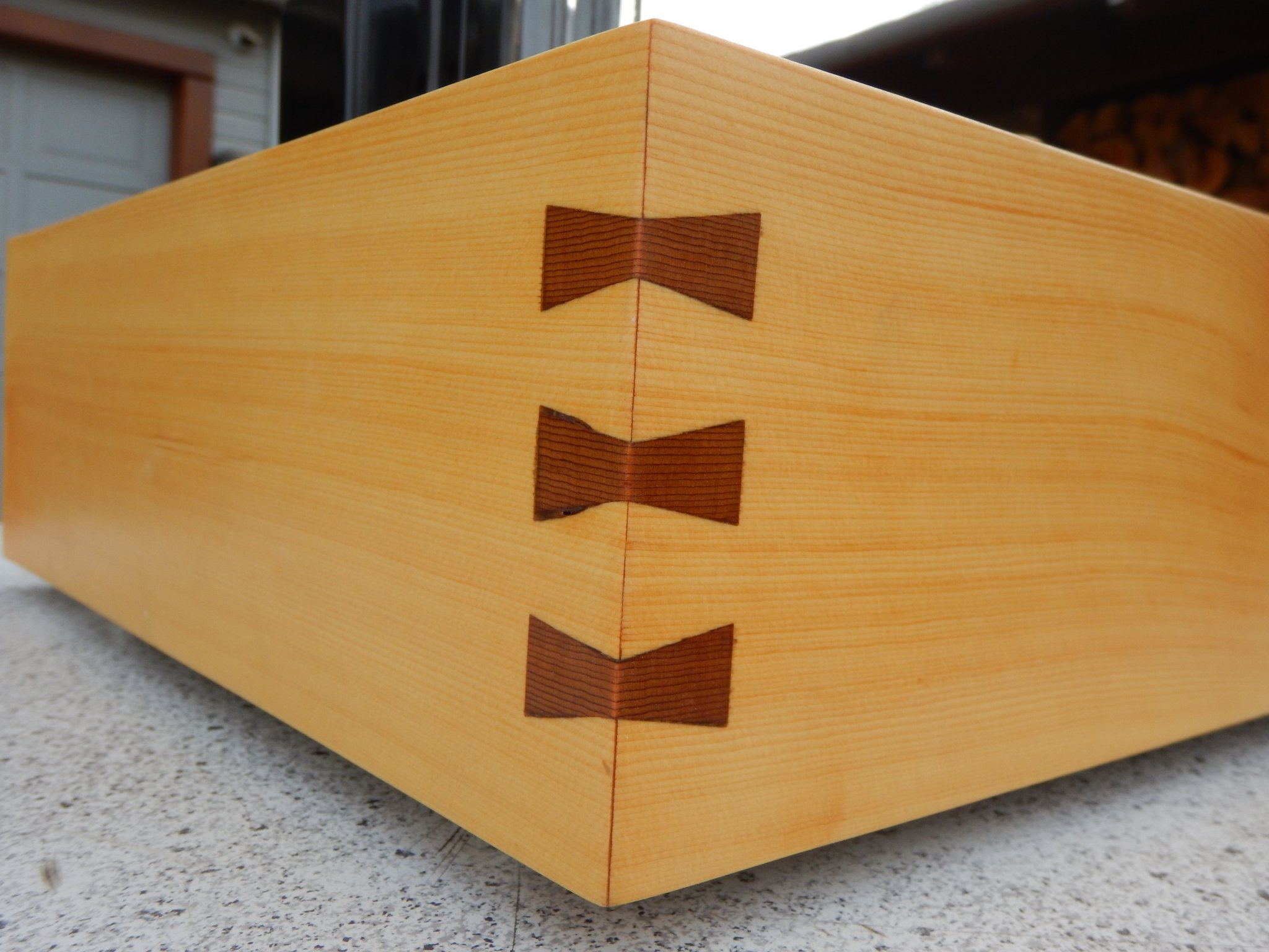

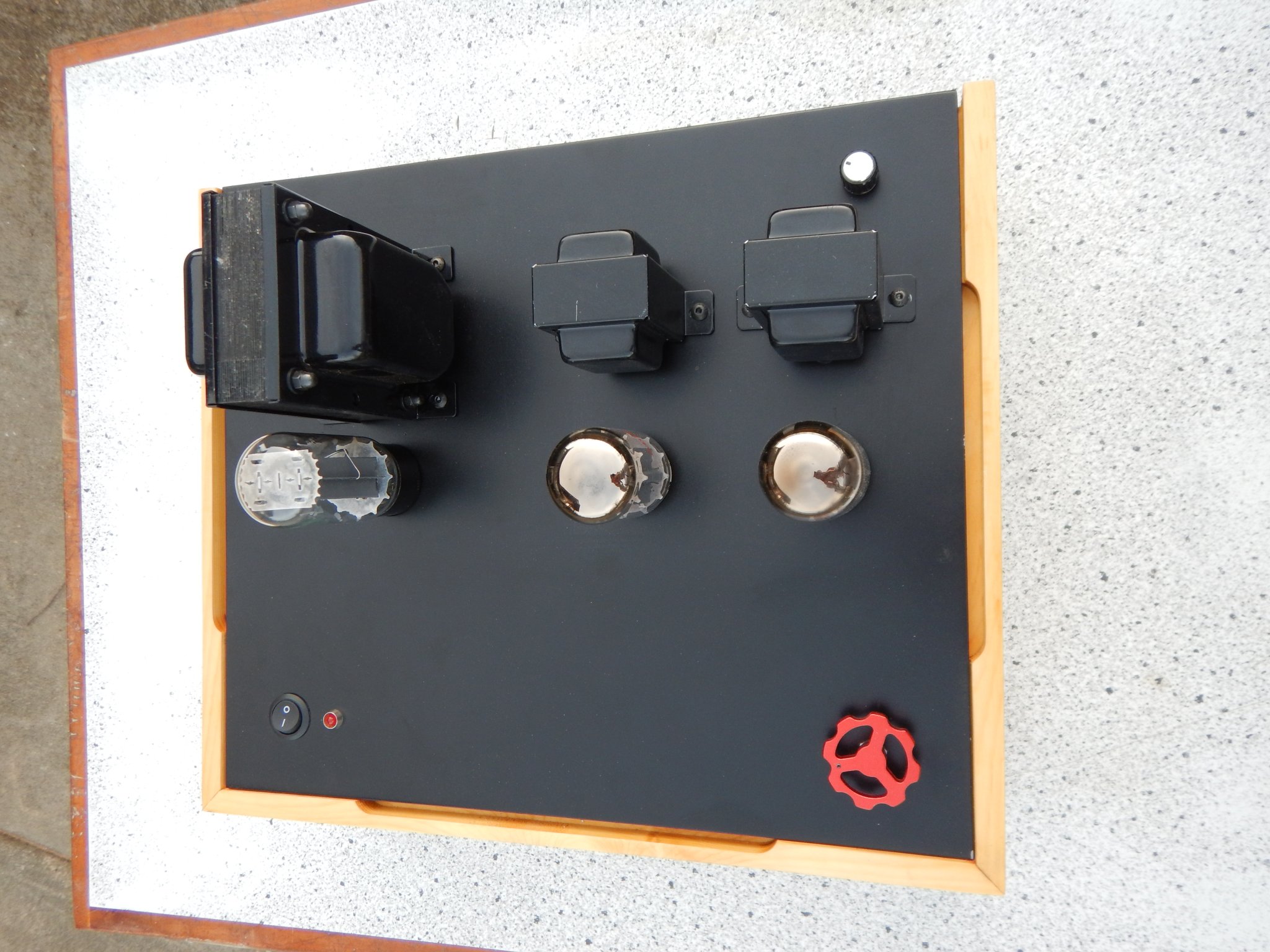

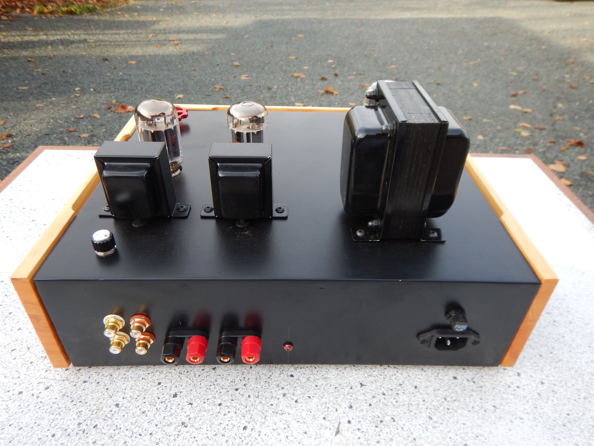

Hello All:
Attached are a few pictures of the 6lu8SE amp I just finished. It is based on the 6LU8SEUL design by Kegger from over at AudioKarma. Mine is straight SE with some lovely Kasugi Musen 5Watt output transformers. The screens are tied to the plates with a 1K resistor. The case work is Yellow Cedar with Red Cedar dovetails in the corners for contrast. The power supply is based on the Hammond 270fx with a GZ34 rectifier. B+ is 300v. Output is a solid 3Watts, with a slight low frequency roll off. The 1K square wave looks great as does the sine wave. Screen voltage is just below B+. Max output is dialed in to be achieved with a 1.5vac signal.
Three inputs :2 external, one at ~ 30% attenuation, one open, one internal input for a Bluetooth receiver. I used 3mm aluminium plate for the top and back plate. I welded and dressed for crisp clean lines. I used an acid etch primer and Semigloss Black paint. I selected the mounting hardware for a very clean top plate look. I drilled and tapped the top plate mounting holes then cleaned the holes with a degreaser, put a 2mm long screw in the hole and fill welded and sanded the top plate to make them disappear. I recessed vent lines in the wood side panels to allow for heat escape. The bottom is "holey" aluminium plate. The volume knob is a repurposed control knob from a 3D printer. overall size is 14x12x4 inches

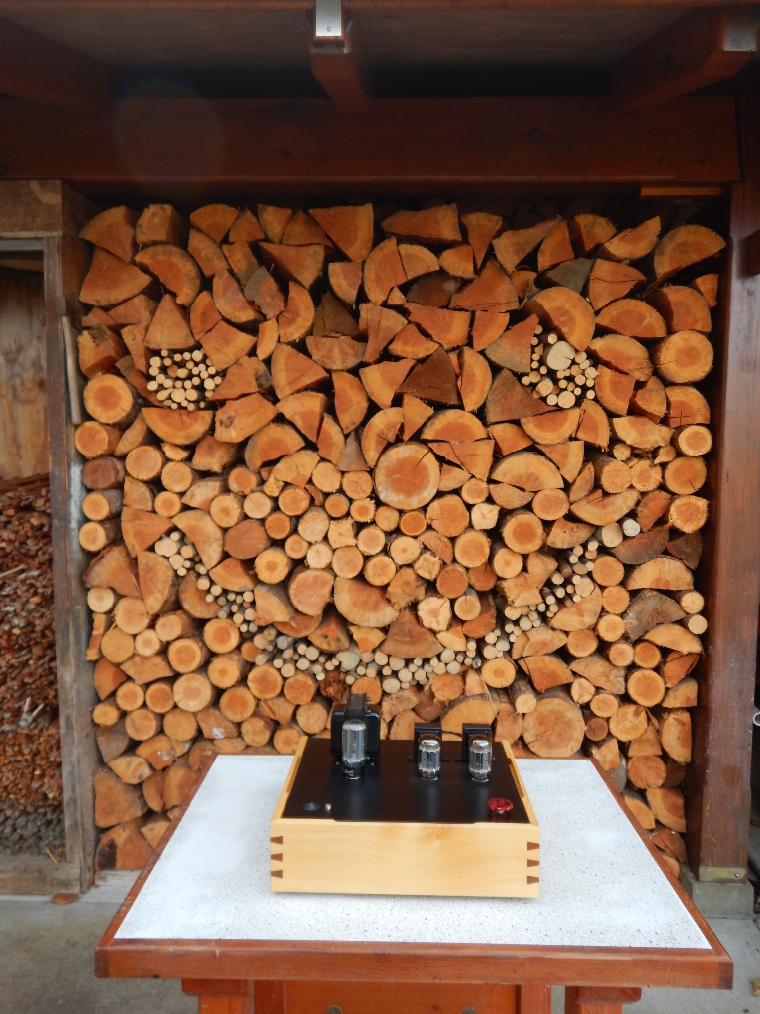

And just for sport that is my woodshed in the background. The winter of 2024 should warm at my house.

I really like the originality of the volume knob, I usually put chicken head style knob but this is way cooler. Was it created via a 3D printer? If so, is the file available?
Go get a hose bib handle and glue in some 1/4” ID brass tubing into the middle with a screw to tighten.
Well I am not sure I should share the secret knob. It is a bit of a design signature. But because you are CDN and a pretty good fellow.
Consider this:
If a person was to look up "3d printer knobs" on one of the more common Asian shopping sites, a person might find a few different options to consider.
The ones I chose are Aluminium. I drilled out to 6mm. They come with 2 set screw. The colour can be changed with a bit of paint. I stayed with Red as I was using a red LED as my power on indicator. I have painted them opalescent green as well and used a green indicator light.
I hope this helps
Consider this:
I hope this helps

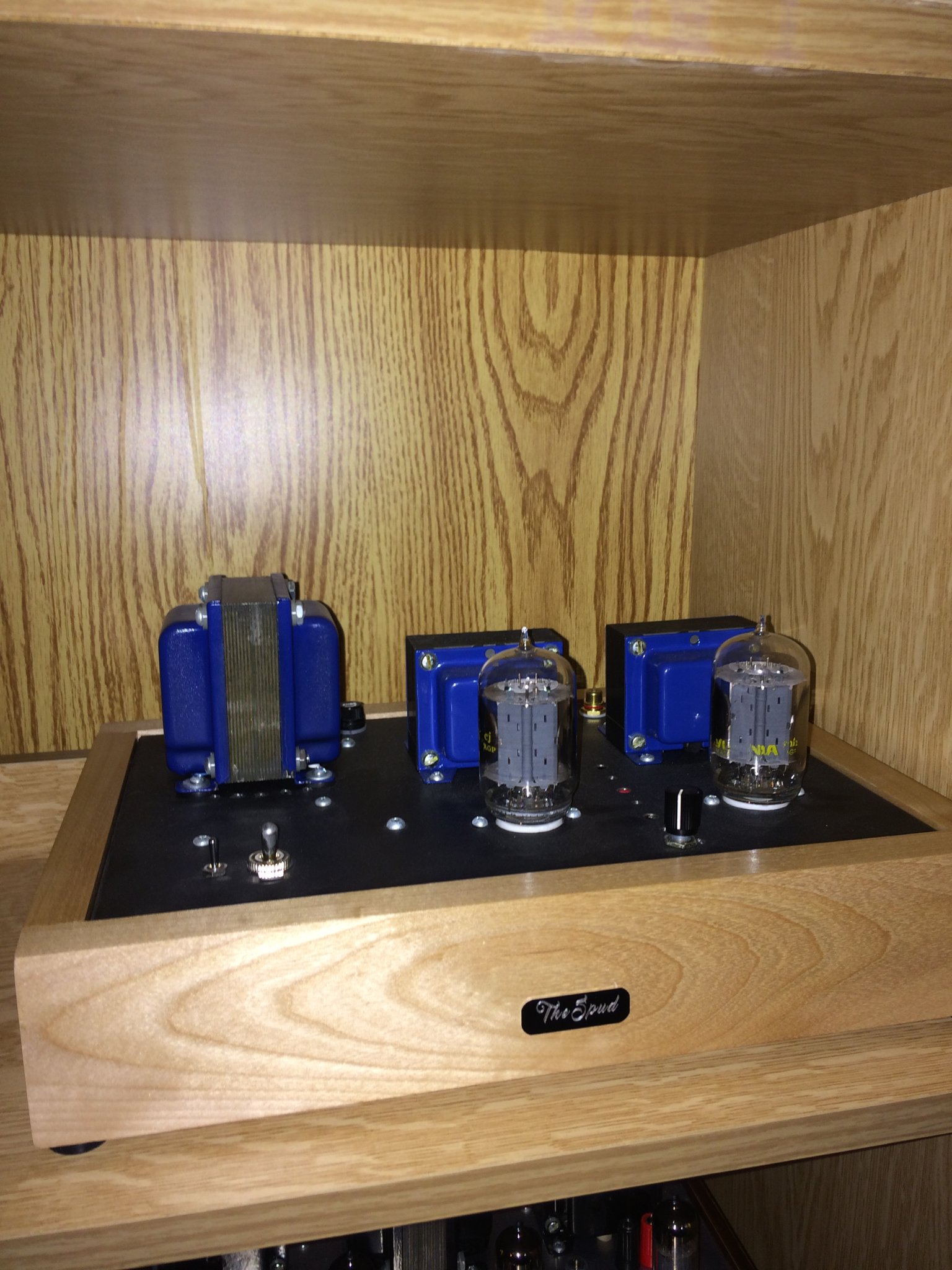

Mine is below with 6LR8 (same as 6LU8 but in 9 pins), same Kegger’s design. It will look a lot better with the secret knob 👍
Eric
Very nice work Eric:
I am guessing that is Ash for that skirt on yours?
Yes the secret knob is a good thing.
John's hose bib idea works but it is a bit big for a small chassis.
While you are on that Asian shopping site check out some the black screw options. I like the button top ones, I also go for acorn nuts rather than regular nuts as it gives a more refined look. I have accumulated a very extensive collection of 3,4,5 mm screws. I use the little watchmakers glass top storage cases from LeeValley stored in an old mechanics tool crib. Works for me.
