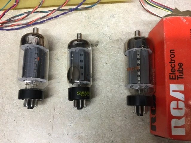

Most top-cap-type horizontal outputs are NOT described as “double ended”. There are some that have double plate structures (and others that have two complete pentodes in them). The one on the right has two complete plates - one on either side of the beam former. Both connect to the top cap. That could be what they are referring to.

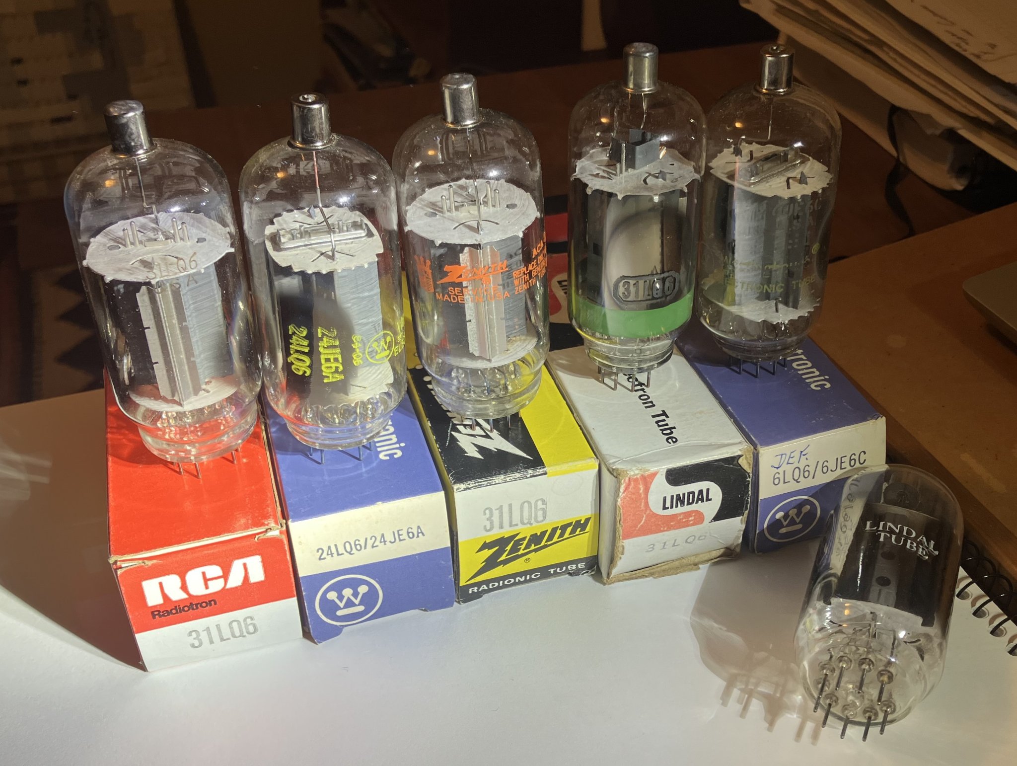

4 x 31LQ6 (RCA and Zenith with identical guts, one Lindal with Westinghouse guts, and Japanese Lindal with green stripe and MASSIVE radiator fins on Westinghouse guts), a Westinghouse 24LQ6 and a (probably defective ) Westinghouse 6LQ6.

Then “double ended” may be a poor translation from Japanese as well. I don’t see anything that one that is fundamentally different from my stash of 21LG6’s, or others (lower rated, lower heater current) that share that plate. A couple of those have bigger fins, but the one on the far right doesn’t. There is only one plate and one connection to it. If it simply means “top cap type”, so what? That’s the rule, not the exception. You have to go out of your way to get types that don’t have a top cap.
