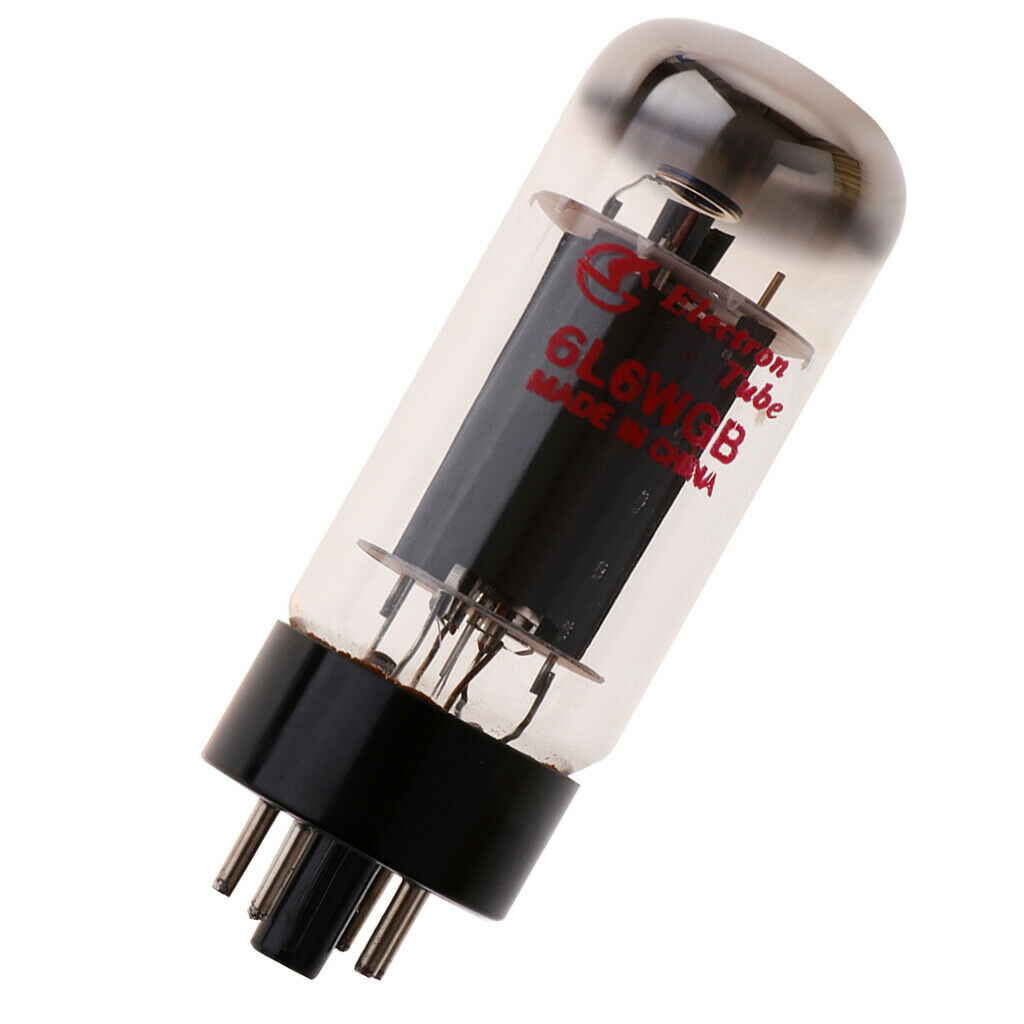

I have some tubes that say 6l6gwb on the base and 5881 on the top. Datasheets list different max voltages, especially grid 2 voltages. Which are they and how hard can I beat on them?
5881 is an improved 6L6 for sockets which were eating too many 6L6. (Not 6L6GC, which is a different improved 6L6.)
Conceptually you have 5881 marked-up to remind you these will work in 6L6B sockets.
What you actually have, I have no idea. I do not remember that dual-marking back in the day, but I did not buy 6L6 every day, and I know modern marketers are very good at putting new labels on old bottles. (Opposite of what some wine-merchants do.)
The 6L6WGB was a 6L6GB stuffed into a small glass envelope with ruggedized mounting of the internals to handle the physical abuse of military applications. The 5881 is very similar, and in many cases are the same tube.
I have a bag full of very well used military pulls from the 60's and early 70's. I went through the whole bag and found an equal mix of 6L6WGB's and 5881's but NONE of them were dual marked.
If your tubes were indeed marked like that by the original manufacturer, then I would assume that the higher screen grid rating of the 5881 applies.
