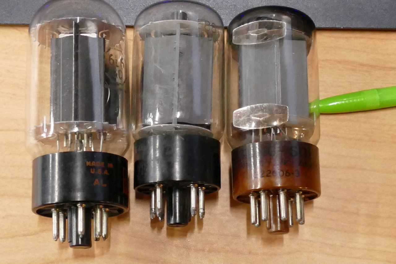

Tubelab_com said:The 6L6WGB is the internals of the 6L6GC with a rectangular box plate stuffed into a short bottle, originally for a military application. I have a dozen or so of these that came from military scrap, all well used. Some also carry 6L6WGB / 5881 designations.
And more nuggets of tube knowledge! Does the short bottle reduce the heat dissipation very much? I'd think it would, but in your experience?
I have not explored the upper limits of these tubes, so I really don't know. I have a whole drawer full of 6L6 types.
I have done most of my extreme testing on the older 6L6G's and GA's since I have a lot of them. I have seen 100 watts flow from a pair of tubes without glow....but I have seen two non fatal tube arcs trying to go beyond that. The tube lived to play on, the cathode resistor did not (1 ohm 1 watt 1% current sampling resistor).
I have a dozen or so of these 6L6WGB's and there are 3 different styles among them, there are probably more. The picture shows a RCA black plate 6L6GC next to a Sylvania 6L6WGB (also marked 5881 on the glass) and a Tung Sol 6L6WGB / 5881. The Sylvania has the largest plate, but the RCA has longer heat radiating fins allowed by the larger diameter bottle. The Sylvania has the familiar contoured plate seen in all older 6L6 types. I have seen the same plate used in Sylvania 6L6GC's. The Tung Sol has a rectangular box plate like that found in many modern Sovtek tubes. I'm guessing it's the wimpiest of the three.
Note how toasted the base of the Tung Sol tube is. This is one of the better ones, I put the real toasted Tung Sol tubes in the guitar amp. These things must get hot.
That 5881 is just downright burnt. Too much heat buildup in the base, must have spent it's life upside down.

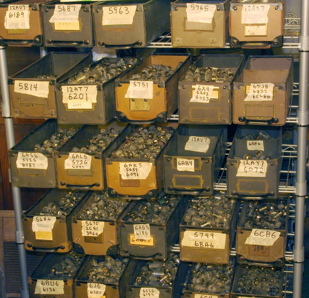

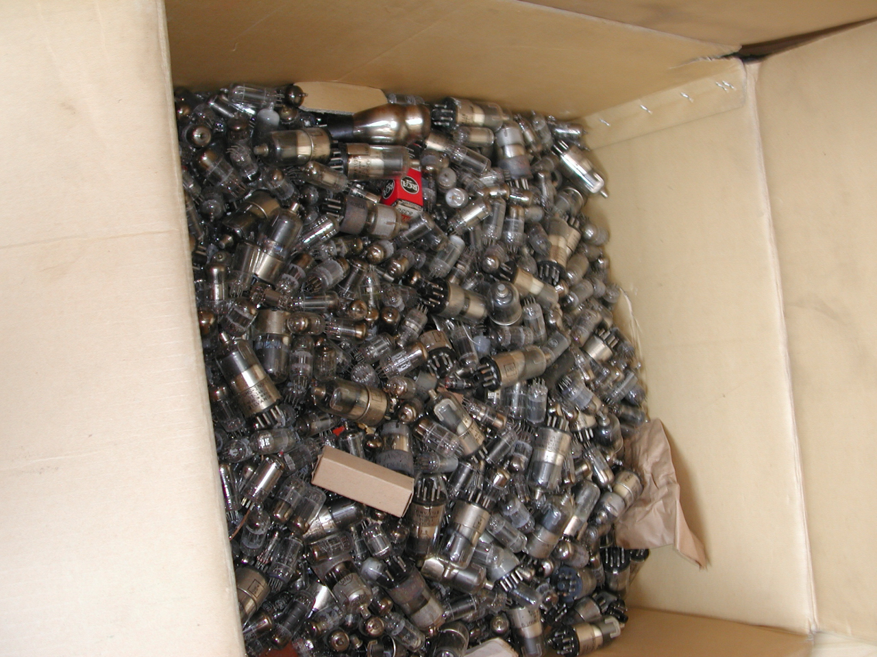

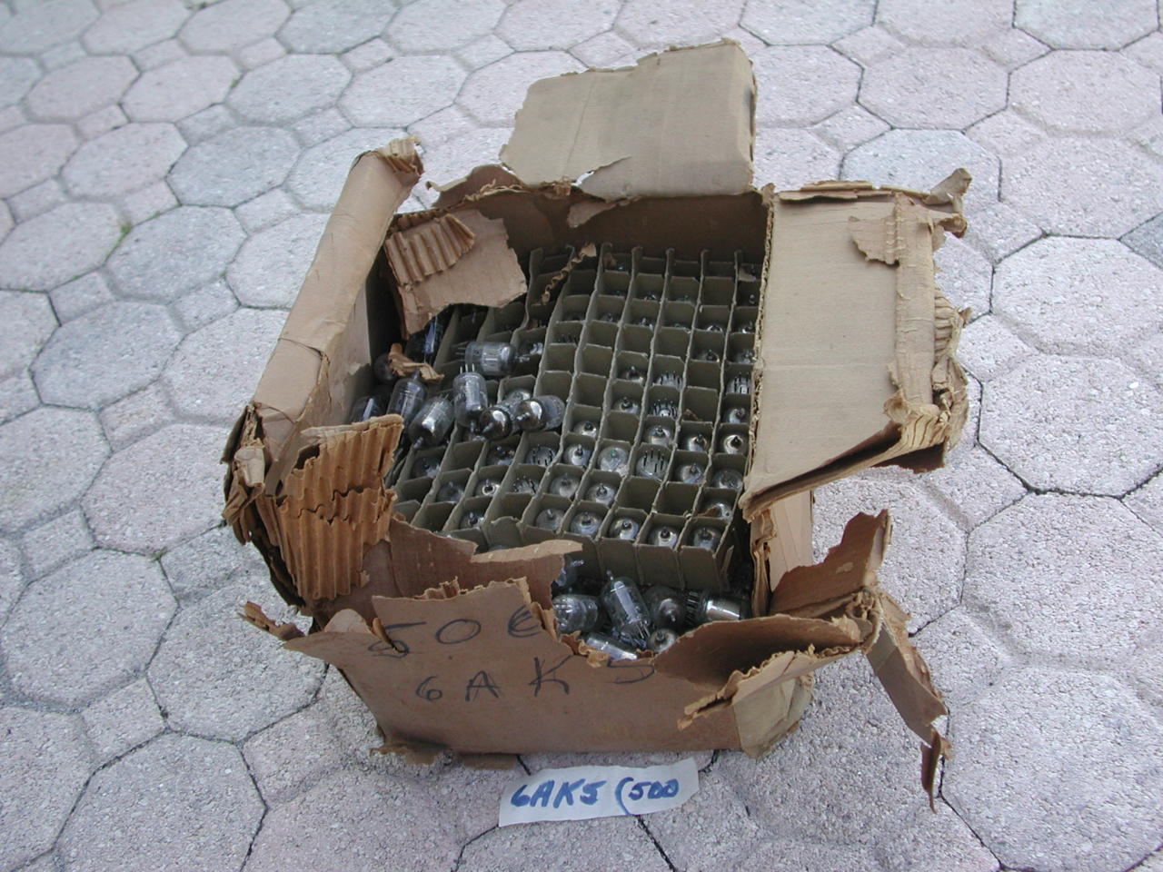

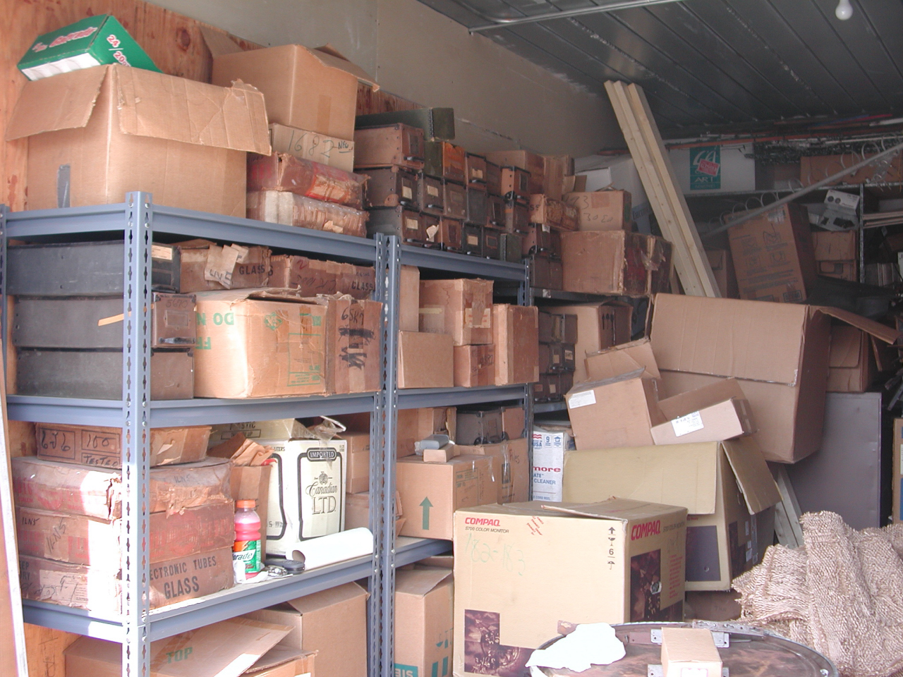

These all came from a lot of over 100,000 tubes that I got over 10 years ago. The original owner ran a place that disassembled military surplus, scrapped the metals (his primary business) and shelved a lot of whatever he didn't sell. He had passed away maybe 5 to 10 years previously and his huge warehouse sat untouched for years. Vandals had broken the windows, and gotten inside and smashed up a lot of stuff over the years.
About 10 years ago the estate was settled and the property sold. The dozers came to flatten the warehouse and were in process of demolishing the place when someone decided that there were hazardous materials inside. My friend, another surplus dealer stepped in and offered a small price to buy the entire contents, which was accepted. He called me and said I could have ALL the tubes including all those hazardous mercury filled tubes for a couple of weekends time moving all the stuff into his warehouse.
There were over 100,000 tubes, all dumped loosely into boxes, wood crates, and even trash cans. In retrospect, it was a dumb decision since I had to move them all 200 miles to my place and pay warehouse rent while I sorted them all. That process took about 5 years, and I kept about 10,000 out of roughly 100,000. That number has been reduced to about 5,000.
The 5881 / 6L6WGB's came from this lot. I discovered stuff in there dating from the late 30's up to the early 60's. All military or aircraft related.
There was an unopened box from the Douglas Aircraft Company to an Air Force Base in Texas, dated Aug 1937. It had tubes inside.
Many boxes of bulk packed tubes, partially eaten by rats, and covered in bird poop. I stuffed all this into two 200 square foot rent-a-space warehouses. That 55 gallon cardboard drum in the lower right foreground is full of loose tubes. Most of them broken. Plenty of boxes like the Compaq monitor box, full of loose unsorted tubes. I set up sorting racks like these, first to presort by size, then to sort by number. About half the tubes were broken, or had pins to corroded and mangled to be used. I had fun blowing some of these up. When it was done there were about 10,000 useful tubes. Maybe 100 6L6 types, mostly older G's, GA's and GB's. Some I have since sold or given away. Here are some of of what's left. I have LOTS of 6AQ5's, some good, some not so good.

That's pretty amazing George. What's even more amazing is that you stuck with it and sorted them all out! What a mammoth task for anyone, never mind expense. I bet you wouldn't do that again!
I think I see a bunch of old style radio tubes. Those are interesting. The 6AK5 looks like an interesting tube as well. So many tubes, so little time to explore. I can't imagine what you feel every time you walk into your tube storage area.
-Chris

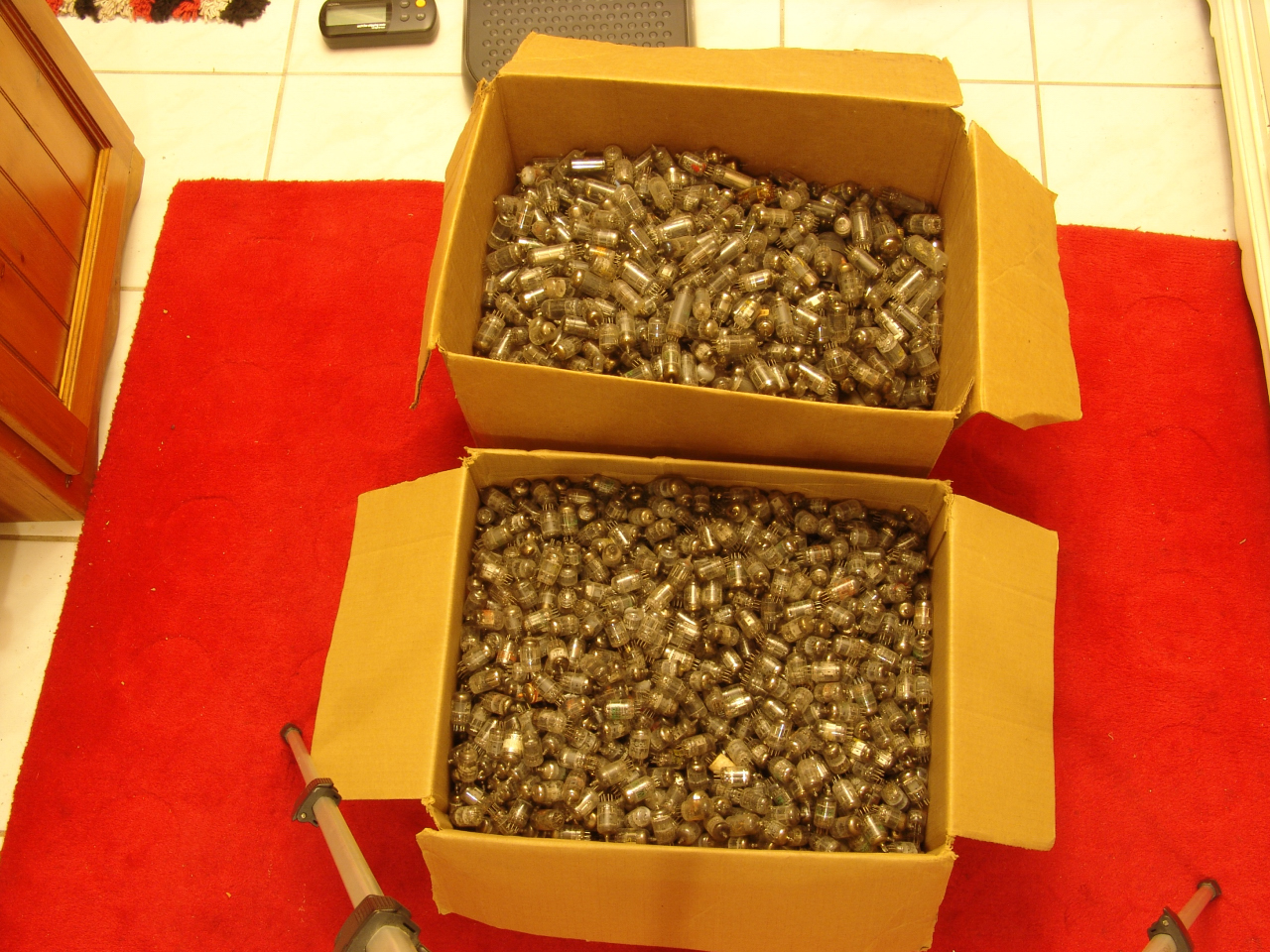

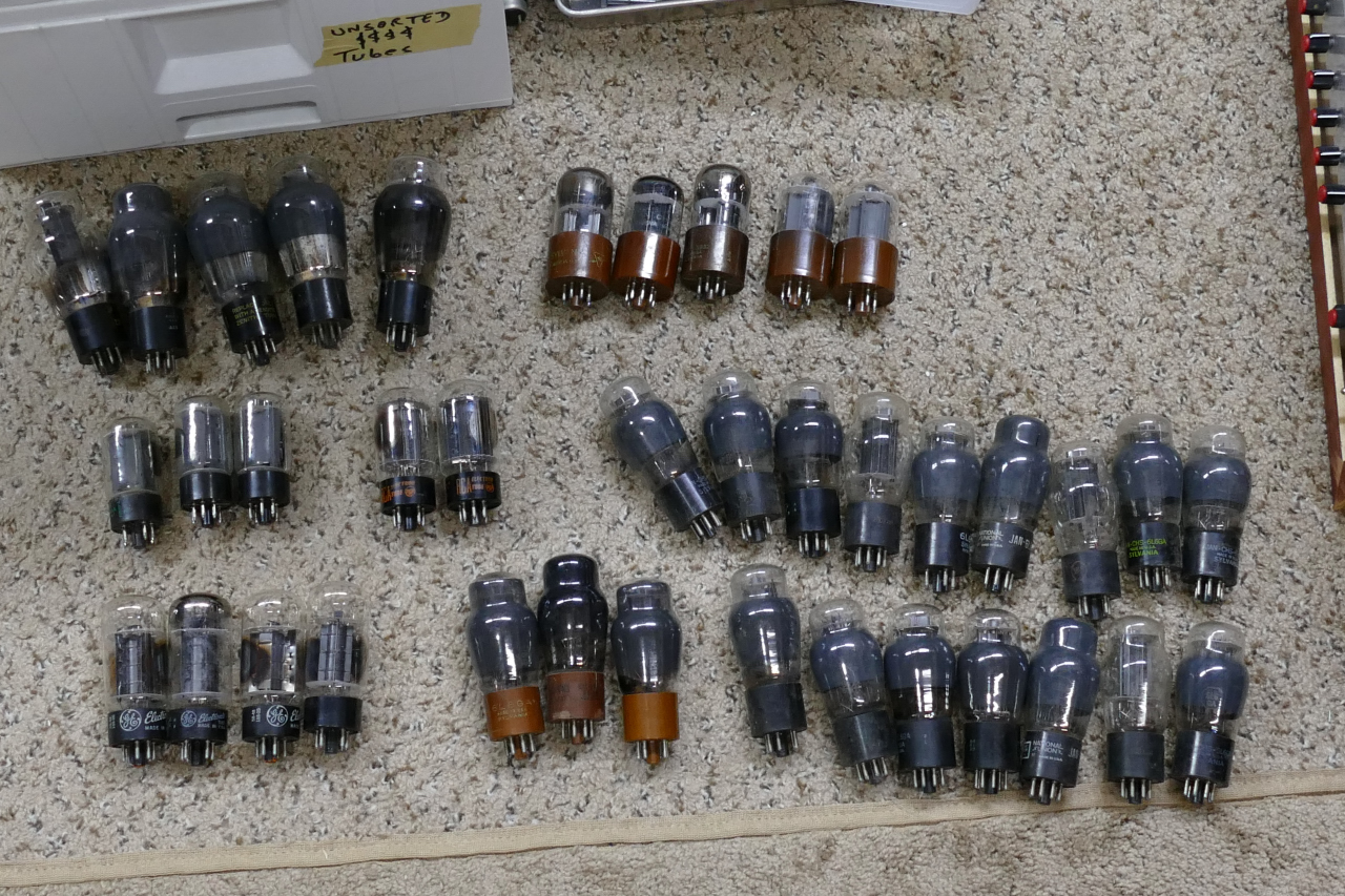

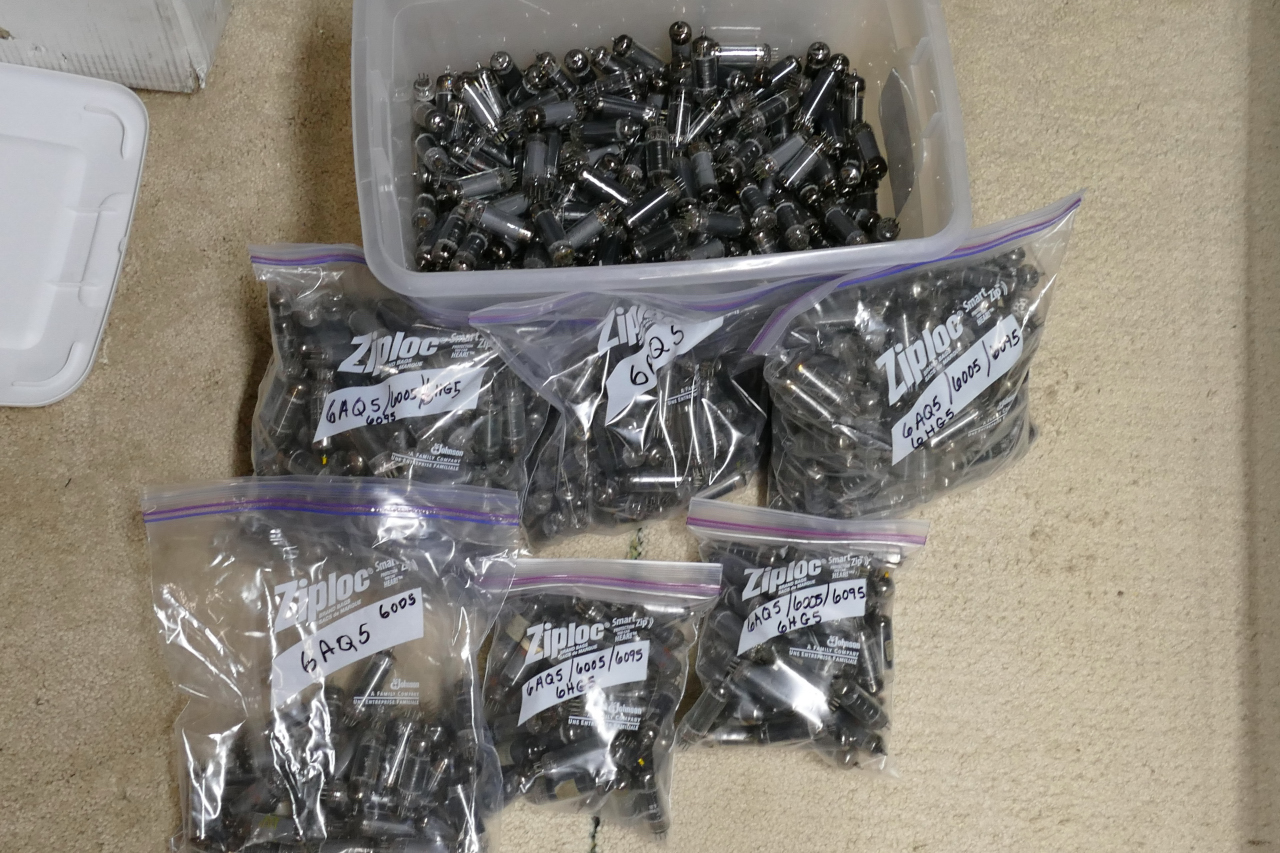

Those two boxes of mostly little tubes were headed for the sorting trays when I took those pictures. Most turned out to be 6AL5 dual diodes. I probably kept about 25 and gave the rest away. There were several hundred 6AK5's, of which I kept a gallon bag full. There were some 6AS6's too. I kept some of those too. There were a few other tiny tubes which I kept.
I drove a Honda Element without seats full of tubes to all the local hamfests, plus the two big ones (12000 people) selling tubes. My prices declined as the shows drew towards the end, and often got as low as "free." I traded a trunk full of old radio tubes, mostly the metal ones, for an electric guitar at a hamfest. I still have the guitar.
