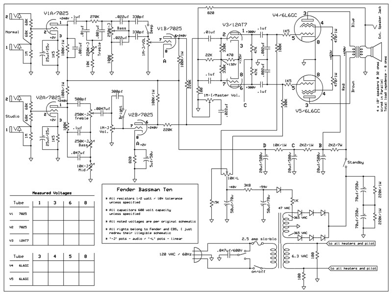

ive recently repaired a fender bassman 10 which turned out to be a faulty phase inverter valve. The amp now sound and runs ok.
On checking its output into a dummy 8 ohm load, the max power I can get from the output is around 25 to 30 watts RMS. This was confirmed on a multimeter and a scope @400 hz 110mV input as per fender instructions. The amp is rated as the 70w rms type as highlighted on the rear of the amp.
The entire amp has been checked and all voltages are in spec. Iam suspecting low valve emission. Boosting the heater to find out made no difference. From the grid input to the anode appears to give just a gain of 8 before it clips.
My question is has anyone experienced this from low output valves before I lash out on a new set.

Supplying a schematic and a set of voltages would help.Any advice would be appreciated
My current 6L6 (ok, 807) amp is designed to only produce 8W. 🙂 (OK, so most of Leo's Bassmen were PP6L6 and should make 50W. Which one?)
But a gain of eight is just wrong. What are the gains for each of the individual stages?

thanks all for your responses, I have 450v on the centre tap of the output transformer and 225v on each plate at idle. I put a 2.2 ohm resistor between each cathode just to monitor the current delivered in each valve. Idle they sat at around 35mA and just before it clipped on full output around 80mA. @ 225v gave around 18watt x 2 = approx. 36 watt total which appeared to be close to my output rms voltage squared into 8 ohm.
It does look like soft emisions. I've attached a schematic for reference. All the voltages are ok apart from I found the point between the 330k grid leak resistors on the 12AT7 phase inverter was low at about 110v instead of 132v.

You can't have 450V (DC) at the CT of the output transformer and half of that on the anodes.

Hi Chris and parafeed, apologies, by now you've probably realised ive boobed with my figures. I was quoting from the schematic which I had made notes on and for some reason posted them incorrect. i wasn't in front of the amp at the time. I did realise my mistake and I knew what the replies would be. Just one of those days.
That aside, ive done some readings direct from the amp and to be honest it appears to be ok from the valve side of things.
I have 485v on both plates, i commoned together the cathodes and measured the idle current at 39.3mA.
I then applied an input and increased it to its maximum just over 110mv which was just below the point where the output signal started to clip, the current then read 128ma. it would appear 485 x 0.128 = 62 watts rms driven through the output. This i would expect to be ok.
Where the confusion lies is the actual output across the transformer into 8 ohm only gives around 15v rms just before clipping. 15v squared / 8 =28 watts. I understand the load isn't a true impedance like the speaker, have i overlooked something in this case? even with transformer losses its a lot to appear to go missing.

....485 x 0.128 = 62 watts rms driven through the output....
DC power _TO_ the final is _NOT_ sine power Out of the final.
(And being that your 62 Watts is DC, the "rms" is not necessary, and promotes confusion.)
Clean sine class B is at-best 78% efficient. Real-world pentode amps run 50%-60%.
62 Watts DC is likely 35W clean sine audio output power. This is in-sight of your observed 28W; but 45% efficiency is lowish for a hot-rod power stage driven TO the edge of clipping.
How much does the B+ drop from idle to full power? Even 10% sag makes your numbers agree with each other better.
However the Bassman 10 is a hot-rodded 5F6a final stage (preamp different). With the crystal rectifiers and all, power rose from ~~40W to over 50W. So you are shy of where you should be.
You are half-power. Are you sure of your dummy-load? Are you sure of the amp tap? BM10 is supposed to be 8 Ohm only, but if someone has tucked a 5F6a OT (4r) in there your numbers make more sense.

thanks for the informative info, my B+ sags from 485 to 470v on full power just before clipping. All the amp looks original and is fitted with a marked fender o/p transformer. Iam not familiar with the numbers but top line shows 013897, bottom shows EIA606-921 if that resembles anything.
I think ill get a spare set of 6L6GC and compare them out of curiosity and see what the results are as I don't have a valve tester.

The 6L6 (metal envelope), 6L6G, 6L6GA and 6L6GB all have the same internal guts, which are also shared with 6BD5's and most 807's, 1625's and 6BG6's. The only differences are the bottles, bases and pinouts.
They have 19 watt plates according to the "design center" rating system. This represents the center of the bell curve for all possible operating conditions for apparatus using a given tube. Some data sheets use the "design maximum" rating system which is the worse case operating conditions for a given apparatus. The design maximum ratings are usually about 10% higher. The 6BD5 has a lower dissipation rating due to the tiny bottle and it's TV sweep use.
The 6L6GC got a plate with larger fins, grid support fins, and "improved metallurgy" increasing its dissipation ratings. Most 6L6GC data sheets also used the design maximum rating system making the increase look larger than it actually was.
The 6L6WGB is the internals of the 6L6GC with a rectangular box plate stuffed into a short bottle, originally for a military application. I have a dozen or so of these that came from military scrap, all well used. Some also carry 6L6WGB / 5881 designations. The bases of these are all quite discolored from heat, but they all work.
I stuffed 4 of them in a Chinese "100 Watt" amp head chassis that I got used without tubes on Ebay. It runs about 465 volts with a 5U4 in the 5AR4 socket. The amp works and is deafeningly loud, but I haven't measured the power yet. There are no glowing tubes in a dark room, but this is a very unscientific test since I haven't even measured the bias. I unboxed the bare chassis, stuffed 12 randomly selected tubes in it from my junk box and cranked it up!
Hi George,
You're a trusting fella! 🙂
When working on a Fender or anything close to maximum ratings for a tube, I always perform the dark room test. I don't care what the instruments tell me, I want the tube to talk to me. They opt out all by themselves. New tubes in a Fender Twin or similar always has me on edge. Only a few new tubes will take that setup. It used to be that any good branded new tube could handle a Twin, but not any more. The NOS tubes should be fine, but they often sell for silly amounts of money.
-Chris
-Chris
I always fit matched pairs of 6n3c-e Ukraine manufactured 6L6GC valves.
You will never ever get a problem with them. They are similar to 5881 but for the Military, so rugged.
Always check the anode current at idle and set as per the list below for each valve. Check the HT on the screen grids.
Anode voltages ;
6L6GC - 30W Hot (70%) Avg (60%) Cool (50%)
300V 70mA 60mA 50mA 325V 65mA 55mA 46mA 350V 60mA 51mA 43mA 375V 56mA 48mA 40mA 400V 53mA 45mA 38mA 425V 49mA 42mA 35mA 450V 47mA 40mA 33mA 475V 44mA 38mA 32mA 500V 42mA 36mA 30mA
Anode voltages ;
