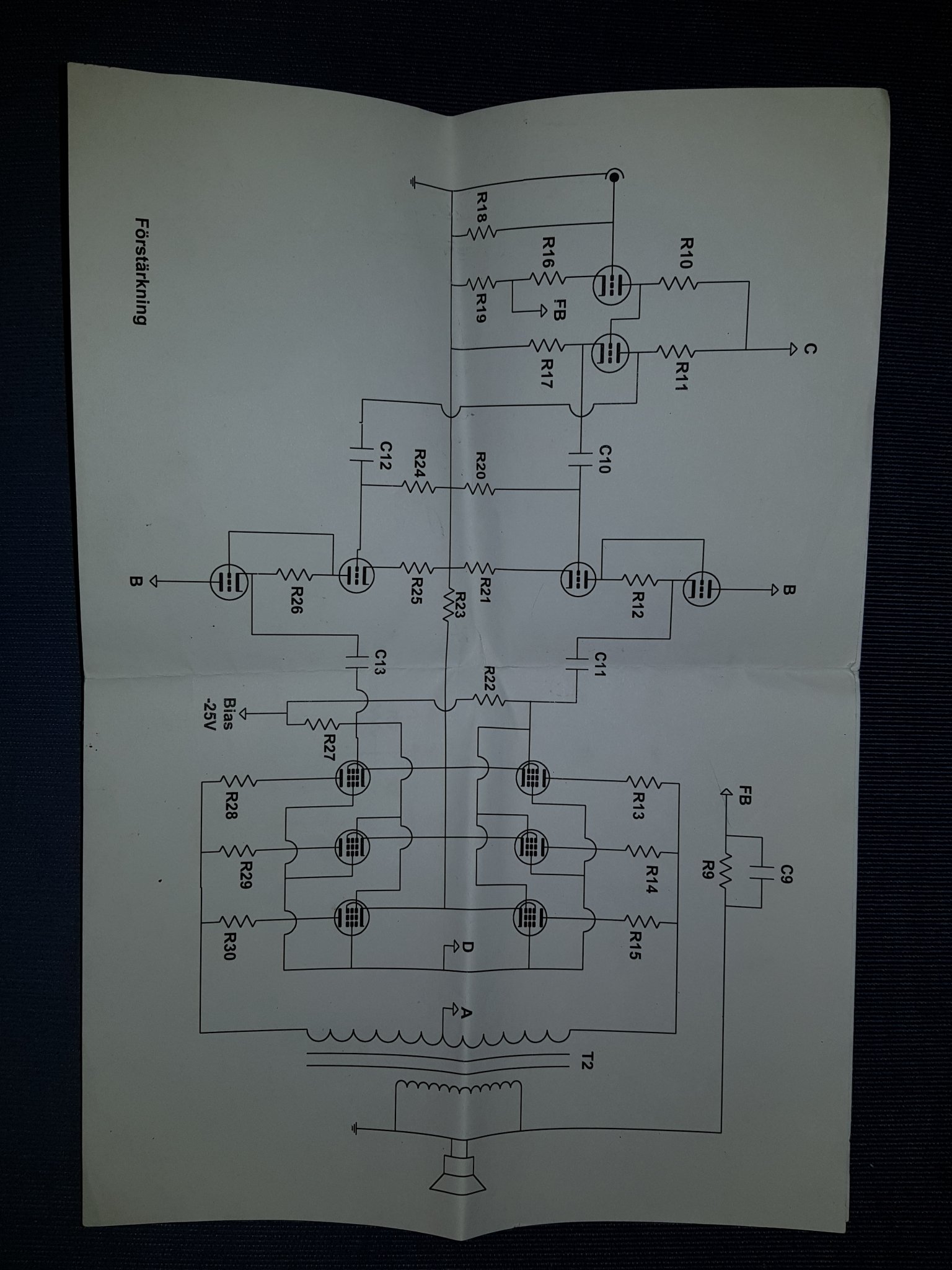

The 1650T is not very suitable for a couple of 6L6GCs, very low 1.9K primary impedance. It's also a 120W OPT, you can use a parallel push-pull arrangement, 3 tubes per channel.
With a Hammond 1650T OPT at 1.9K Ohms. Gonna take at least a parallel pair of 6L6GC on each P-P side, or switch to some big TV Sweep tubes.I have 6 pieces of 6l6gc tube and 1 Hammond 1650T OPT

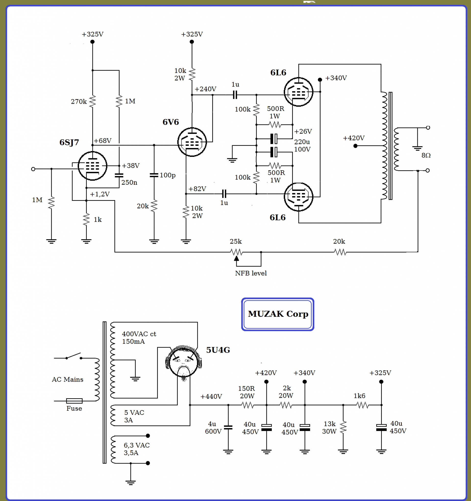

https://www.hammfg.com/electronics/transformers/classic/1608-1650?referer=790
something like this
something like this
Ketjie,
That is a very interesting simple push pull amplifier.
I especially like that 6V6 concertina with the two 10k resistors.
(and I do not really like almost all concertinas).
That dominant pole, the series 270k pentode load, 100pF cap, and 20k to ground is also interesting. It is at about 5.5kHz.
OK, the frequency is a very little higher than that, because of the 6SJ7's parallel plate impedance, rp.
However, the B+ documentation does need some work, to make it correct.
400VCT and a 5U4G rectifier does not put out 440V B+.
200Vrms x (Root(2)) = 283V peak, and then there is the voltage drop through the 5U4G.

The post #6 schematic is most likely running with those mu follower drivers for high power output with 450V B+.
The output tubes don't have individual bias controls nor current measuring (or distributing) cathode resistors. That design will need matched tubes to distribute the plate currents evenly. And periodic tube removal to monitor long term current matching. Measuring idle current across the plate resisters is not recommended, unsafe. Also, even matched tubes don't guarantee even current distribution at all current levels (needs unbypassed individual cathode resisters).
It presumably has the plate resistors on the outputs to avoid parasitic oscillation between the tubes, but you will want a HF oscilloscope (and individual cathode resisters to measure currents) to verify that is working for each set of tubes used. This doesn't really qualify as "simple".
Do you have matched 6L6GC tubes? Do the mu follower tubes have sufficient heater cathode V rating to handle maximum drive signals? Do you have a high frequency capable Oscilloscope?

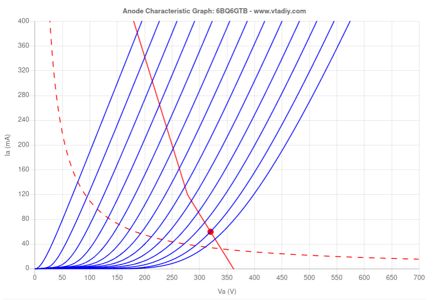

I'm running one amp at 30mA using 12AV5GA and it's great. I'm running one at 60mA with 12GT5, and I'm running 100mA - 120mA with 6P45S. Also 80mA with 6P36S.
The 12* amps are running with 1k4:4R ratio, the 6* amps are running 650R:4R. The ratios can also be set for 2k5:4R and 6k:4R.
The calculator at VTADIY shows this for the load line for the 1k4 output version.
It looks like a very bad match but it isn't - the Pd is higher than stated on the datasheet for audio.

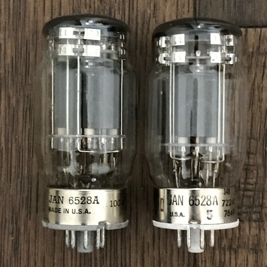

If you want triode, you just need a pair of these to drive 1900 Ohm. Maybe even a single bottle 6528A or 6336A would work (being dual triodes).

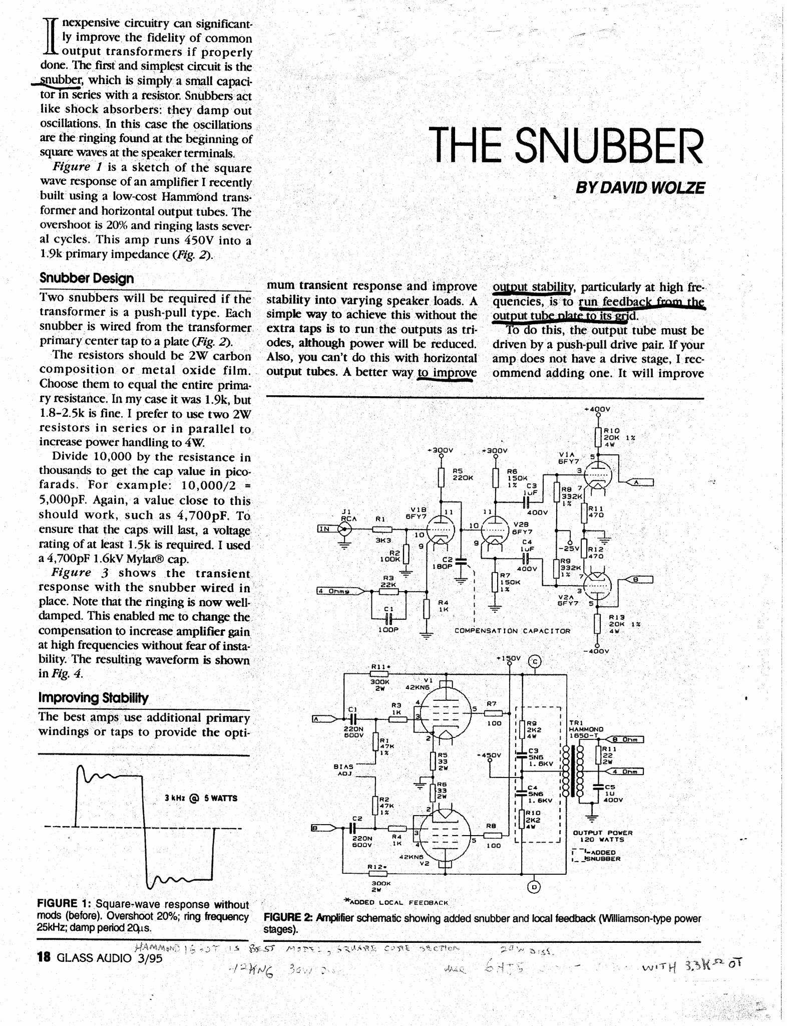

There is a simple Amp using the Hammond 1650T OT and two 42KN6 tubes, with two 6FY7 , 4 tubes total, from Glass Audio 3/1995 pg. 18
It's actually a Williamson type design with local Fdbks, so should be low distortion.
Here is the 1st page schematic from Glass Audio 3/95 pg 18. Check Glass Audio for the whole article.
Whether or not using this schematic, the snubber network could be useful for the Hammond 1650T OT in other schematics. (the final square wave overshoot with the snubbers here was less than 1%)
I would consider possibly moving the 300K local Fdbks to the UL taps, along with the RC snubbers. Since the UL winding is usually more closely coupled to the secondary than the plate taps.
Readjust the R values for the 40% reduced voltage at the UL taps.. The high impedance plates can drive right thru Xfmr leakage L (out at the plate taps, where it is worst) transparently then. It would need some checking for stability due to possible phase shift at the UL taps. If unstable, then a tiny cap from points A and B to the respective V1, V2 plates could restore HF phase alignment.
A set of 6HJ5 tubes could replace the 42KN6 tubes to go cap-less. (If you can still find them, they were very popular in Pete Millett's Engineers monoblock Amp.) Or 3x 6L6GC parallel.
This could be like a "poor mans" Citation II then. Williamson with local Fdbks.

The 6HJ5 tubes would be more optimal with a 2.5k, 2.7K or 3.3K P-P OT. They are rated 280 mA DC versus 400 mA DC for the 42KN6s.
(6L6GC are rated around 110 mA DC )
