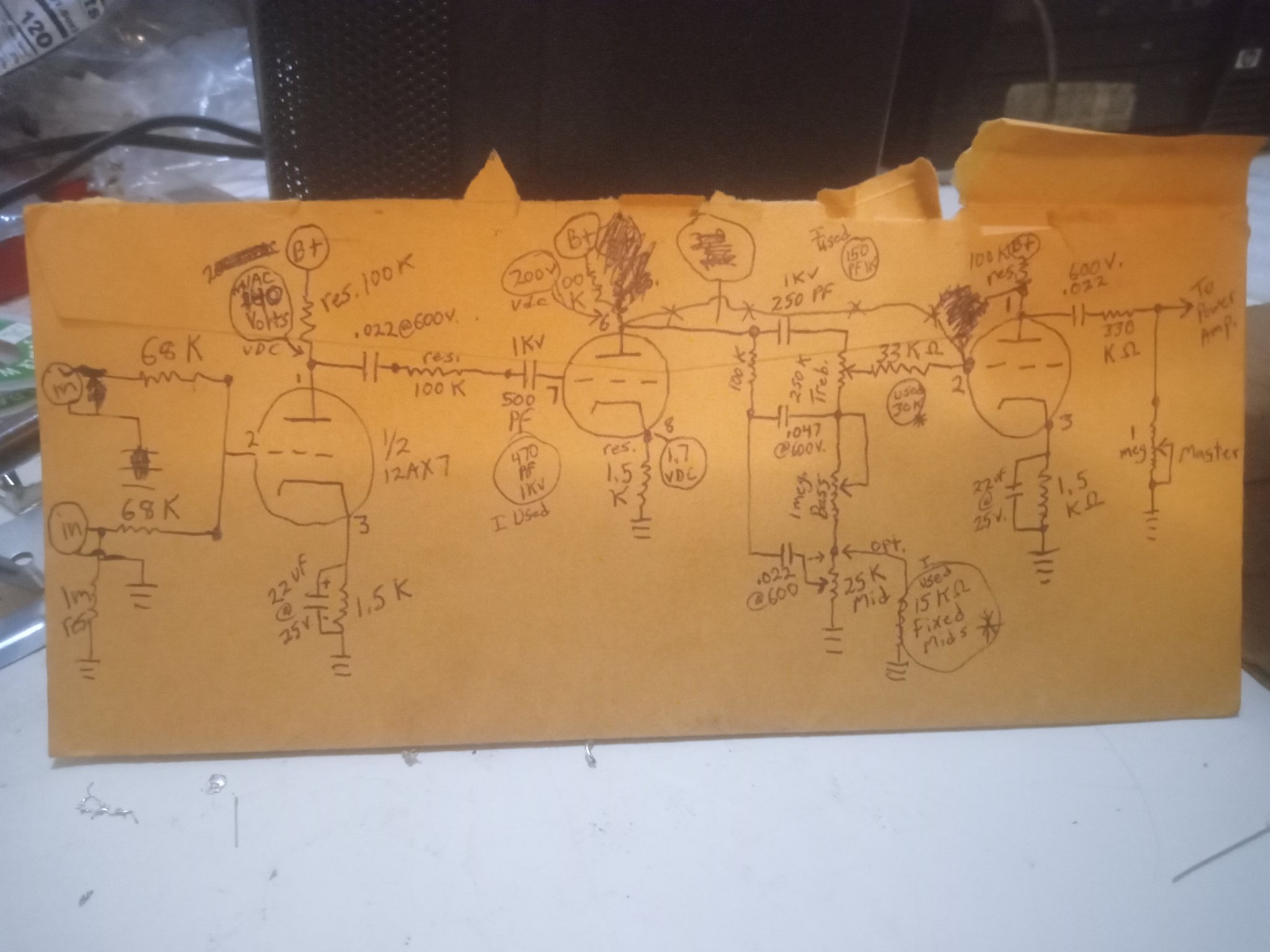

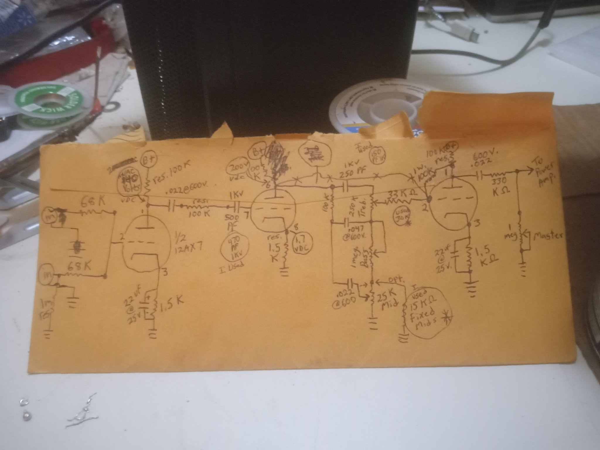

E ejp Member Joined 2007 dadaelectronics.com.au 2024-07-20 12:31 am #41 2024-07-20 12:31 am #41 Yes, you are missing a proper coupling cap across the tone controls. 0.1uF.
