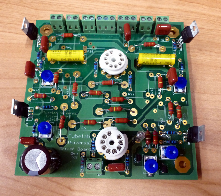

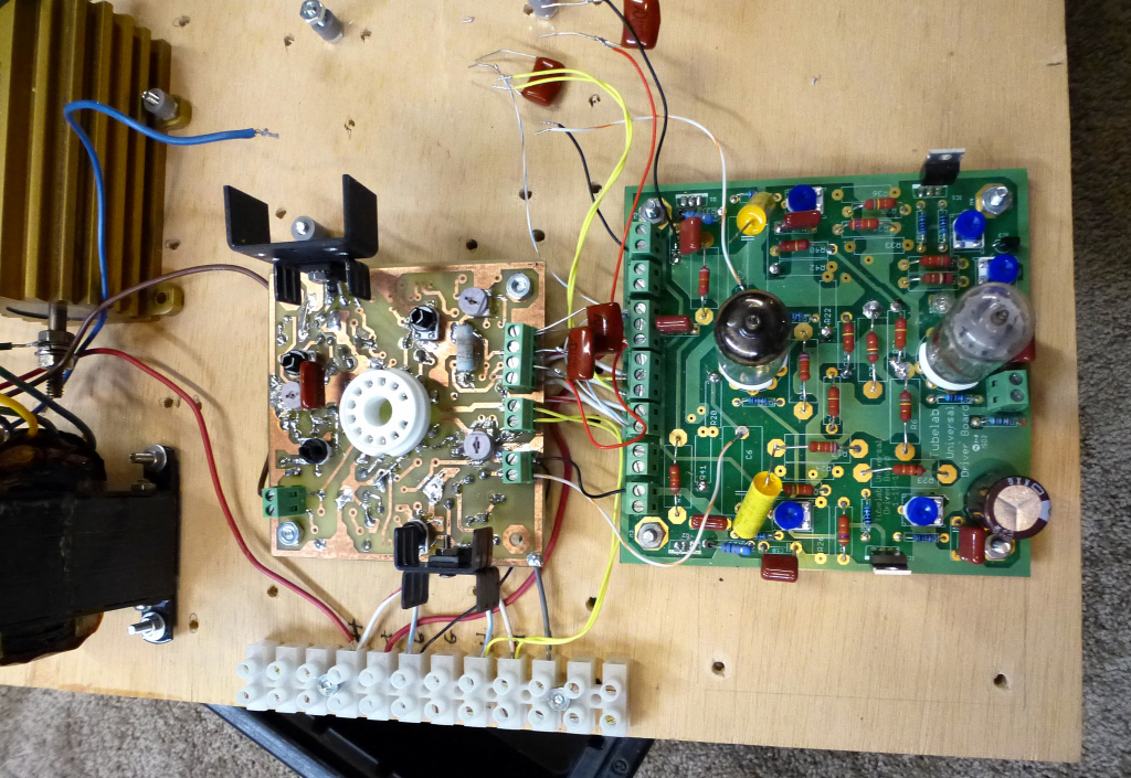

A lot has happened since this thread was started. My engineering career of 41 years came to an end, the facility has been sold and is shutting down. I had to move all of my stuff, plus Tubelab twice in the past two years. The first move was on rather short notice, and covered 1200 miles, so a lot of stuff was sold, given away, or trashed. I have recently moved into the house where I plan to be for the next 20 years, but it will be a while before a new lab is finished. I started with an empty 2000 square foot basement, so I have a long way to go.
While I was in the temporary housing, I laid out a PC board for the driver section of this amp. I also rebuilt the old breadboard I used for designing this amp.
The 5 year old design is solid, and the only changes were to replace the LED's in the offset adjustment circuit with TI voltage reference IC's, and I changed to 9 pin tubes (6CG7's) to make the board smaller. I got a batch of boards made and they should be available from the Tubelab web site sometime next year. I plan to build a few amp designs with these boards and document everything first, but I need a workbench for all that.
Here is a picture of the board, and my new breadboard. One of the output boards is missing because I blew it up trying to squeeze too many watts through too small a tube! It was a TV sweep tube experiment.

The resistors connected to the FB1 and FB2 terminals allow for plate to plate feedback. They will be connected to a similar set of resistors on the output board. Multiple series connected resistors are needed due to the voltages present on the plates in big power tube output stages.....over 2KV! If you don't need this, just leave them out.
I usually set the current through the CCS's for optimum distortion at the output levels I need for the project.
Thanks George. Have you ever measured the distortion for the driver board open loop? Particularly h3?
I've been playing with this topology (LTP into LTP) myself for some years now. After trying many combinations I've reached some of the same and some different conclusions :
1. I still like the topology but it's not a slam dunk. I've had to work at it very hard to do better (distortion & gain wise) than a Williamson I built and optimized over the years. My goal for this type of driver is <0.1% THD at 35Vp out with a gain of >x200 and h3<-75dB. That's doable but not easily. Open loop of course.
1. I found that for optimum distortion with most tubes of interest, I needed operating points that wouldn't allow DC coupling unless I use a very large B+for the second stage. Or some form of level shifting.
2. I found that distortion, particularly h3, tends to be high for the 2d stage. You can pick at it changing tubes and operating points, but I haven't found a major cure.
3. I found that I get best distortion performance from triode-strapped high gm pentodes.

I haven't made a distortion measurement on the new board since my new lab is still under construction, and far from done. I have moved twice since leaving Florida.
I like this topology for many amps, particularly those made with typical audio tubes in triode, UL or Pentode. I made a 3 stage version with triode 6550's as the 3rd stage and a big CCS in the tail. It sounded very nice but only made about 20 watts. 300B's or 45's in AB2 push pull sound good too. No feedback used in any of the triode amps, none needed. Some GNFB or plate to plate feedback was used in the pentode amps.
My other driver of choice is a single pair of pentodes in LTP with some silicon based tricks to raise the gain and lower distortion. These sound more dynamic when used with tubes that have huge current carrying capability, like sweep tubes.
I think I was around 0.25% THD measured at the source of the mosfet while driving the grid of a 300B at the edge of clipping. I had to run through a dozen or so 6CG7's and play with the trim pots to get there, but all of my tubes are well used pulls from military spares that were being scrapped.
