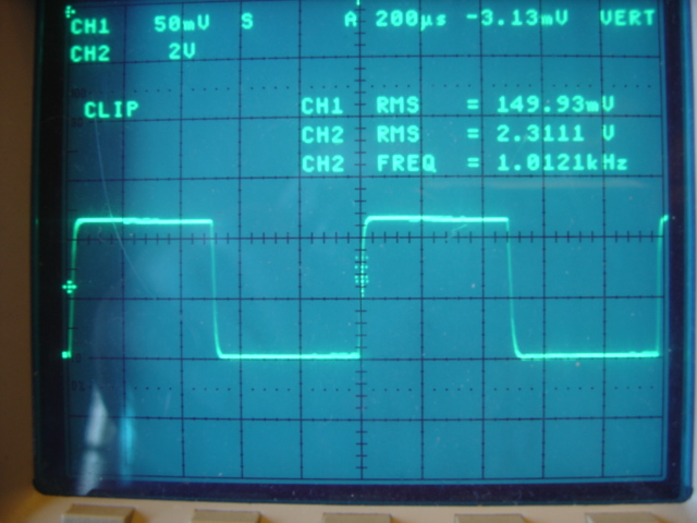

Finished the output tube wiring this morning. I wired it triode mode, strapped with a 470R resistor.
Brief problem with oscillation. Was oscillating at some combinations of volume and frequency. No problem with output tubes removed, so took a guess that it required some grid stoppers. First thing I tried was some 680R carbon comp right on the grid pins of the output tubes. It appears to have solved the problem.

I had to solder the mosfet source and source resistor directly to the socket in order to keep oscillations away on my AB2 KT88 amp. I probably should have mentioned that to you earlier. It pays to minimize lead inductances if you are going to forgo a grid stopper (which is necessary for low distortion AB2).
Here is a snap of the square wave before fixing the oscillation. I think tnis one was at around 1kHz.
Uploaded with ImageShack.us
Here is a sine wave with the oscillation (now fixed):
Here is the output from each phase of the input stage:
Here is the same inputs (each phase of the input stage) with the 'sum' function of the scope, with the same scale. Note a little distortion:
If there are any tests I can do with the limited equipment available, I am happy post the results for you.
Chris
Lets see some squarewave pics at 1kHz, 2kHz, and 10kHz at 1Watt with the osc corrected. Have you calculated / measured open loop gain? You can also use ferrite beads per George's recomendation to stomp out oscillations when grid stopper are troublesome, as in AB2.
I am just now getting audiotester to work well enough. Using Pete Millett's sound interface REALLY helps, but you can get some close measurements without it as long as you are carefull of the soundcard. Or are you using a MAC?
In my OPUS I also saw some tilt on the squarewave, initially. It is a low frequency roll off issue. Part of my problem was the input cap was to small for the impedance. I also lowered the impedance of the RC decoupling on my bias circuit. I don't think you have the later. Even still, I have a hint as seen in the attached photo.

OK, so for the oscillation, try to shorten the leads as much as possible, and use as small a resistor that works? Re-locating the MOSFETs would require a lot of re-work.

Well, as for the oscillation, I tried just about everything. I tried placing the MOSFEt right next to the output tube with a very short lead, I tried 100R plate resistors, then with the air core inductor wound around the resistor. I tried grid stoppers and ferrites, all to no avail. In the end I noticed that the oscillation changed when I touched my signal generator. I have a BNC T junction on my battery powered signal generator. One connection to the scope, the other to the input RCA of the amp. I removed the T connector and tried just connecting the signal generator directly to the amp and using a scope probe at the grid of the first stage to detect input signal. Oscillation gone. I removed all the stoppers and left the MOSFET close to the output tube. Appears to working OK now.
