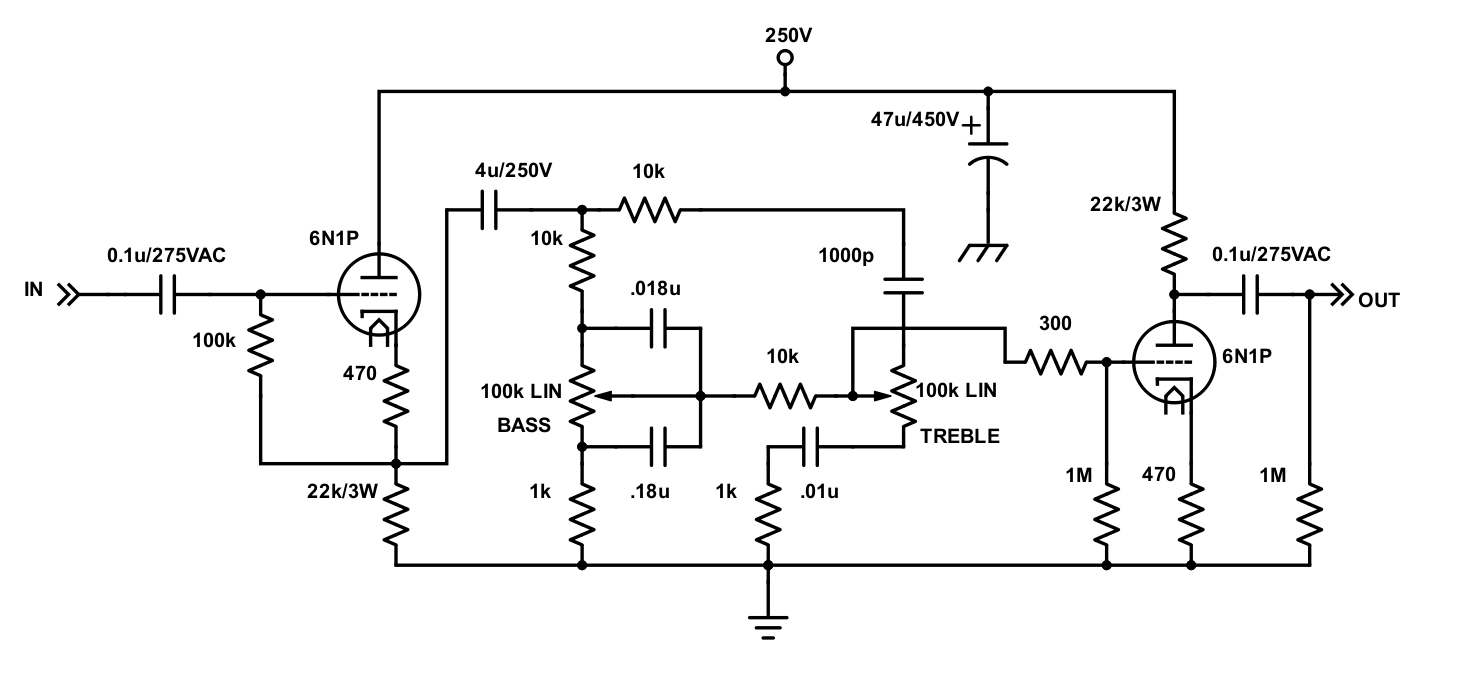

I built this... It's a typical bass/treble control. It can be inserted between the preamp and the power stage.

For hifi tone stacks, look at baxandall types. A quick Google search of this forum will show a bunch. It's pretty flat when in a neutral position.
The link kodabmx posted is a great resource, and I'll add this one-
Baxandall 2
And this one-
DIY Audio Projects Forum • Baxandall circuit
You can also download the tool from Duncan amps, that lets you play with different tone control schemes, and see the effects of different parts values. Good for figuring out how to use "parts on hand" or for limiting the range to areas you want to control. They also have the PSU designer tool, which every casual tube gear builder should try, it's really useful! Software
Personally, I haven't found tone controls to be of much merit for most builds, unless it's for a dedicated subwoofer amplifier, baffle step correction, or for some really weird room correction scenarios. When I build for people that want tone control, I use the baxandall. It's a pretty good circuit.
One last word from personal experience on the 6L6- unless you listen at pretty high power levels, you won't use that triode switch very often. When I've built similar amps I found that I usually preferred triode connection for all but party SPL! Triode mode rocks with the 6L6 types, especially with a smidge of GNFB to pull the damping factor in nice and tight.

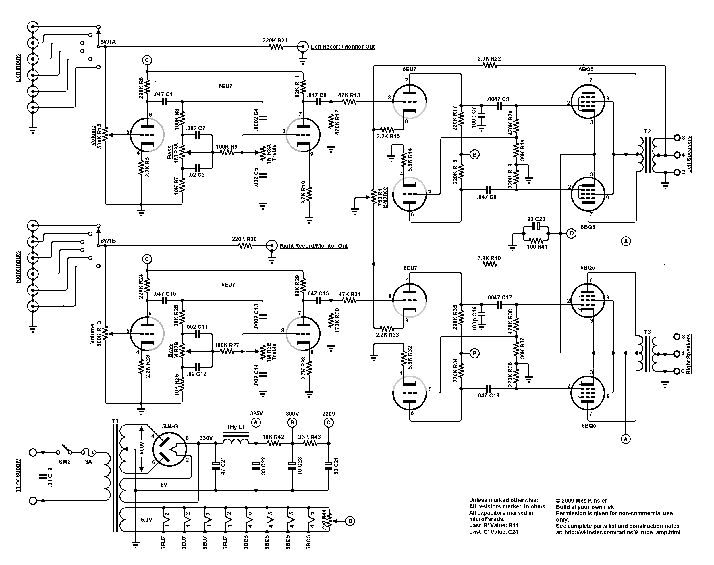

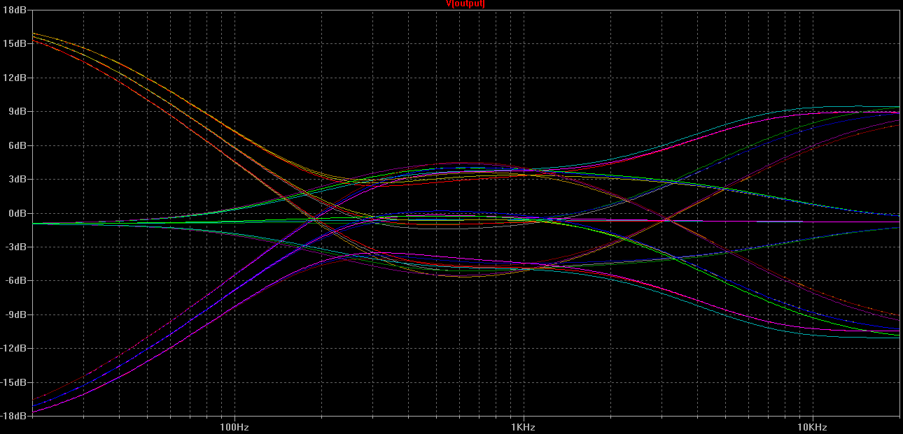

Hi , used the Duncan tone stack simulator tool to fine tune the 6gk6 (6bq5) stereo build and it works a treat when making adjustments because of transformer / component / tube nuances ....
The original build had too much vocal frequency coming through ,1-3 Khtz range and it just wasn't pleasant listening.....but the tone stack simulator was a blessing
The 6gk6 build incorporated a baxandall tone stack and worked well ... I used 12au7 instead of 6eu7 / 12ax7
Its looking more like I will use the same schem for the front end.... and another for the power tube section
Many thanks for the advice , I found the notion that 6l6 in triode mode has more than enough volume ....I listen to just about everything but like it loud ...especially jaz / rock fusion..
Still hoping someone has a schematic to offer though...

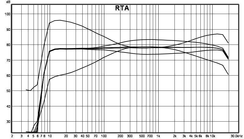

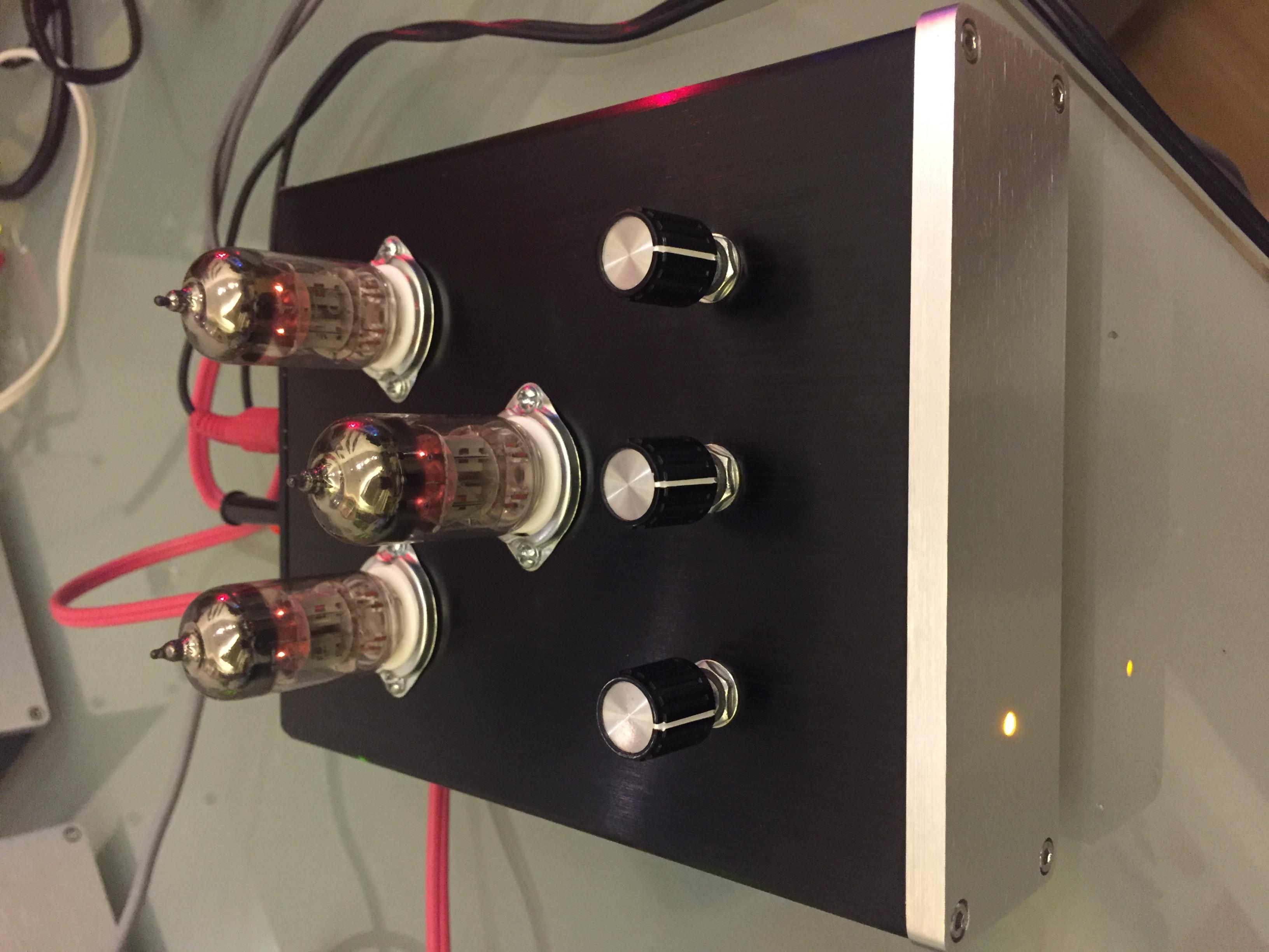

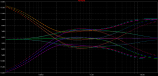

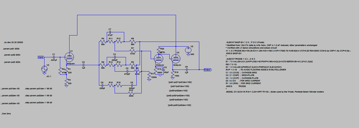

Hi to everybody here, I just finish to build a tone stack bass/mid/treble that can be add to any tube amp or solid state as well, I am using it with external solid state dual power 240VDC + 6.3 VCA, so the two channel are completely independent, the original schematic was suggested by a link from "Kodabmx", from the original schematic I just change the fist stage because I used in this project all 6N2P-EV instead of 12au7 and 12ax7. The result is very good and I really like it, I also make a simulation with LTSpice prior the building and was already impressive, compare to my previous tone stack following the RCA schematic this is much better, also because the adding of mid tone control, but what I really like is when the three pot are in the middle the frequency response is absolutely flat rather the RCA where I cannot have a really flat response, so I am posting here also the simulation and the real frequency response take with an rta, if somebody is interested I can also give the LTSpice .asc file of the project.
Best Regards to everybody.
