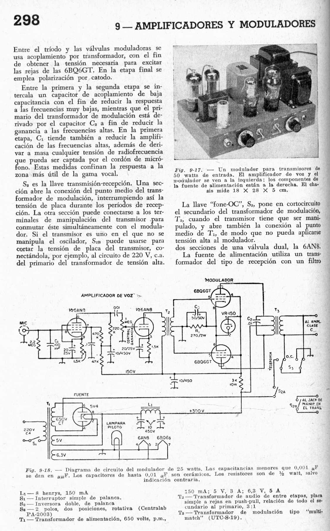

After doing the Vixen design, I happened to come across this Portuguese (Brazilian?) article (attached) describing this plate modulator. That's where I got the idea for the Le Renard project, and then it became clear why the Portuguese (Brazilian?) hams went with 6BQ6s where you'd normally expect to see 6L6s. Open loop, they sound better. None of the irritating harshness of the 6L6-oids, just an overly "aggressive" or "edgy" sound. All they need is just enough gNFB to take the "edge" off. Included variable gNFB so's you could dial in more edge for Techno and Power Metal, more softness for Andre Rieu or Karen Carpenter.

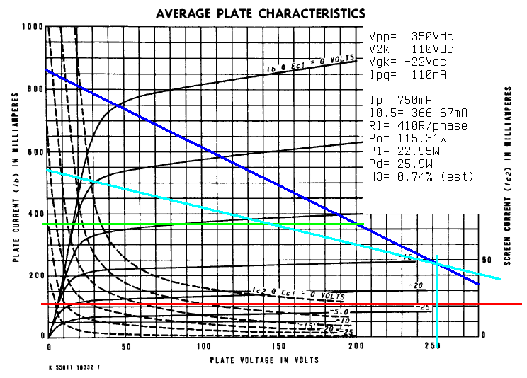

I have a bunch of these 36LW6s, but prefer to run 'em a bit more conservatively. They'll need custom OPTs ($$$$). I can do my own PTXs, so the 36V heater power won't be a problem. 115W is more than enough, considering that the Vixen's 30WPC gets the neighbors complaining if I crank it.

Frank's has a spec sheet that gives the pseudotriode plate characteristics: 6L6 It doesn't give any operating points, though, so you'll have to do your own loadlines to determine what's a good plate load. As for how that'll sound, that's something I can't say since my design was pentode mode. Once you get the NFB connected, they sound great. I'd guess pesudotriode operation would sound better than open loop since pseudotriode basically means max lNFB. You still might need some gNFB to take the 'edge" off. That comes down to try and lhear.
Definitely include screen stoppers since the 6L6-oids like to make snivets.
