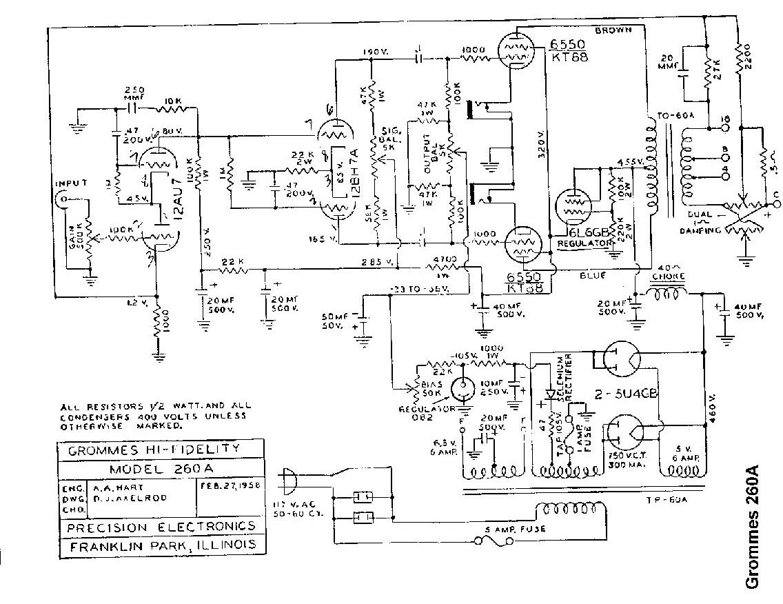

The technique I used for this came from a friend and master-engineer (Al Hart) in Chicago, who designed all the "Grommes" and "Precision: amps in the early Hi-Fi revolution. This was simply an "emitter follower regulator" which for convenience and affordable performance was a standard (inexpensive at the time) glass 6L6.
The Grommes 260A schematic is one of these amplifiers, 6L6 pass tube looks very similar.
Yes, this is the reason to regulate the screens. It makes the amp more linear. Subjectively it makes the amp sound more powerful. Once I started regulating the screens, I never went back. In this amp, I think the the 6L6 is the active device in a capacitor multiplier. It is not really regulated (even though it says "regulated" on the schematic). A tube is going to be much more rugged and forgiving than solid state, especially for a guitar amp. I have personally not blown a Maida regulator in my amps. Start up is not a problem. The voltage ramps up and the regulator stops at the desired voltage. I think Barf has a sound plan. I hope you post follow-up.

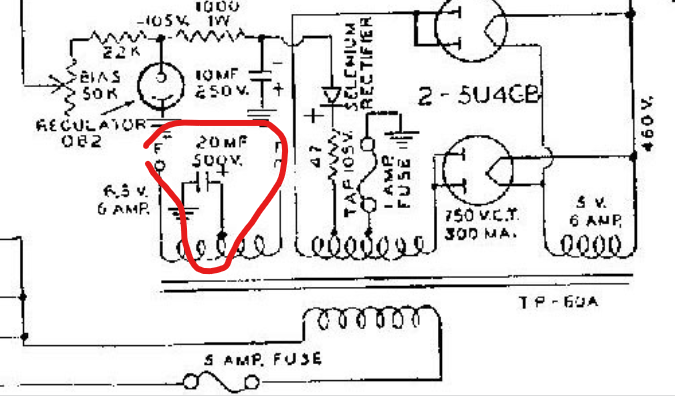

Does that capacitor on the heater winding center tap change anything wrt cathode to heater voltage?The Grommes 260A schematic is one of these amplifiers, 6L6 pass tube looks very similar.
Yes, but not by much, and it's debatable as to whether it's a good idea to put a capacitor there.

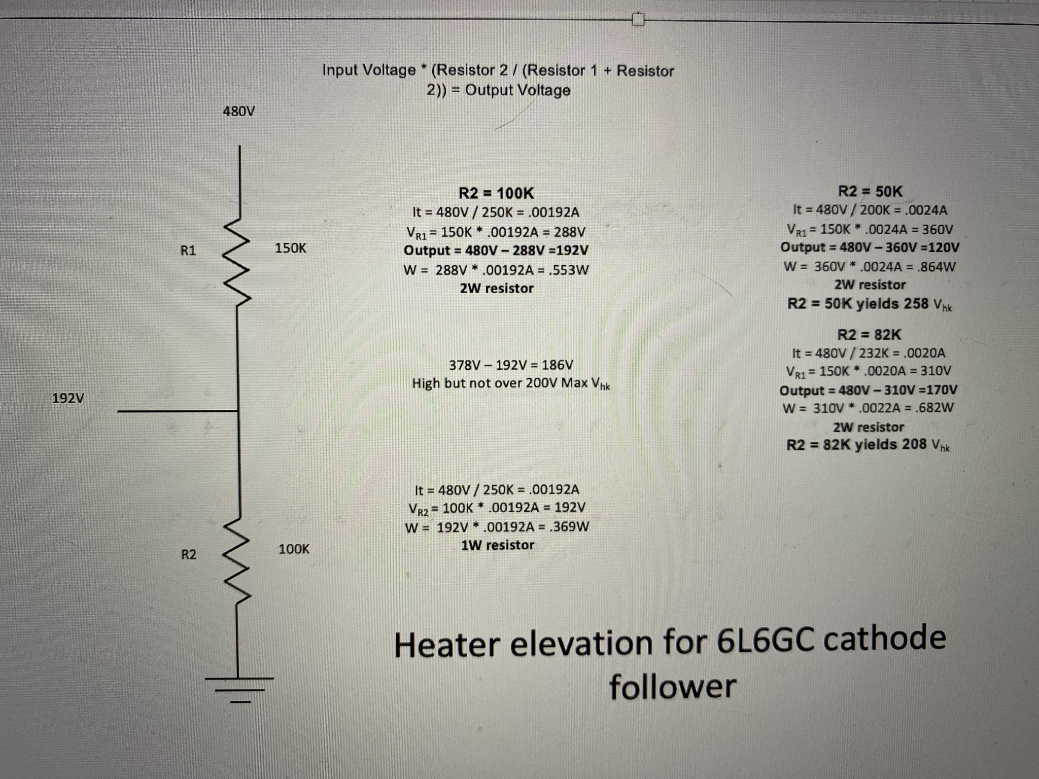

All the parts have come in for the refurbishment of my Compactra, including a 6.3 VAC transformer for the 6L6GC cathode follower. The tube has 378 VDC on the cathode - way over the max heater to cathode voltage. Some say just leave the Vhk voltage alone as it has worked fine (as far as I know) for decades. The elevation voltage level would have to be quite high just to get the Vhk barely in spec. 90 VDC is about the highest elevation voltage I have ever heard of. Would almost 200 VDC be too high? My voltage divider math is attached. Thanks

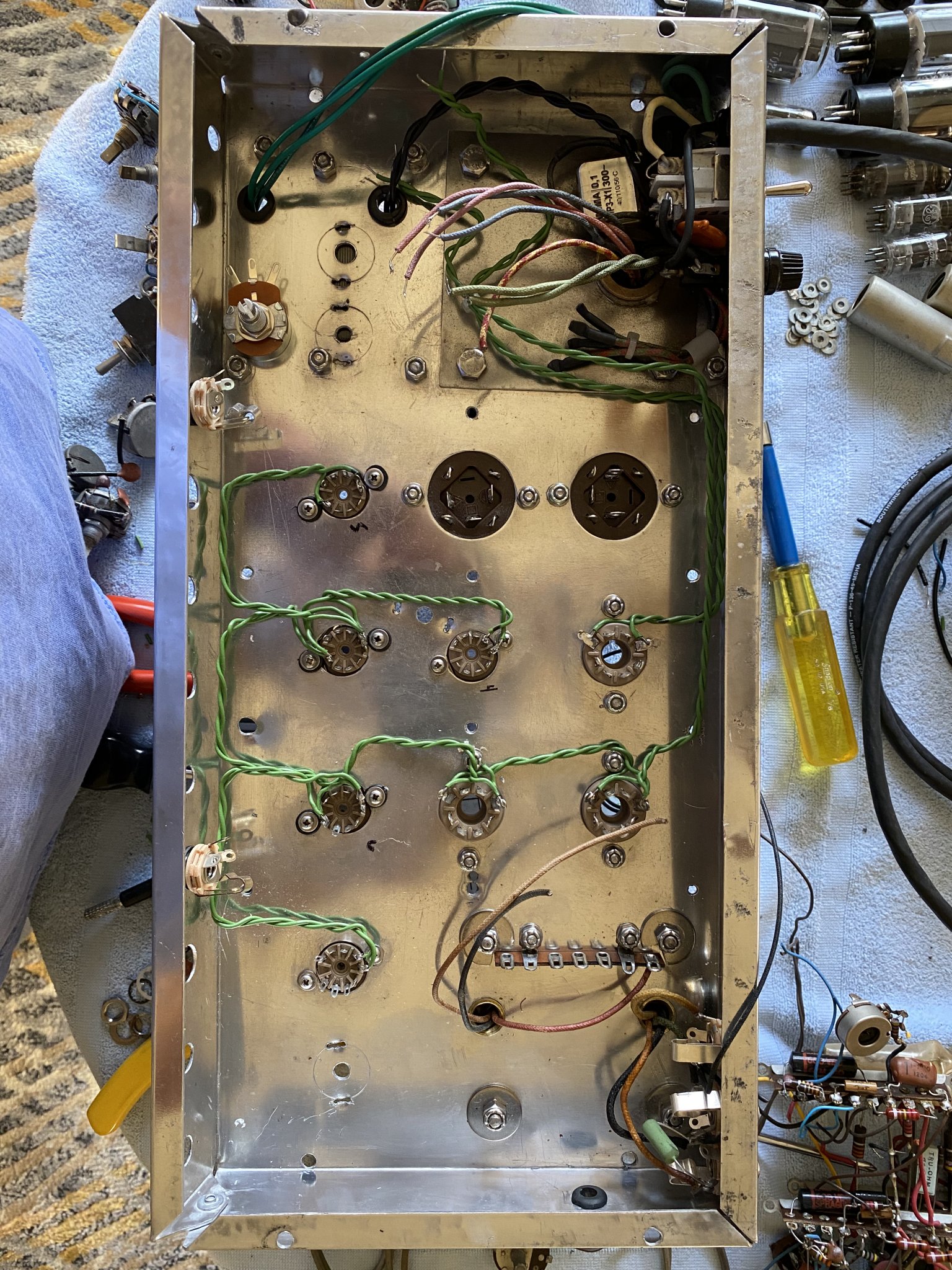

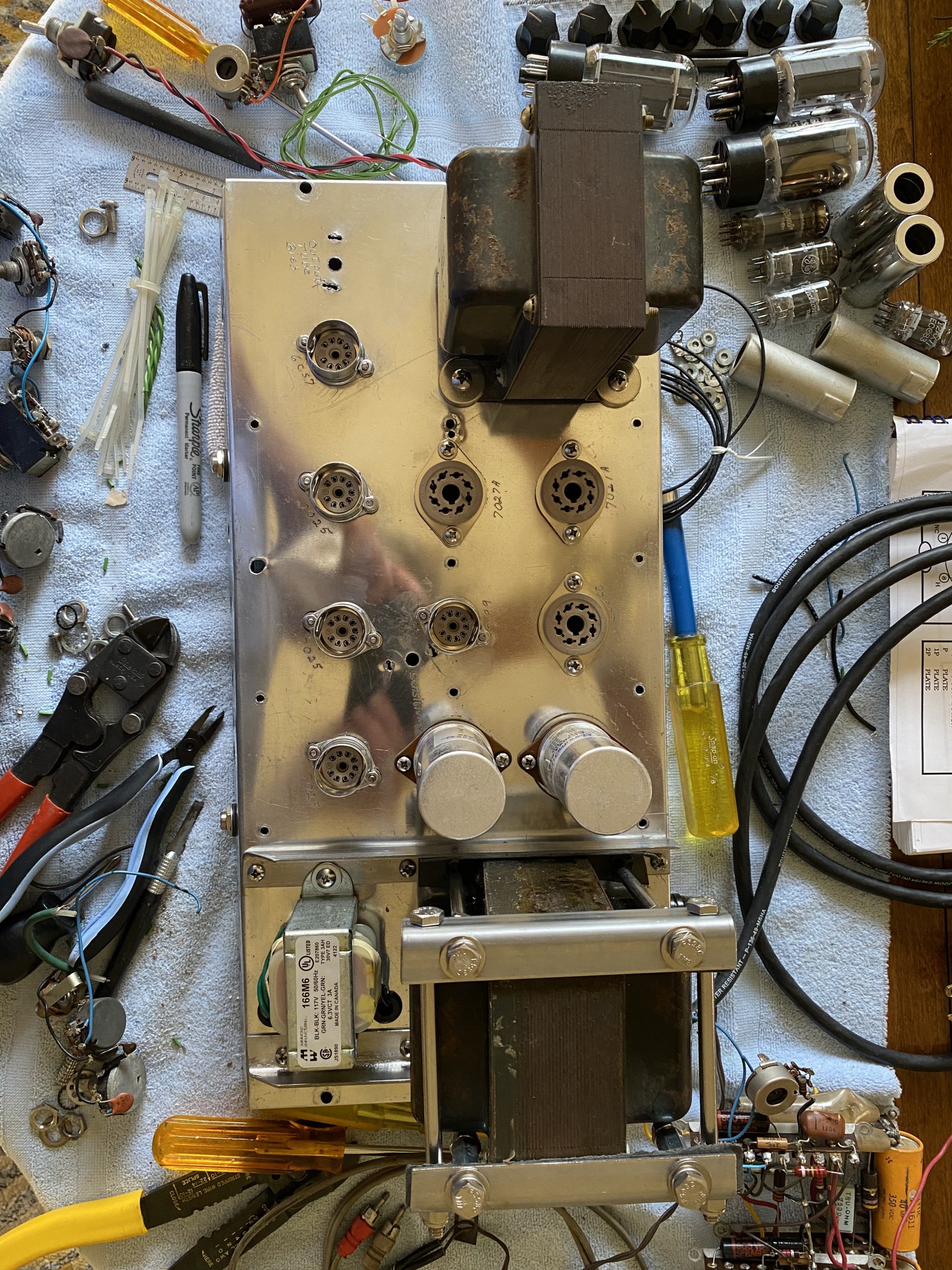

Just a quick update. Progress is slow but moving forward. Several decades of dirt and corrosion removed. First pic shows new three wire power cord, inrush limiter (look close), new caps, new tube sockets, heater wiring and output jacks w/ 360 ohm protection resistor. Pic two is top view of chassis. Beefed up power transformer base w/ angle pieces due to its weight deforming the chassis. Added smaller transformer for the 6L6GC cathode follower heater voltage. This thing is heavy and w/ a 15" speaker it makes for a back breaking combo. May have to convert to a head unit. Front panel refurb next.
Looking good, but I would have been tempted to fit those octal sockets so they were under the chassis. Did they not fit? Also, from an aesthetic point of view, the noval sockets could have had the nuts under the chassis, like the octals? Or was there a space issue?
I've to say I prefer the sockets on the chassis, not under. I had the choice when I built my amp and for some reason sockets on top looked better to me.
A keen eye you have there, OldHector. It gets tight inside the chassis which is why I, like the original builder, set the octals on top of the chassis. Eventually I will have to bend over the octal soldering tabs for all to fit nicely. On the nine pin sockets some of the solder tabs came awful close to the socket mounting lock nuts, so I switched them up. The original builder used pop rivets to secure the sockets, and there seemed to be a lot more clearance. On the power tubes I kept the lock nuts on the underside of the chassis for better tube base clearance. Thanks for double checking the layout. It's good to get other people's opinions that may result in a better way to do things.

As for H-K voltage... put a large resistor from heater to cathode - H-K voltage will be zero.
