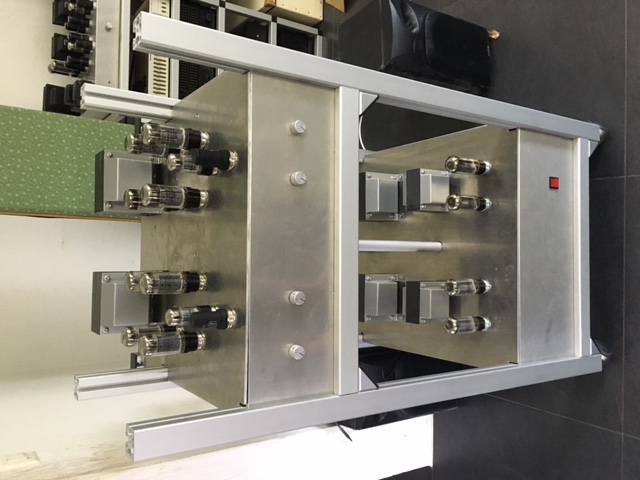

Dear all
i have nearly finished my 6L6WXT+ project, see attached pictures and schematic.
One side of the stereo amp works properly, the other is making an extremely high frequency tone (on the edge of my ability to hear). This tone comes up when the volume poti is turned up, with no signal attached (the same happens too when there is a signal). The tone is increasing in intensity with volume turned up and decreases and disapears with volume turned down. When the tone appears and the volume is turned up higher, the 6L6WXT+ tubes on this side of the amp start arching (not always the same tube, it happens randomly).
Unfortunately I have no scope to detect the source of the tone.
But it does not appear when either the 6SJ7 tube is being removed (and the rest stays) or the 6SN7 tube is removed and the 6SJ7 and the quad stays inside. But at the same time, moving the 6SJ7 to the other, working amp side does not bring the tone over too.
I therefore assume that it is no the 6SJ7 tube itself (or the 6SN7 tube).
What I haven't checked untill now is moving the 6L6WXT+ quad to see whether the tone is linked to these tubes (which could probably be too when one is somehow defective).
The 6SJ7 has approx. 180V on the plate and 80or so on the screen, the 6SN7 has 250V on the plate.
The 6L6WXT+ tubes have 500V on the plate and 440V on the screen, negative bias with 20mA per tube (measured across the 1R cathode resistor.
Does anybody know a possible cause to this very high frequency tone with unknown source which seems to be amplified by the 6SJ7 voltage amplifier, then passed on to the 6SN7 phase splitter, and to the 6L6WXT+ quad? The tone appears with no cable and no signal attached to the input socket.
Thanks for all replies.
Thomas

Looking good there, Thomas.
Try maybe a 10K grid stopper on the 6SJ7.
Also, you may be nearing or at the onset of HF instability due to the characteristics of the output transformer and the amount of feedback applied. You may need an additional network to reduce HF extension of the amp around the feedback loop. That typically looks like a cap in series with a resistor from the plate of the 6SJ7 to ground. If you need this, start with maybe 100 pF + 10K and adjust from there. The exact values are kind of important to get right. You would normally use a scope and signal generator to test for HF stability under various speaker loading conditions, and to find those proper component values.
Try the grid stopper first. See what that gets you.
How much feedback is applied?
Also, if you made the upper cathode resistor in the 6SJ7 stage 2.2K, and the lower cathode resistor 100R, you could probably do away with the 100 uF/50V cap in the feedback loop. A 10K FB resistor relative to 100R in that voltage divider is 1%--it will be negligible in skewing the bias of that stage. But that means you'd also have to adjust the FB resistor size to keep the same level of feedback, and perhaps adjust the FB capacitor slightly also to keep the same HF characteristics. I'd have to put pencil to paper to figure out the new resistor size to keep FB level the same, relative to a 100R resistor in the FB voltage divider.
Hi kward
I have an adjustable negative feedback on the 6SJ7 cathode, using a 1k8 resistor and a 500R bournes poti, giving a total of 2k3 on the cathode.
The high frequency tone appeared with no feedback applied (or maybe 5R or less, poti at Minimum), and it only appears on one of the two mono sections (the amp has 2 identical mono sections), the other section works properly.
All resistors have been checked, all caps are according to my schematic, so the cause should exist in both sections. It does not, so this means I am somewhere in the edge to encounter a high frequency tone, generated by my Set Up.
In the good side I can turn the Feedback up to max and back to min at full Volume without any HF tone.
I will try the grid stopper first and see what happens.
If this does not help, the next step will be the HF ground in the 6SJ7 plate.
Thanks in advance.
Thomas

Hi DAK808
It is made of Industrial Aluminium profiles for automation purposes.
I bought the parts from a German company specialized in supplying these parts customized.
The panels are 8mm Aluminium and the lids and bottoms of the compartment are 6mm.
The whole chassis weighs about 45kg, and the rest including the transformers another 45kg.
All in all heavy enough to ensure that my wife does not through it out of the house.
