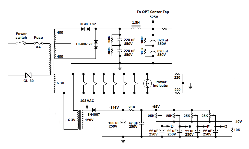

Because you're using a 400-0-400 secondary, it will deliver about 560V DC unloaded. So to obtain the voltage rating on the power supply filter caps you will need, it is customary to "stack" capacitors with voltage equalizing resistors between them. The example below shows two 350V caps stacked vertically, so the voltage rating is doubled to 700V, but the capacitance is halved, to 110 uF.
Also the example shows how you would do silicon rectification in this setup. If you use standard 1000V PIV diodes, two UF4007 diodes connected in series per leg of the output transformer will be needed, because of the use of the 400-0-400 transformer, it will create about 1200V difference between the anode and cathode of the diode.
The Hammond 378CX does not have a bias tap off of the high voltage winding, otherwise you could just use it directly for your bias supply. Since it is not available, you will need to obtain the bias voltage from some other means, such as another stand alone transformer. You need about -42V delivered to the grids, which means you need at least (say) -60 VDC raw bias voltage so that you can filter down to -42V. So, you could just purchase a separate small transformer with a 50V secondary. Almost no current will flow, so pretty much any transformer that delivers a 50 VAC secondary will work. But anything between say 50 VAC and 100 VAC secondary will work just fine.
Here's an example that puts all of these ideas together. This is only one of many ways to do the bias supply. Note in the case shown in the example, I used a small filament transformer run backwards to obtain the bias voltage (because it was inexpensive).
(Side note: Above about 30 watts output, you can see that things are necessarily more complex.)
Edit: I typed most of this before I saw your last post. You could obtain the bias voltage the way you are showing by tapping off of one leg of the high voltage winding. Some refinement of that approach would be necessary though. Personally I prefer the stand-alone filament transformer approach, but that is just my preference.

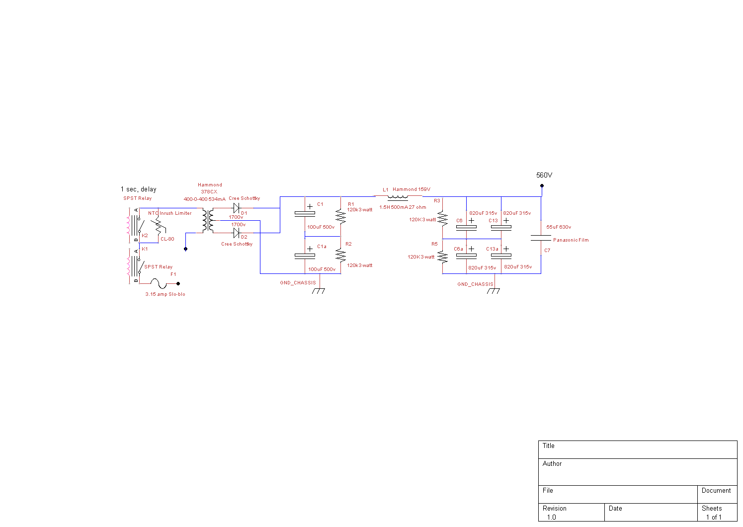

I'm actually using that transformer in a stereo KT120 triode amp right now. Here is what I did and the voltage you will most likely be close to. My line voltage here is pretty much exactly 120V.
Ooops... I get 543 volts with ~220mA current draw not 560V.
