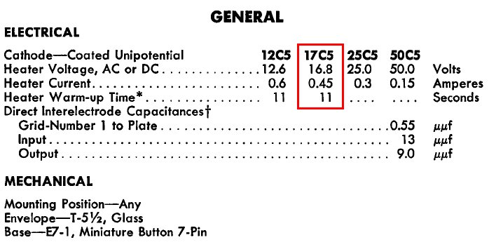

You can find lots of examples just like this. The 50C5, 25C5, 17C5, and 12C5 are all, like the 6SN7/12SN7, identical except for heater voltage/current ratings. You also have a 35C5 which is a different tube with different ratings.
Also take a lookitdis (see attached). The 50C5 has a 50V heater, and the 25C5 has a 25V heater, so far, so good. The 17C5 has a 16.8V heater, so they rounded up. But the 12C5 has a 12.6V heater, so shouldn't this be called a 13C5? Or shouldn't the 17C5 be called a 16C5 instead? There is no consistancy here at all.
Reusing type designators like **C5 or **L6 should not have been allowed, and they should have decided: round heater voltages up or use the whole number part as the leading type number.
But that's not how things worked out.

12.6 volts (or 6.3 volts for that matter) is so it will run properly from a fully charged car battery. And those batteries are generally referred to as a 6 volt or 12 volt, (courtesy of each cell being nominally 2 volts) so it sounds reasonable to call it a 12C5 because of the association with a "12" volt battery.
Miles Prower said:But the 12C5 has a 12.6V heater, so shouldn't this be called a 13C5?
