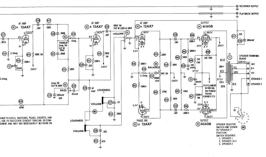

You might find this interesting...
Magnavox 6L6 amp?! a.k.a, IT WORKS! (plus pics!) - AudioKarma.org Home Audio Stereo Discussion Forums
Many classic tube amps used 12AX7s to drive 6L6 class tubes with good success so a bit of studying of these older circuits may be helpful. Sure there are better drivers but it can be done so why not.
HH Scott 99D for example.
