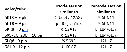

In the spirit of John Atwood's great "Tube Dumpster" articles in Vacuum Tube Valley, here's a wee table of triode/pentode valves that are relatively inexpensive and have sections that are fun for audio.
The 6LQ7 and 6AH9 make very good mu-stages, as does the 10-pin 6X9/ECF200 (its 150V maximum heater-to-cathode voltage comes in handy).
The 6KT8 can make a spud phono stage - load the triode stage with a CCS for a gain ≈100, configure the pentode stage as a triode (μ≈55 gm≈13mS) sandwich passive RIAA between them and get gain @1kHz ≈50dB ...
Here are two lists from GE that detail what is inside the "new Compactron tubes" of 1962 and 1964. The 6BN11 is not listed here but I believe that it contains a pair of 6EW6's.
That that makes the 6KT8 a triode from a 12AX7 and a pentode like the 6EW6.

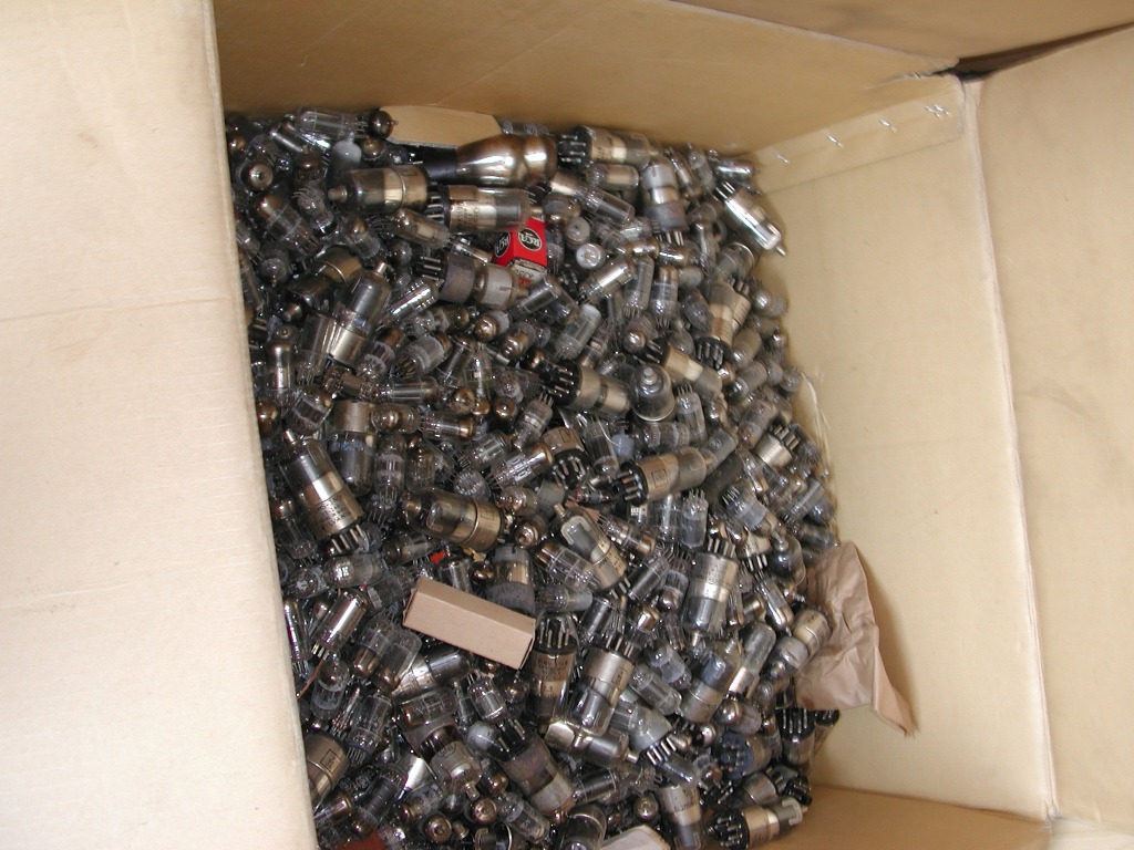

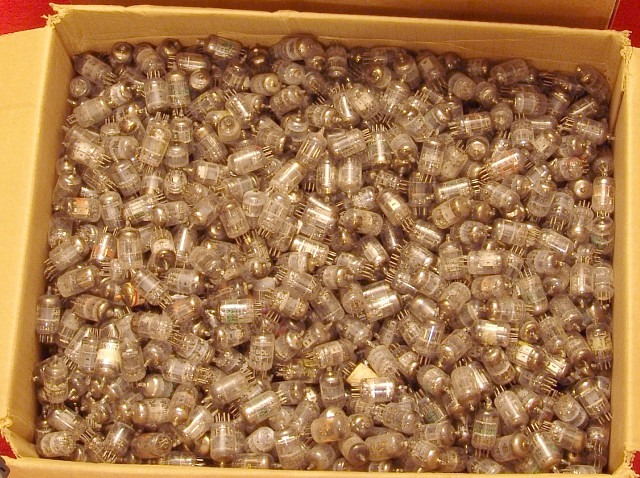

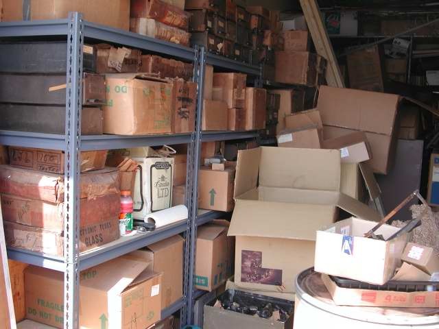

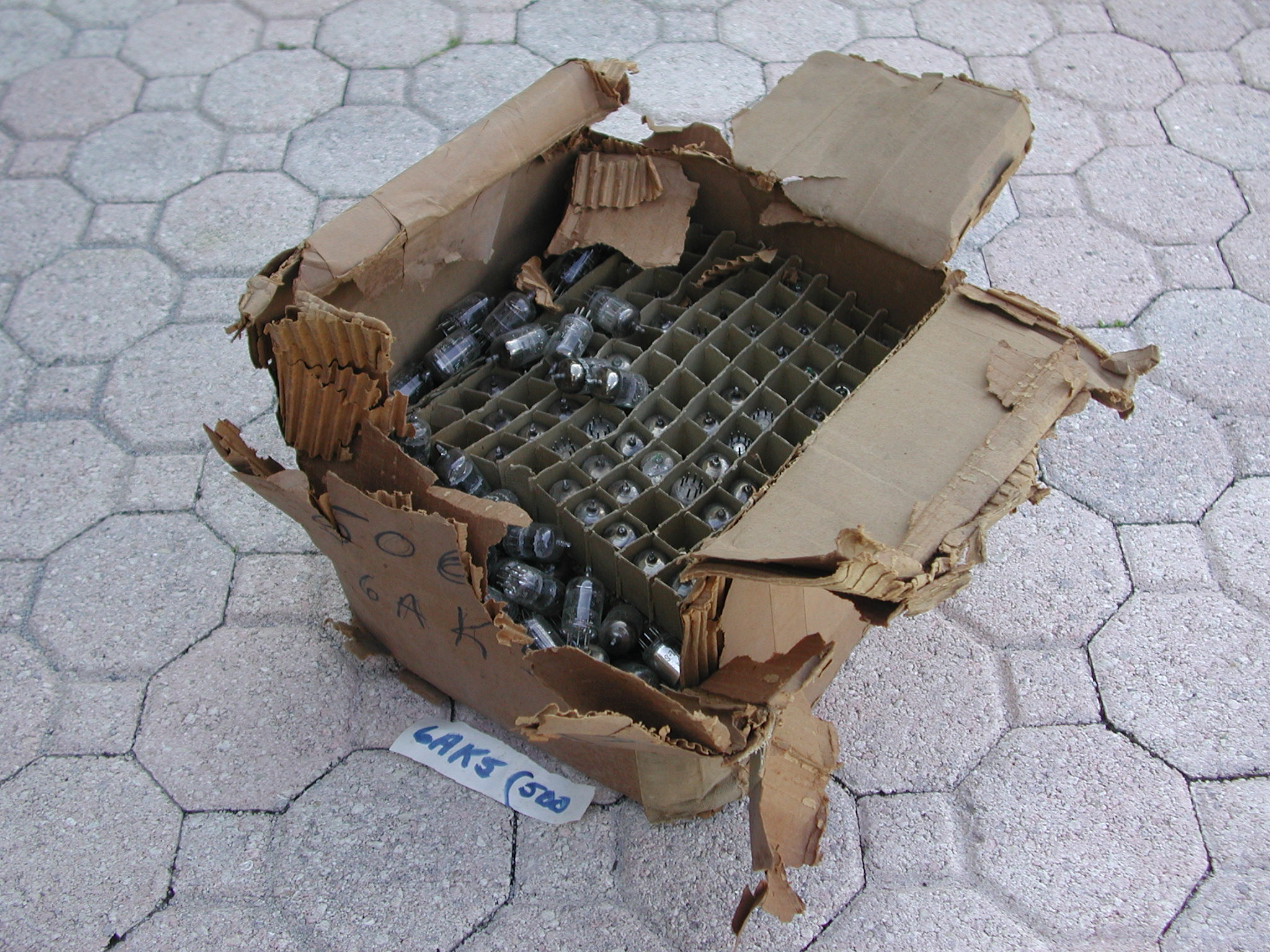

About 30 years ago I acquired over 100,000 used vacuum tubes that had been stored in an abandoned warehouse in paper bags, boxes and 50 gallon drums. Vandals, pigeons and the Florida weather combined with broken windows had made a mess of the place and broken tubes were everywhere. The warehouse had been slated for demolition, but someone decided that all work had to stop because "hazmat" had been discovered. There were some mercury vapor rectifiers in the mess, and some were broken. I dragged all the tubes that were intact or were still in intact containers back to my storage facility 200 miles away. It took me over 5 years of weekends to sort them all. There were lots of junk tubes that got trashed, some that were useless to me that got sold by the truck full cheap, some oddities, and some gems. Note the unopened box from the Douglas Aircraft Company with a postmark from Feb 16, 1937.

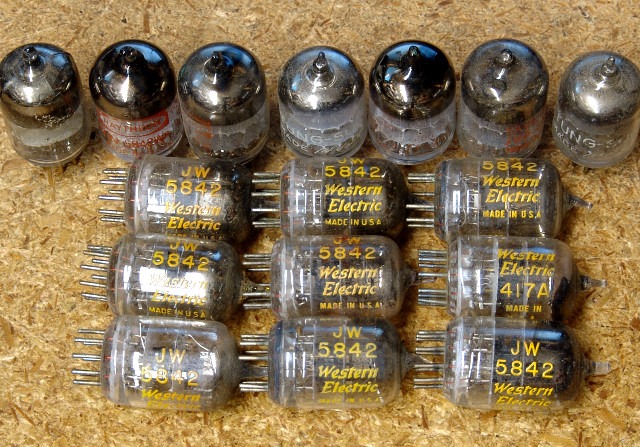

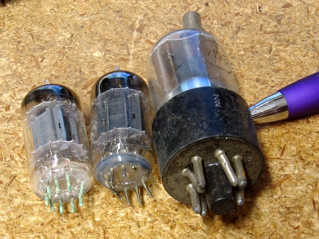

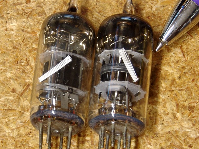

How did an extra heater wind up inside the glass? What are the odds of finding two of these oddities. Someone on an assembly line somewhere must have been really bored, OR their work rate was being measured by parts consumption.

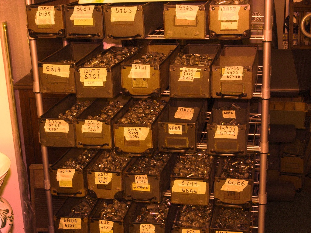

The previous post reveals a little bit of how and why Tubelab got started and why the original Tubelab SE (TSE) amp used a 5842 / WE417A tube for its input stage. I had some pristine WE tubes and a whole box full of Raytheon 5842s. As engineers often do I started making spreadsheets with lists of tubes having compatible pinouts so that I could rig up a way to find out what was useful for audio or RF and what would get sold or trashed. Now, 30 years later I still have 5000 to 10,000 tubes from that lot.
I sorted all the tubes by base type, then by compatible pinouts. Then I rigged up a simple audio gain stage, output stage, or other useful function, connected up some variable power supplies, an audio generator, scope and measurement equipment and tested lots of tubes.
