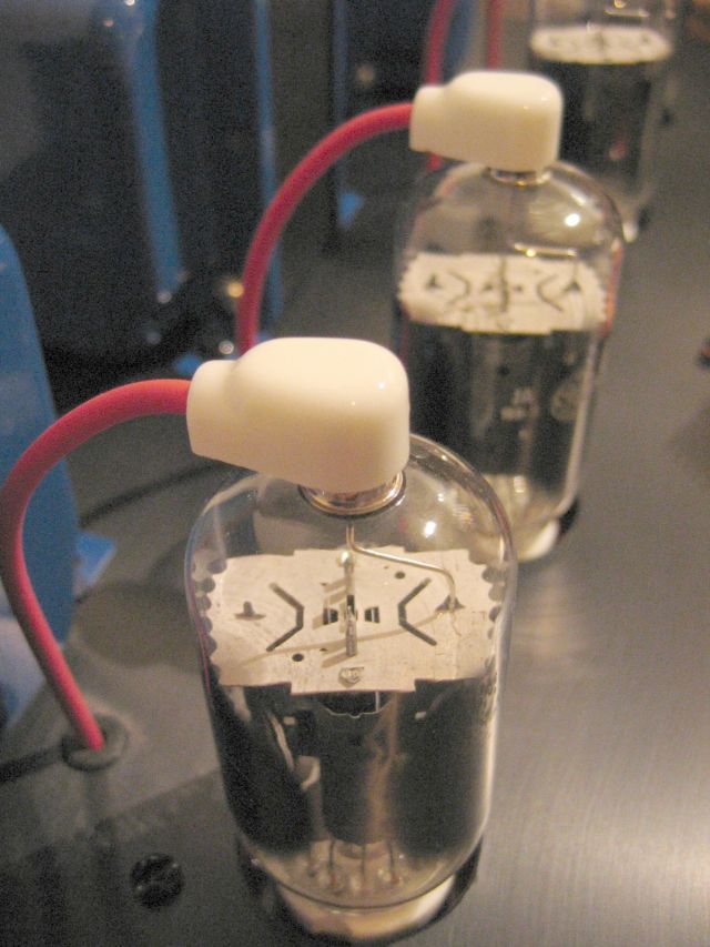

I'm planning on using 6JM6 or 6GV5 as I like the plate cap look, my question is what size top cap do I need as the datasheet only shows it as a C1-3 cap 😕 dose anyone know what size this is? http://www.mif.pg.gda.pl/homepages/frank/sheets/123/6/6JM6.pdf
Also, what cable would best suit to connect the cap and plate connection on the PCB, plate voltage will be about 325V ( not sure of current? ) so was thinking that a silicone - flexible - stranded cable?? any tips would be great

Here's a close-up image of the 6JM6, cap and lead on my DCPP.

I am building a DCPP, and have collected some eligible sweep tubes.
Yesterday I was looking at my 6GV5s. They do indeed have a physically "small" grid cap. I have some small ones that I use on 6C8G and 6F8G. These fit perfectly. This size cap is listed as a "skirted miniature."
Above someone refers to the "small" grid caps as being those that fit the 807. I don't have an 807 on hand. but I think that is not correct. Look at this web page, which refers to the 807 size grid cap as a "medium."
Tube Sockets & Grid Cap List @ ABC Vacuum Tubes
I just looked at the charts for some of these tubes. Although the cap for an 807 is indeed referred to as a "small," the cap for 6GV5 and 6JM6 (and 6F8g) is the "skirted miniature", and I can assure you it is smaller than small.

A 6mm (1/4 inch) cap fits the 6C8G and a 10mm (3/8") cap fits the 807

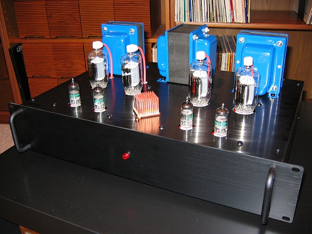

Yep. I had it left over from a computer upgrade project. The SS bits are mounted to the heat sink bottom with small machine screws into drilled and tapped holes. The sink is then bolted to the (anodized aluminum) chassis top plate. With the sink and the top plate, there is more than ample heat dissipation.

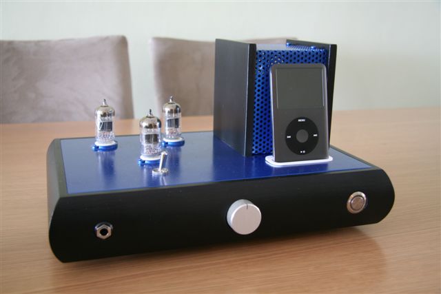

I will try to keep the chassis frame height the same as my 6N1P Headphone amp ( hope the pic attaches ) but really am stuck in my head as the size, shape and style of the heatsink!!
But that's why we do it I guess 😉

Pete mentions on his DCPP webpage, that he added the heatsink after he found the top-plate was hotter that he expected.
When I build my version, I found many heatsinks available on ebay, but used the CPU heatsink I had on hand. The top-plate I used is a bit thicker that the one Pete spec'd, so is also soaking up heat.
You mention fan cooling....
It can't be seen from my posted image, by there is a very small DC fan mounted in the bottom plate. It blows upward directly on the PCB. It is quite silent and provides some air circulation to the components on the board. You probably don't need a fan on this modest little amp, but it can't hurt and was easy to install.

Sweep tubes do indeed use "miniature" caps, and the 807-size cap is called "small".
I have probably stuffed more different tubes in Petes board than Pete has. There are plenty of different tubes that will work in the board with no (or minimal) modifications. Two different size plate caps are needed. The 6JM6 and many others have a 1/4 inch cap which is called "skirted miniature". Some other tubes that will work in the amp without modification like the 6LR6 use a 3/8 inch cap that is called "small". This is the same size cap that is used on the 807.
There are dozens of other tubes that can be made to work in the big red board if you are willing to modify things. Some modifications are simple, some not so simple. All of these tubes will use one of the same two plate caps. Right now my board contains E130L output tubes. This required rigging some octal sockets into the board.

Just tapped into the heater feed with the addition of a small SS rectifier bridge. At around 6 volts, it's running at about 1/2 speed and is quiet. The fan is always on when the amp is switched on. Simple.
