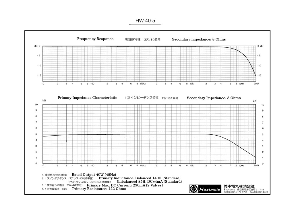

Here is a case where frequency response has been measured using a source impedance equal to the nominal load:
Frequency response looks quite good despite 1X load! However power response will be poor. The reflected impedance at 20Hz has nearly halved. The lower the inductance the higher the distortion which will be easily in double digits in SE amps already at medium output levels. A typical good quality 5K SE transformer has got about 30H (in the case above it's rated 25H but it is measured with small signal and will get to 30H or a bit more at full throttle, still being a bit signal dependent) while a good 5K PP transformer has easily got 5-10x. Like in this other case from the same manufacturer using the same design principles, the same materials and getting about the same (actually a bit better) insertion loss:
Actually the SE transformer above is the top of the range while the PP is not! The top of the range PP transformer is even better! Between SE and PP there is quite a difference. The assumption of proper loading based on transformer nominal impedance is only valid for the PP case.

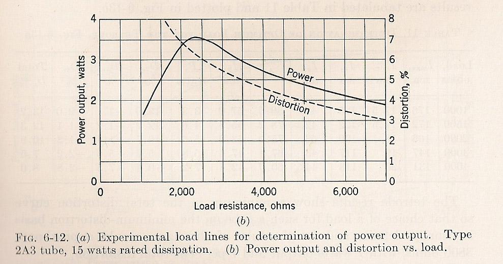

Load Rl equal to triode rp is not a good place to be. D% goes thru the roof. And at large signal peak currents don't look good either!😀 These examples lifted straight from the EE text books of that era.
Of course Rl=rp is not a good choice. That's what we have been saying until now. This is only used to measure the FR of transformers for generic use. Most Jap transformers are specified this way so you can compare straightaway. Same for the other specs like primary inductance typically done at just 5V @50Hz, power rating at specific low frequency and insertion loss. The 5K (expensive) transformer above is likely to be used with 300B and similar stuff so it will actually behave better! Here however the problem is that one wants to build a low power amp with high rp tube. That's not for sure the best choice. If then this is compromised also using a transformer that at low frequency has not enough inductance the result is not going to be that good before building it.....
