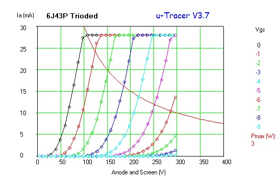

Yea, I’m abusing mine definitely. I’m running the dissipation at 5w and 230v plate. I wouldn’t build it for someone else like that but for me I’ll see what happens. The plates aren’t red and I’ve been running it all day for a few days now.

Yes, I think distortion in a circuit like this(no FB) specifically 2nd order can be lower with well matched tubes. The input transformers are fairly low distortion and don’t contribute much. The output transformers will be negatively affected by DC offset in the core so that’s also related to tube matching.
The circuit needs a low Z source and so passive volume control is out. Any sort of preamp or DAC with a buffered output will work fine. I’m using a miniDSP. I also have a FocusRight Scarlet Solo that has a volume control that works well. Both those devices have output Z in the 500R range. A tube based pre with CF output would also be fine.

My build needs 1.3vrms in to clip the output so any modern source that can provide 2vrms will be fine. There’s not actually a huge difference practically between a 6.6k and 8k OT in the real world. Might work fine.

With transformers and specifically small signal transformers I go by experimentation. Different types are all very different. Some are super sensitive to secondary loading others are very sensitive to the driving impedance. Are usually take a low z square wave generator, something sub 100R. Then I put a pot in series with the primary, like a 1k. The. I load the secondary with a pot, like a 200k or something. Then scope the secondary and adjust the pots for the best FR. These Ampex units actually don’t care much about secondary loading but ring a bit up at 30k if the source Z is too low.
Great DIY production. Like this simple and straightforward circuit.Is it also very good to replace 6J43P with 6J52P?
