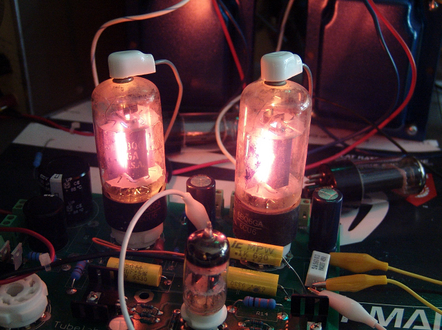

I have over 100 6BQ6's, so let us know what you cook up. I'm thinking P-P though. The 6BQ6 works OK in SE. I have melted a few in the Simple SE, but they absolutely rock in P-P. Note the pinout is compatible to the popular audio tubes, just wire the plate cap to pin 3. They like screen drive too as long as you are reasonable with the power requests. Thermonuclear meltdown occurs at 110 watts output on 550 volts B+.

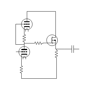

Problem is, the output stage is a reactive load and that, along with the loads R5 and R9 (what does R5 do?) will compromise the linearity of that stage. A buffer (you might consider MOSFET if metal is already cut) will clean things up significantly and let you realize the potential high performance of the stacked triodes.
Hello SY,
Story be told, metal cut or not, this is a breadboard toy. This will be the first set of real experiments with a PC / sound card based audio test system on my bench. I plan to look at this stacked triode, power supplies, noise and distortion.
The kid in me wants to beat this with a 4 oz ball peen hammer and watch what happens on the computer output. Put more academically, how much will be compromised, without the buffer, I want to see?
The thought regarding R5; R5 is a high value bleeder to drain the coupling capacitor. I will put my feigner in there without thinking.
Please tell me more of the MOSFET buffer how would it be implemented?
DT
All just for fun!
Topologically, this is the easiest way and will work fine, but with a negative supply available, you could put the follower on the other side of the coupling cap and have the option of A2 operation as well as better overload recovery. If you go the easy route (recommended for your first go-round), you could use something like an IRF820, a gate stopper of 1k or so, and a source resistor of B2+/2I, where I is the desired mosfet current (I'd use 10mA or so to start).
