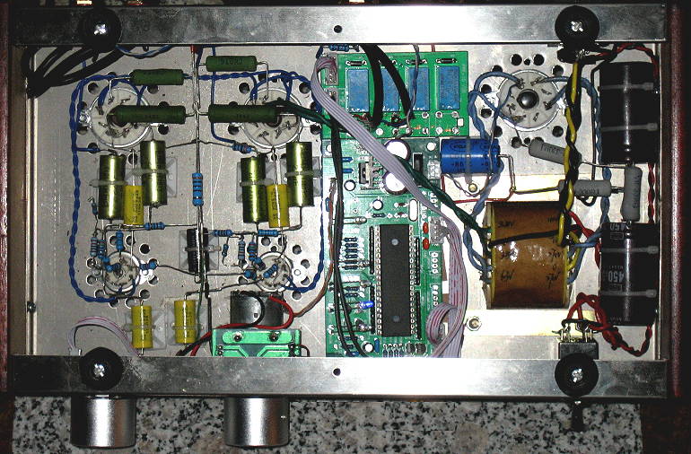

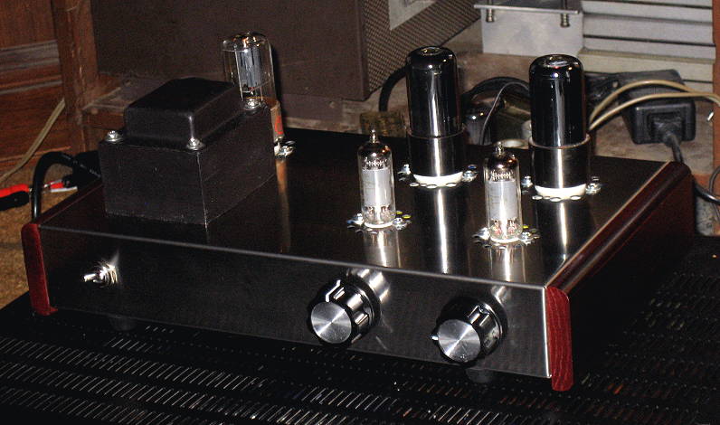

Thanks Bob....One of the PT Bolts can hit a Terminal Lug on the Power Switch...Ouch....
I cut 1/4" of It so that the Switch would be able to Mount Flush on the Front Panel...

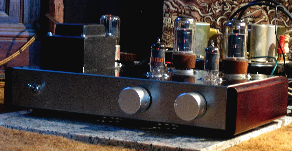

Here it is with the Lights On....
This is Nicer...
Hey Ray...Can you please Post a Pic of how the Selector Switch is Wired? I has only 3 Positions, but the Case has 4 Inputs...
Sled, same here. Maybe it's reserved for some other kits. It's not designed by Siliconray. Several kits share the same chassis, that's probably the way of reducing cost. I mounted a pair of RCA there but with nothing connected.
I removed the plate behind the jamb nut. If you rotate it you can gain or loose the number of positions the switch has. I think it has 8 or 9 but you can adjust it to have just 4
No Poop? ...Learn something new Every Day..Thanks...
And, if you want to lower the Gain, it's Way Easier to just parallel the 24K...Use an OnLine Calculator...I've found that a 10K over the 24K gave 7K, it helps a Bit...Not very much, so I then tripled with a 5.5K that made it around 3K, but I think that Messed up the Sound...I'm keeping it at 7K for now until the New Alps gets here on the Slow Boat...
the knobs looks great! I will suggest adding some options such as knobs and good potentiometers for the kits
Great Idea Ray...Alps Pots, and if you can Do $10 a Pair, Shipped, for Knobs like These...
And, how about Little Metal Stick-On's for Power, Volume and Input?
I mean Little Lables for the Power, Vol. and Input Selector...
Your Knobs are Nice, but I got Mine for $9.95 a Pair, and Paid for Them a Week Ago...That's Fast Shipping...
Yes It's a good idea to make some universal lables.. power, volume etc... I will check what can do here.
Now, here you go Ray...Remote Motorized Alps, with 4 Inputs and Mute...Only 2 Inputs now, and the LEDs are kept underneath...The IR is Relocated from the Board through one of the Holes around a 6AU6, and it's powered from the 6X5's 6.3V...It really Sounds and Works Great! It's the Best Upgrade Ever for a Tube PreAmp Kit...
