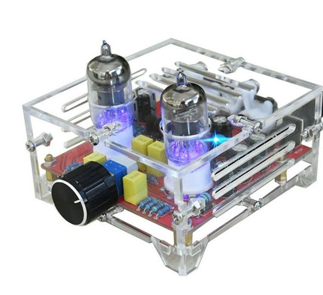

Hi , someone know how is the performance of this cheap preamplifier ?
Some time i listened that changing the tubes chinese 6J1 for 6AK5 or 5654 good quality tubes , the sound is good enough..
Is a good option for limited budget ?

I have a similar one, it's okay. It would profit from a higher anode voltage but you'd have to change a lot of the parts to do that though. The case is ugly but that's probably just my opinion but I'd take out the blue LEDs which illuminate the tubes. To do that you have to desolder the sockets, at least on mine it was.
The price is quite high though, the cheaper ones got the same parts tolerance and quality. You can get it with a really nice metal case for ~28$ or without case for 12$ (shipped from China).

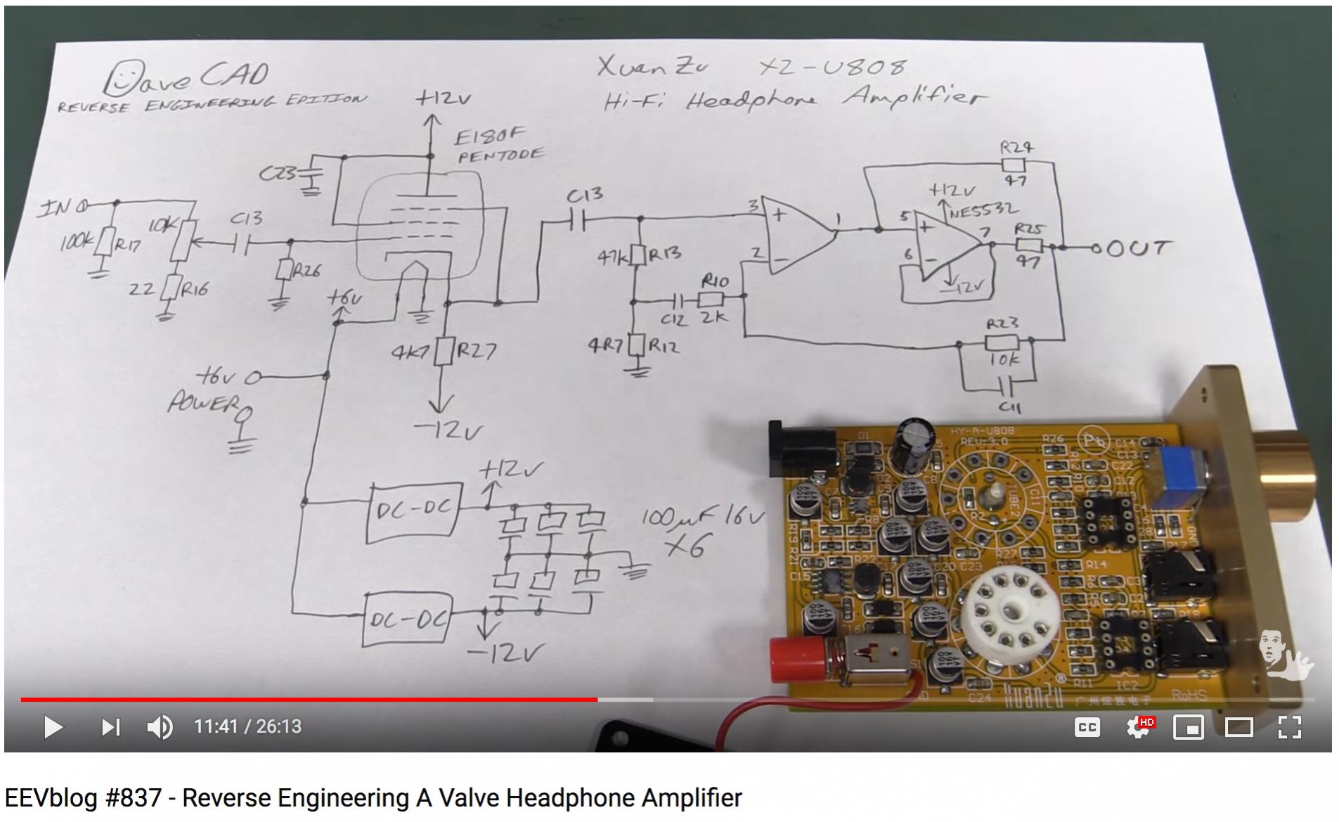

Is this it? Tube buffer with 5532 output?

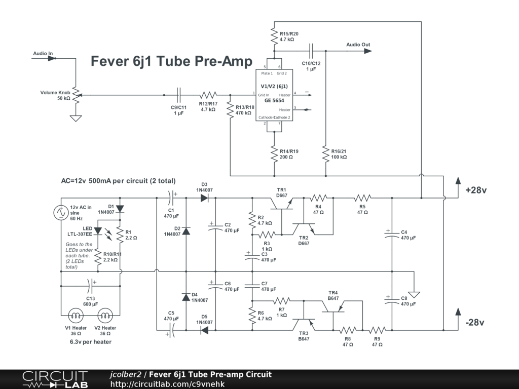

I kept a screen capture of the circuit as a reminder NOT to fall prey to its siren sounds.
I've now seen the video. It's a headphone amp (not a preamp) and the tube is not a 6J1, it's a E180F, on similar amps it's a 6J9P. And I don't think the 5532 OPs are appropriate as headphone output stages, that's asking for distortion.

Edit // tube-03 is perfectly biased, 100v, Pentode working as triode with 120R cathode and 3.3k anode (7.5ma bias).
Just the pot volume is unusual, just a variable resistor in an inverting opamp stage (ne5532) with 22k fixed input resistor and pot acting as a 0 to 50k variable resistor.
