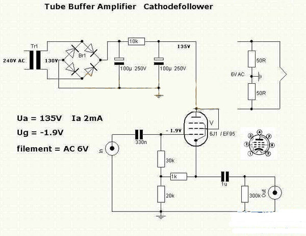

Hi friends! I was cleaning and discovered that i have 145 volts DC regulated power supply and bunch of 6J1 tubes. I think i can find 6 or 12 volts supply, so i am thinking about building something. Buffer or preamp. Sure i searched, but i would like simple verified schematics someone tested and is happy with it. Not that crappy 'fever 6j1' which circulates around.
i found this buffer on the web, any opinion?

Just do it.
Nothing is going to break, or be bad.
I don't think one could find a more vanilla 0 dB buffer, than this.
You don't even need a 'case' for it, to try.
Just use alligator-clips on the bend.
And set up the power supply bit on a tiny breadboard.
Don't forget that the 10 kΩ resistor in the power supply is going to get hot. Use a 5 watt part, or a string of lower-watt, lower-Ω parts to make the 10 kΩ.
⋅-=≡ GoatGuy ✓ ≡=-⋅
One thing i do not understand, that schematics claims there should be negative 1.9 volts on the grid. Negative. Where does one generate negative volts? Its only powered by asymetrical power supply. I measure above fifty volts on the grid, positive off course.
Why do they expect grid to get negative? Towards what reference? I measure only agaist the ground.

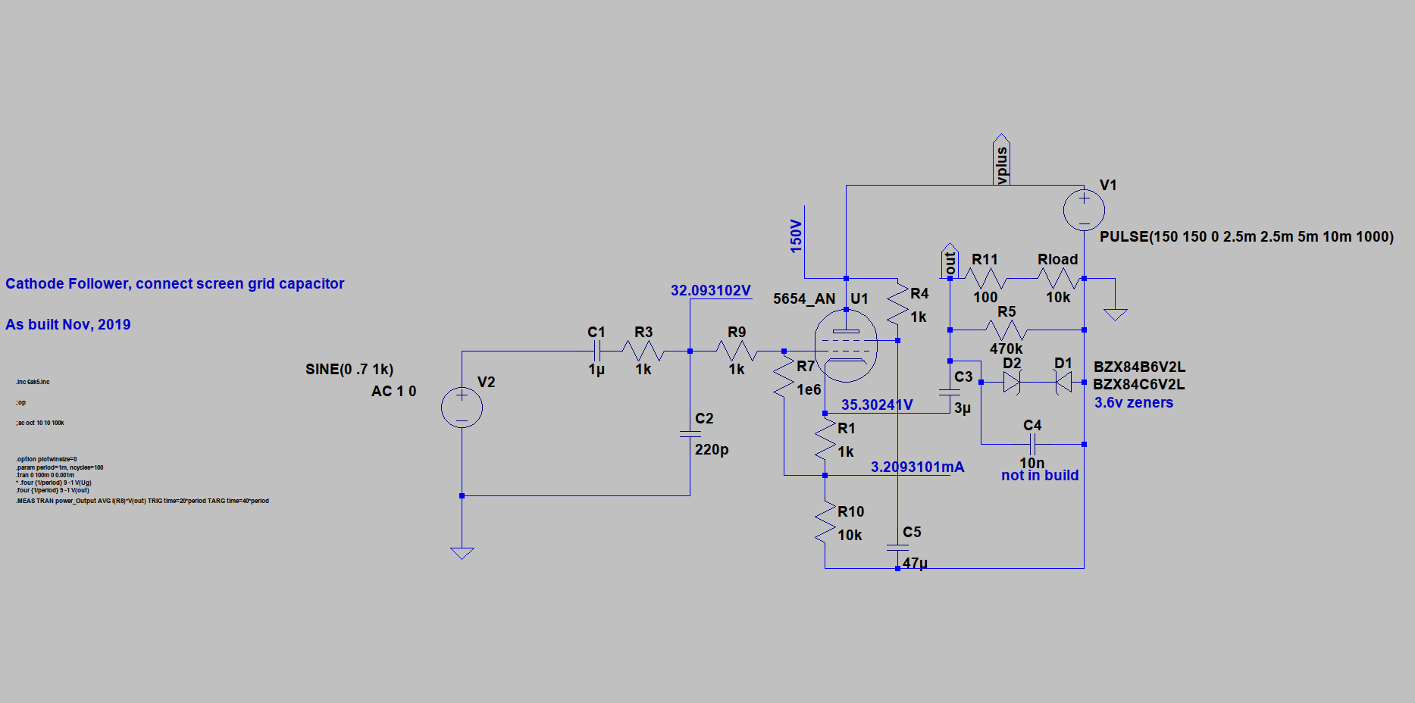

in the schematic you started with, the second grid is connected to the anode which is a fairly traditional way to turn a pentode into a triode, by feeding back the signal from the anode to the second grid
however when you are using it as a cathode follower the signal is now on the cathode and if you want to use this in Triode mode you need a way to feedback the signal from the cathode to the second grid - I have attached an example from Broskie of how to do it
