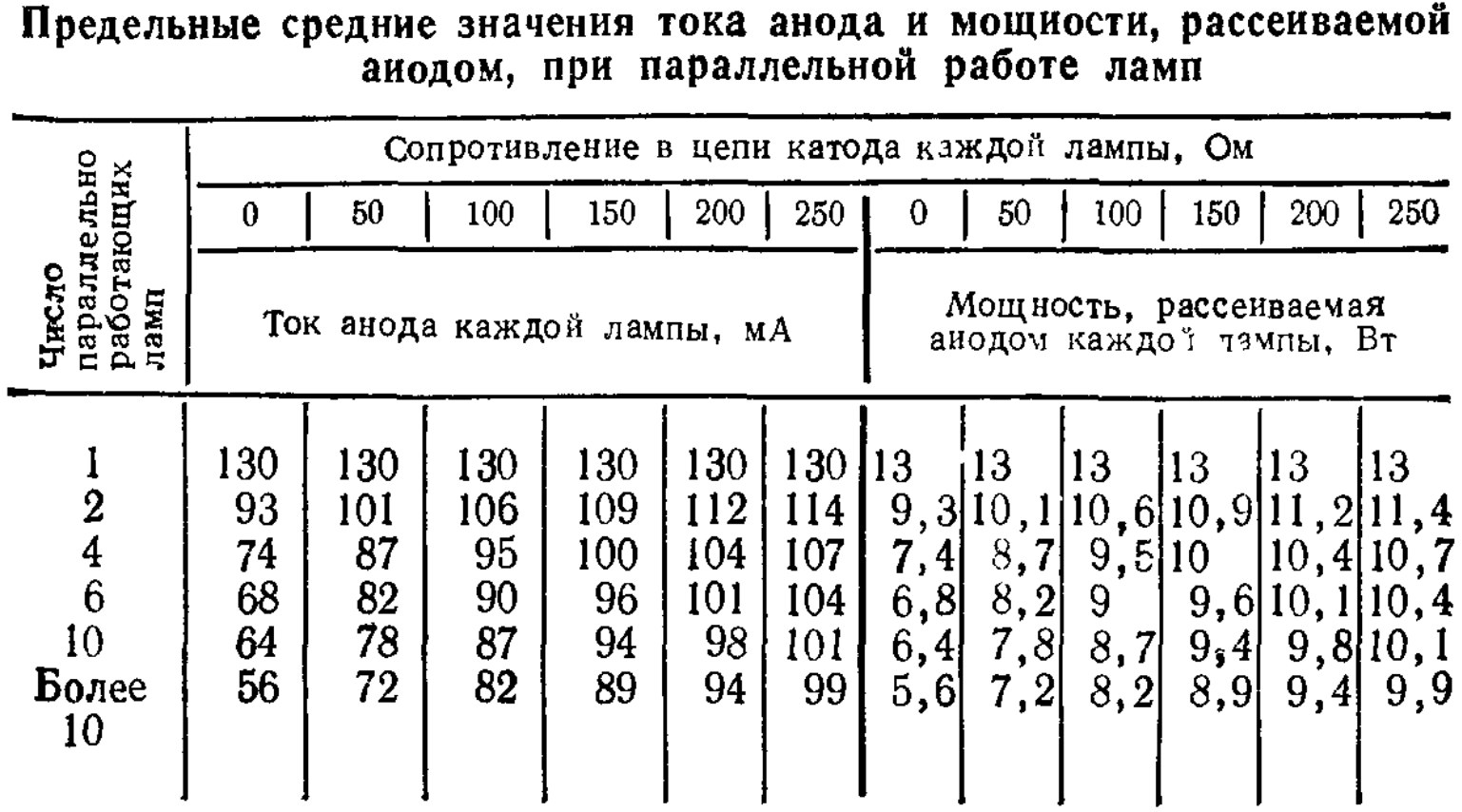

I have to say, if you can test and grade a large pool of tubes, and install closley matching sets, the result is impressive. But if you can't do the grading and sorting, you could be in for an ear bleed.
I could not agree with you more.
"He that hath an ear, let him hear"

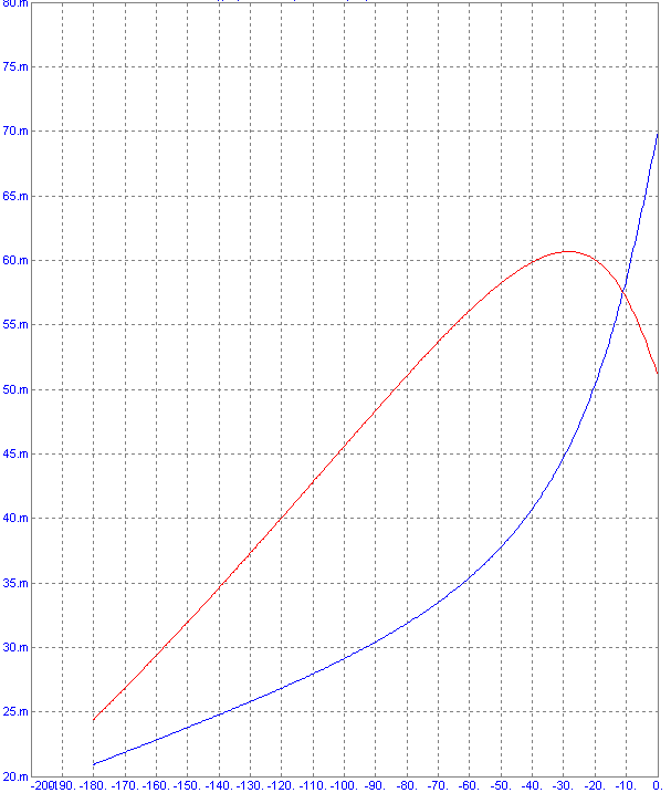

or better say, see, the attachment
Currents in two unmatched paralleled tubes
Initial currents are not that far apart.
Design decisions made upon "simulateAbility"...

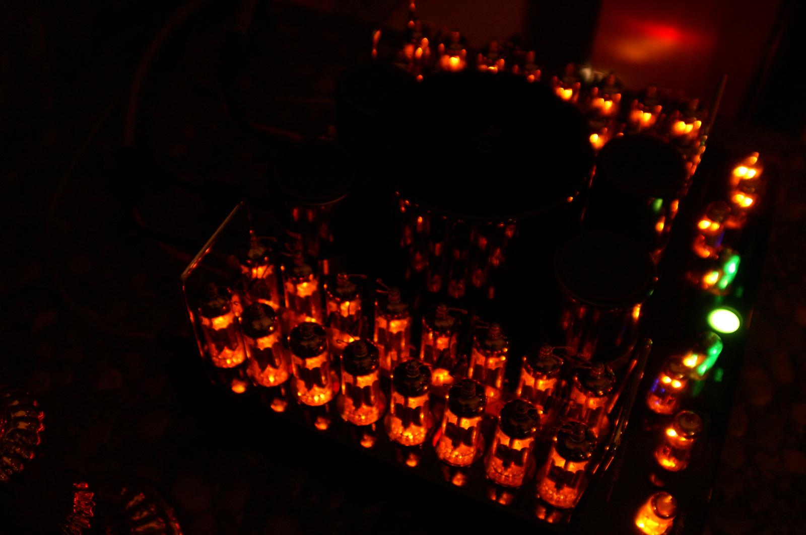

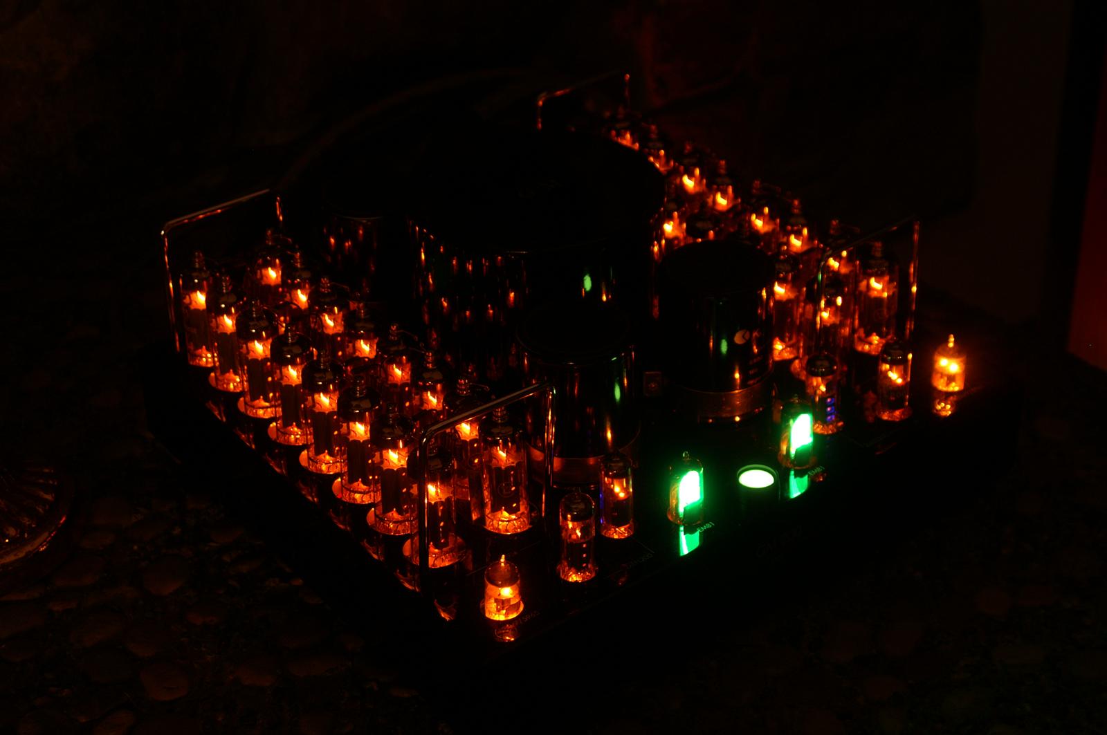

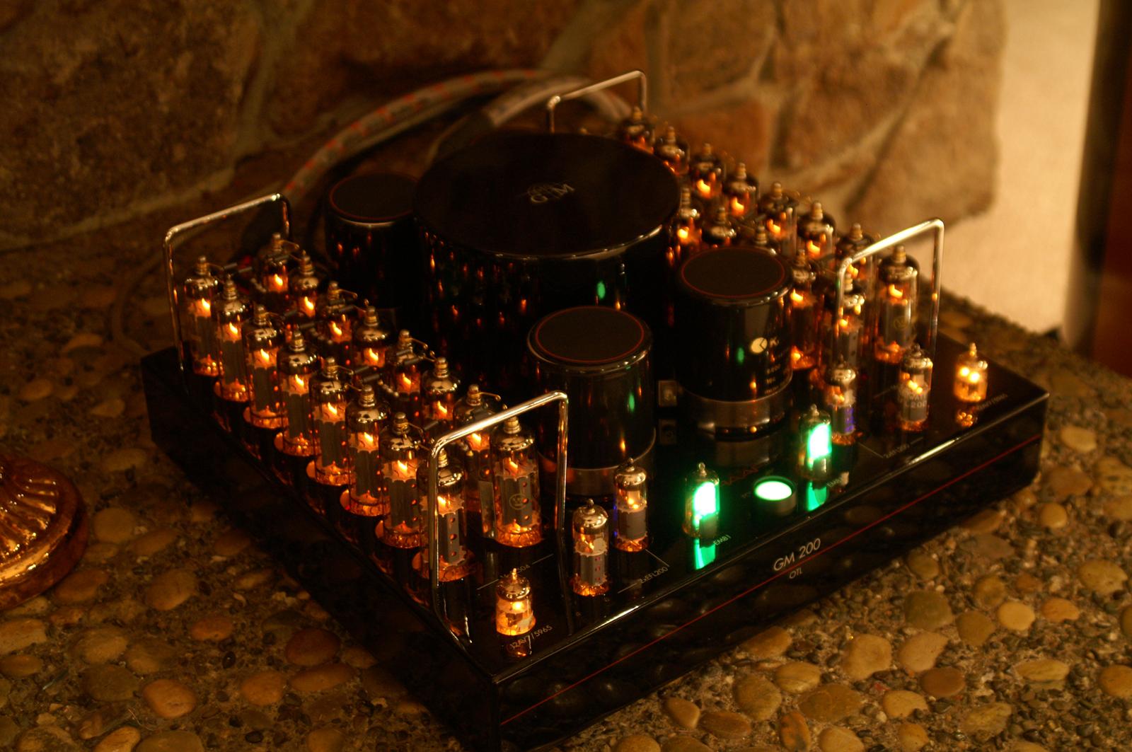

You may want to have a look at the the Graaf GM200 circuit. This is an OTL amp that has 150V rails and uses 16 output tubes in parallel on each channel to give 200W/channel. I've just received mine back from the factory in Italy, where they replaced all the tubes. They do not have individual bias controls on each tube but they do match the tubes very closely. They do have a single overall bias control for each set of 16 output tubes that they get the user to set to 750mV - 800mV after about an hour's warm-up.
Some pictures attached - I can nearly do away with my Christmas tree at night...
