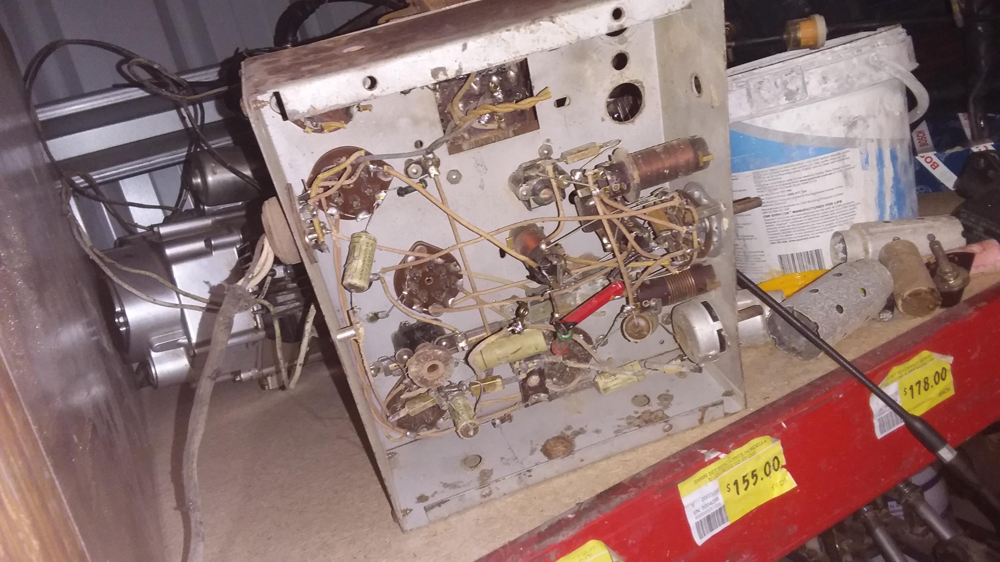

Can't see any obvious ones locally, I suspect I've just got to be patient on that front and wait for some good tubes to come up. Radiotron tubes seem pretty common here. I have some tubes that I found out in the back wood shed, in a radio preserved entirely in old wasp nests. 4 Radiotrons and one Sylvania unsure of their condition or model, probably not much use.

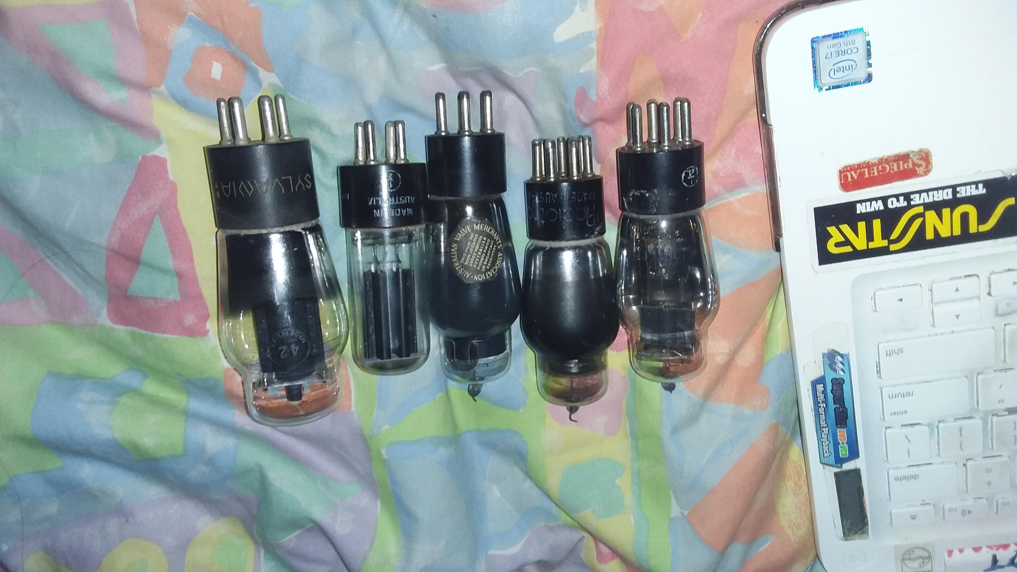

I'd say you are right about the bottle tube due to the large "80" on the back. The tube has a fairly decent rattle to it and I'm not sure if that's a problem. It'd be nice if it worked since I have a socket for it as well.
Speaking of the socket, I'll have to check the radio it came from for other potentially handy parts.
The type 42 tube at the very left is the 6-pin equivalent of the octal 6F6. As Eli noted the type 80 to its right is the 4-pin equivalent of the 5Y3. The internal structures of the next two tubes to the right are difficult to see, but assuming they're 6.3 V types I'd say the one with six pins is an IF amplifier like a 6D6, and the one with seven pins is a pentagrid converter (combined local oscillator and mixer) like a 6A7. Neither of these is likely to be worth using in audio circuits. The last one on the right appears to be a dual diode-triode, perhaps a type 85. These were used for the detector, AVC (automatic volume control) and 1st audio circuits.
Please note that all three tubes on the right are missing their grid caps. They may still be good, but they'll need to have their caps replaced if they're to be used reliably. This involves gluing them on with some sort of heat-resistant cement and resoldering the grid lead.

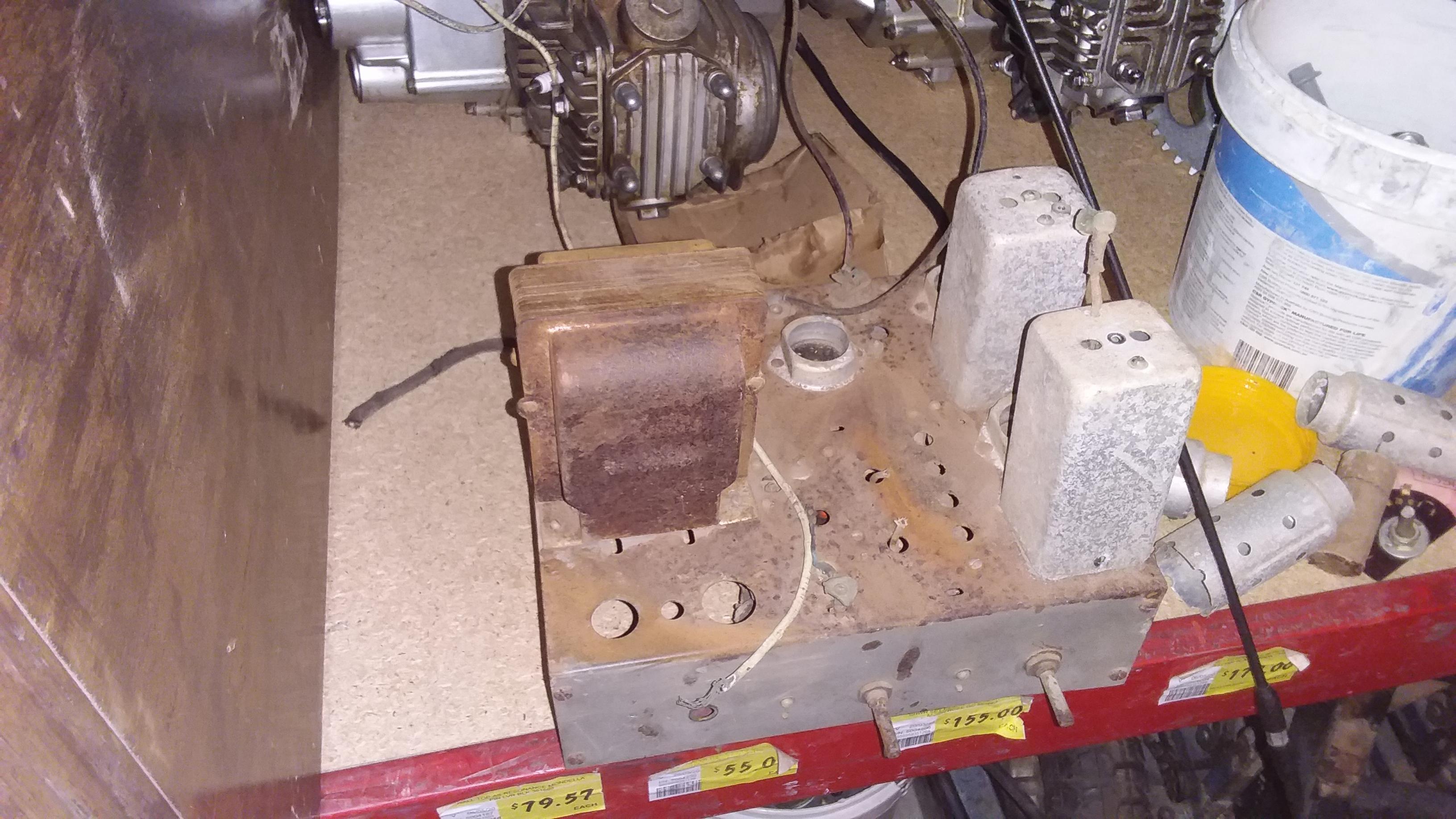

The caps were in pretty sad nick from memory, but they are still there. I'll take the transformer off for a proper look at it sometime, hopefully I can identify it.

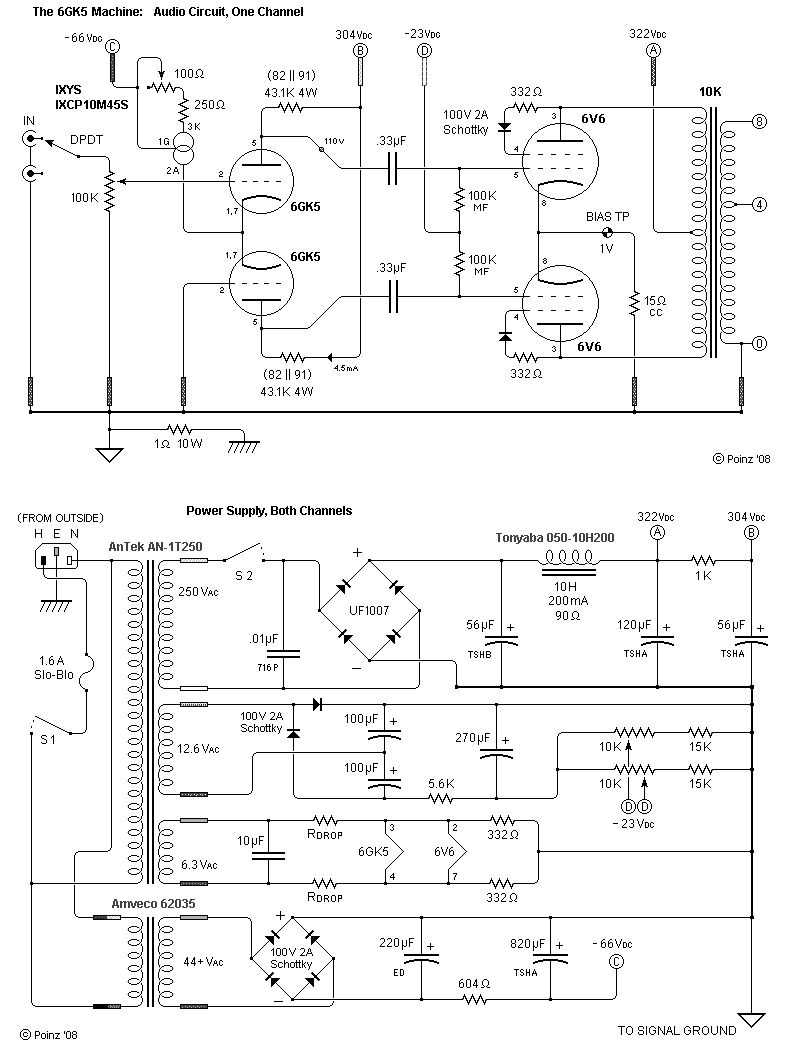

Here is the schematic I used. Sorry the pics are cobbled together from the ones earlier in the thread.

Just to be clear, if you take out the 6GK5s in sockets 1&2 then you measure 195v across the anode resistors of both the 6GK5s in sockets 3&4? But when you put the tubes back in 1&2 you measure 215v at socket 3 and 170V at 4?
Have you measured the common HV supplied (specified as 306Vdc) to the 6GK5s with all tube in, and when 1&2 are removed?
In your previous post you wrote: “ Im using 6FQ5A's on the preamp side, they are matched to within .5 volt at the bias test point.” Where exactly do you measure this bias in the amp? Depending on where you measured 0.5 V that could be too much of a difference. Are you having a CCS for each pair of 6GK5s?
If
1. the CCS is common to both tubes in sockets 1&2 as well as 3&4, and
2. the common HV supply is 306 Vdc to all 6GK5s, and
3. you are certain the anode resistors are all at specified values, and
4. you have tested the 6FQ5s,
then I would be suspicious of the wiring of the sockets, or the contacts in the sockets, or the grounding scheme. Please check to see if you measure any voltage on the grids when there is no input.
Good luck!

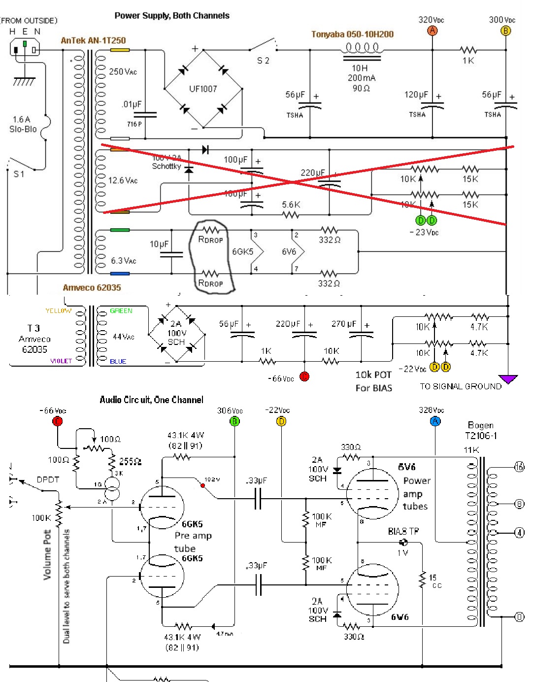

So it looks like I have some power supply issues. I took some measurements after work yesterday. In the end I did get both channels to work simultaneously, but not under ideal circumstances.
I can't seem to edit my post with the schematic, so I am attaching the correct ones to this post. Took me a while to find them. I am using an Antek AS-1T250 and an Amveco 62045. Since the Antek doesn't have a 12.6v winding, I copied the negative supply from the '07 schematic. Otherwise I followed the '08 schematic.
As-is, I obtained the following measurements:
6GK5 pairs installed || Negative supply || B+ 6GK5 || B+ 6V6
0 pairs || -72.4v || 313v || 313v
1 pair || -68.2v || 301v || 308v
2 pairs || -64.0v || 287v || 304v
I realized the 195v drop on the 6GK5 anodes was from a very old thread and 195v was the wrong number. I attempted to correct the voltage drop to get 102v on the anodes. Anyway in the process, I did hit a point where both channels played with no bad noise. However the measurements I got at that point seem way off:
Negative supply: -59.2
B+ to 6GK5: 276v
B+ to 6V6: 304v
Assuming 6GK5 left pair is 1&2, right pair is 3&4. Measurements taken across 41.3k resistors
1) 265v drop = 11v 3) 262v drop = 14v
2) 224v drop = 52v 4) 230v drop = 46v
So I'm not sure what to make of it. I don't know what it is supposed to sound like, but I thought it sounded very good. It definitely doesn't have the gain that it should. Should I just leave it as it is since it is making music?
