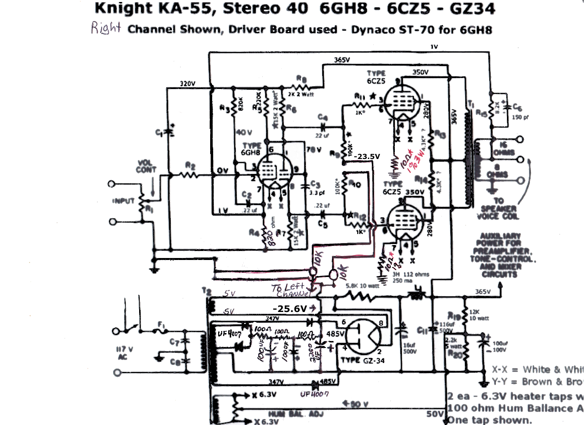

you wanted to get the AB-Q module connected to amplifier with 6GH8 and 6CZ5 tubesHello Everyone, I need some advice please. I have a Knight Kit Stereo 40, KA-55 Amplifier that is trashed. I want to use the Power and Output transformers for this project if feasible. The first RCA schematic comes up in a few places on line. The second schematic also shows up on the net and has a few voltages attached that some seem incorrect in the power supply. Also attached is an ultra linear set up from a Seeburg jukebox amp that uses the same value resistors for the 7199 tube as the rca schematic shows. What I want to do is use 6GH8 and 6CZ5 tubes in this amp and use it as a power amp. I started working on a schematic according to the Sylvania 6CZ5 tube data sheets and what I have on hand around here. Please be kind, this is my first project and I am stumped as to if this will even work. I have rebuilt several amps in the past. Thanks, Tom

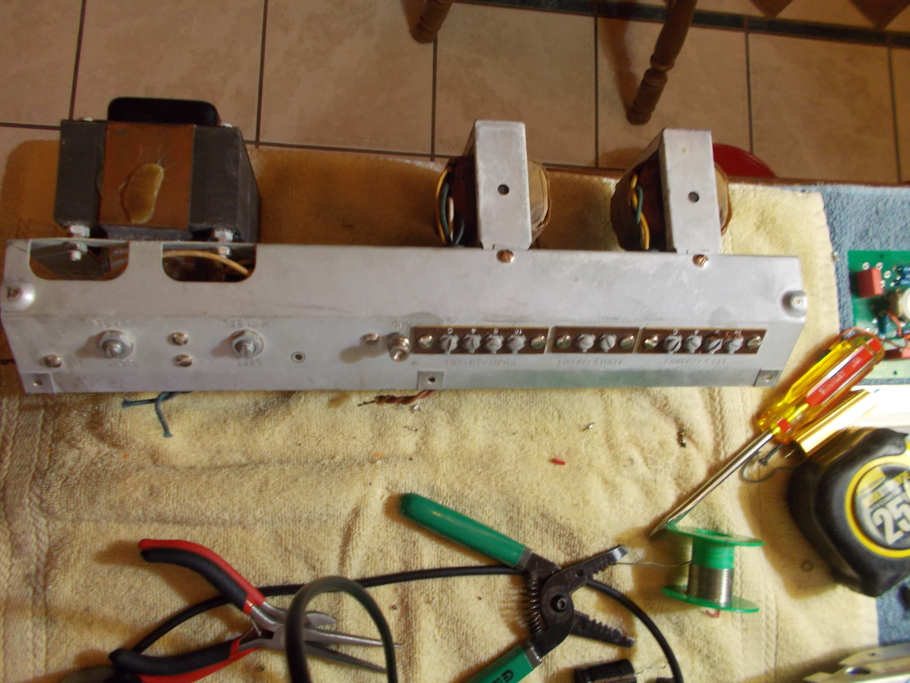

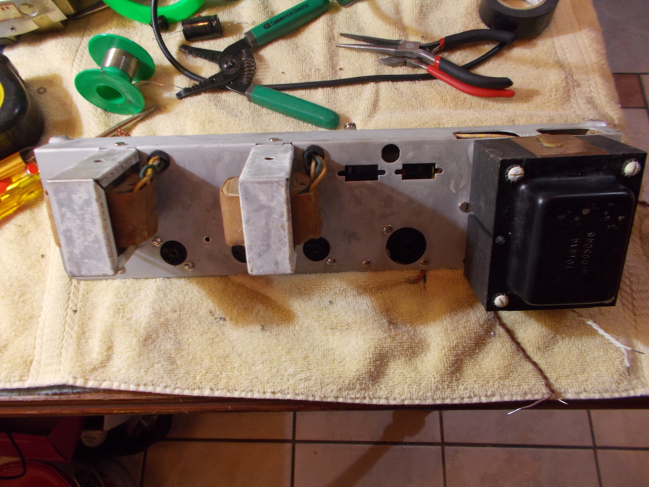

The auto bias board will not work for me. I will have right at -24.65v at 10k with nice, even, steady negative voltage. I think that will work fine to get the -23.5v or whatever I need (if) I did this correctly. Please see schematic. If not please tell me. Also attached are a couple naked pictures of what I am working with. I will mount the choke where the 115v receptacles where. Thanks
I have to oppose it. We sold hundreds of them and there are no complaints.I'm dubious about automatic bias boards. They may be OK, but I'm dubious. Setting things manually, on a periodic basis, is well known to be reliable.
