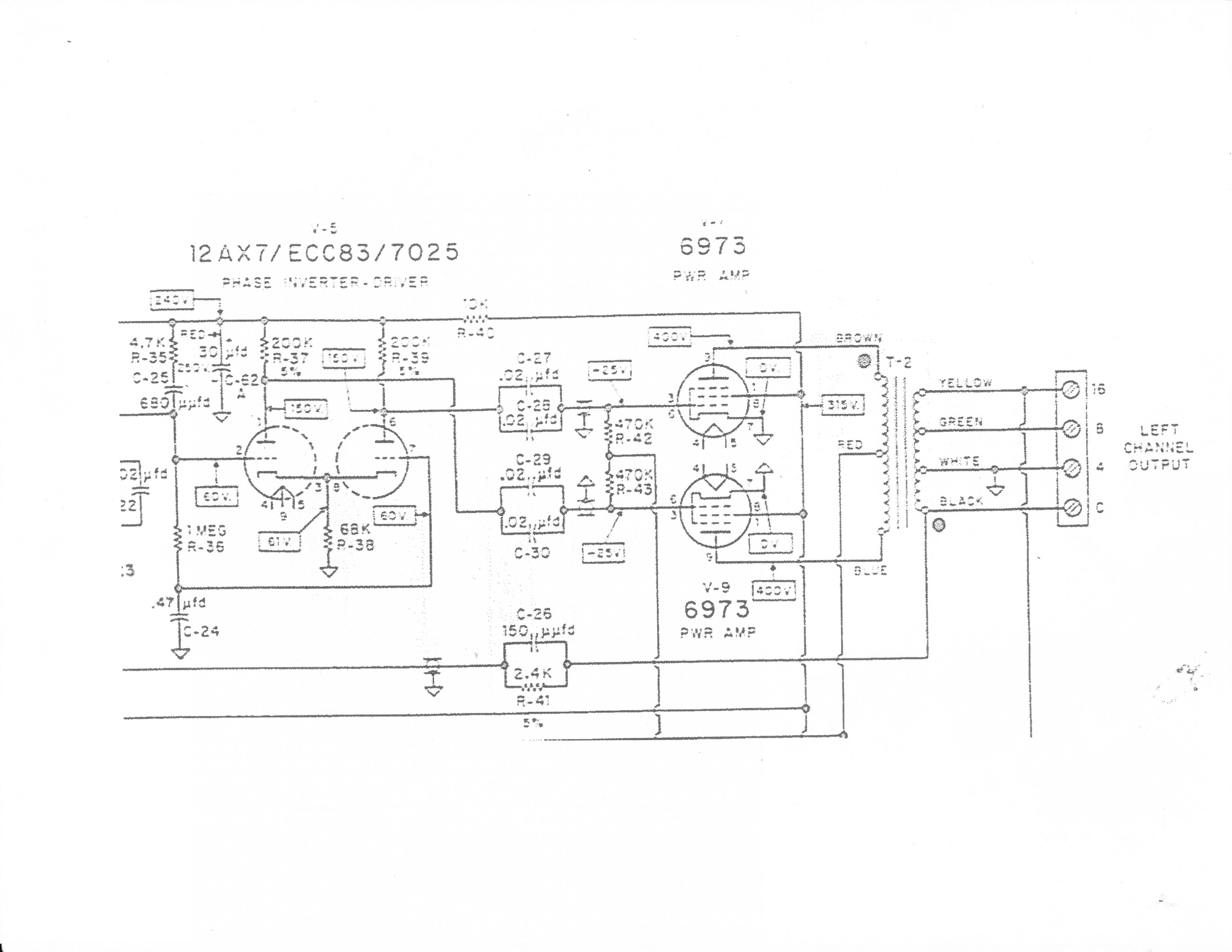

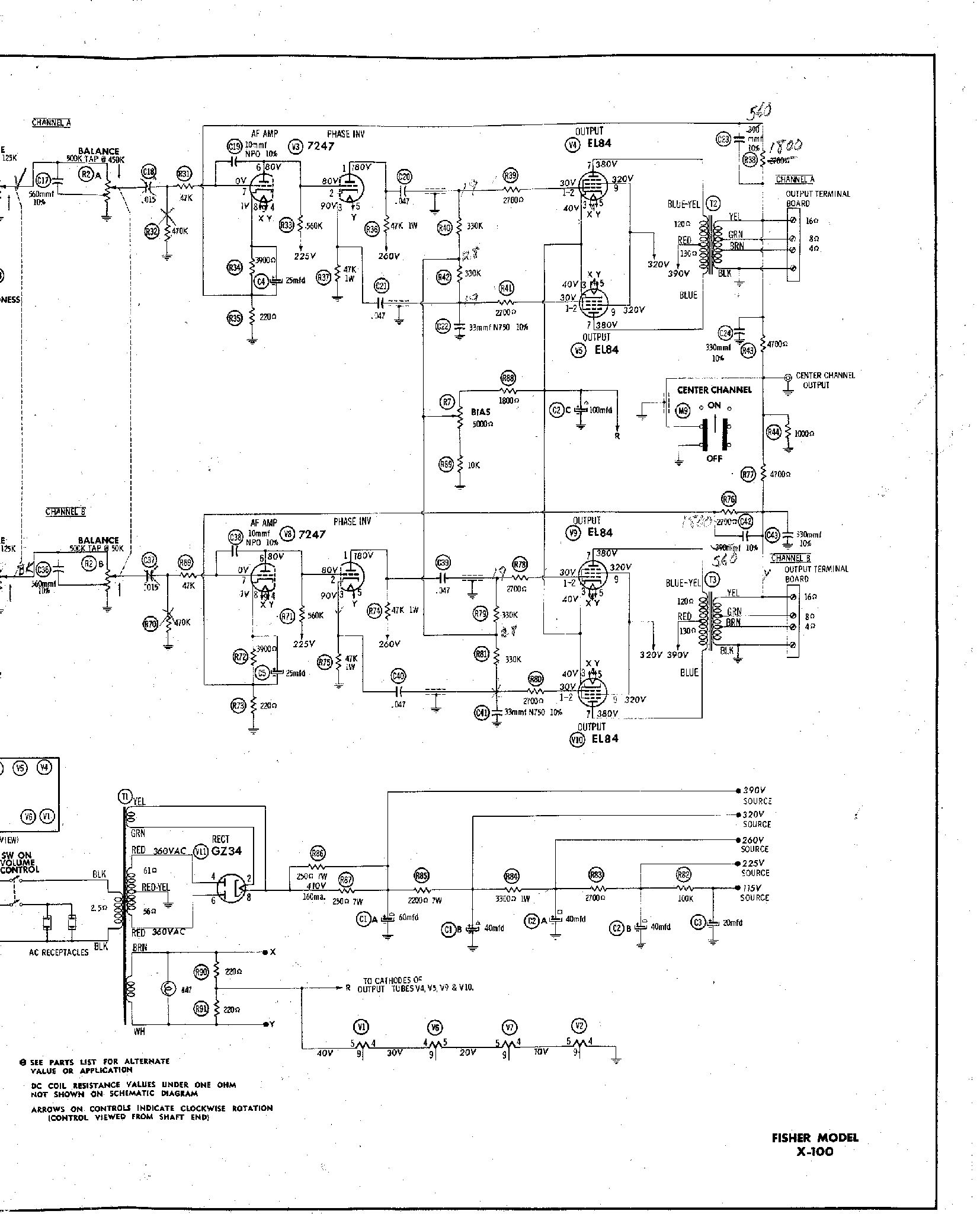

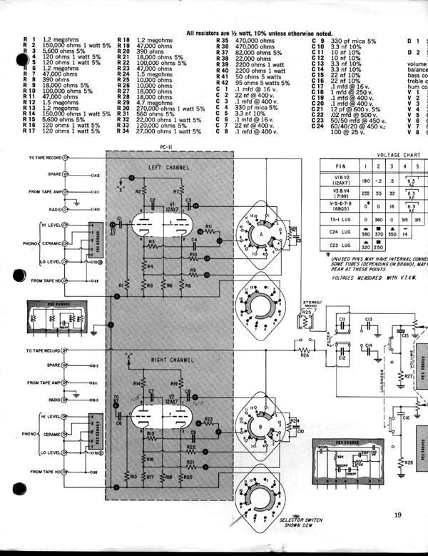

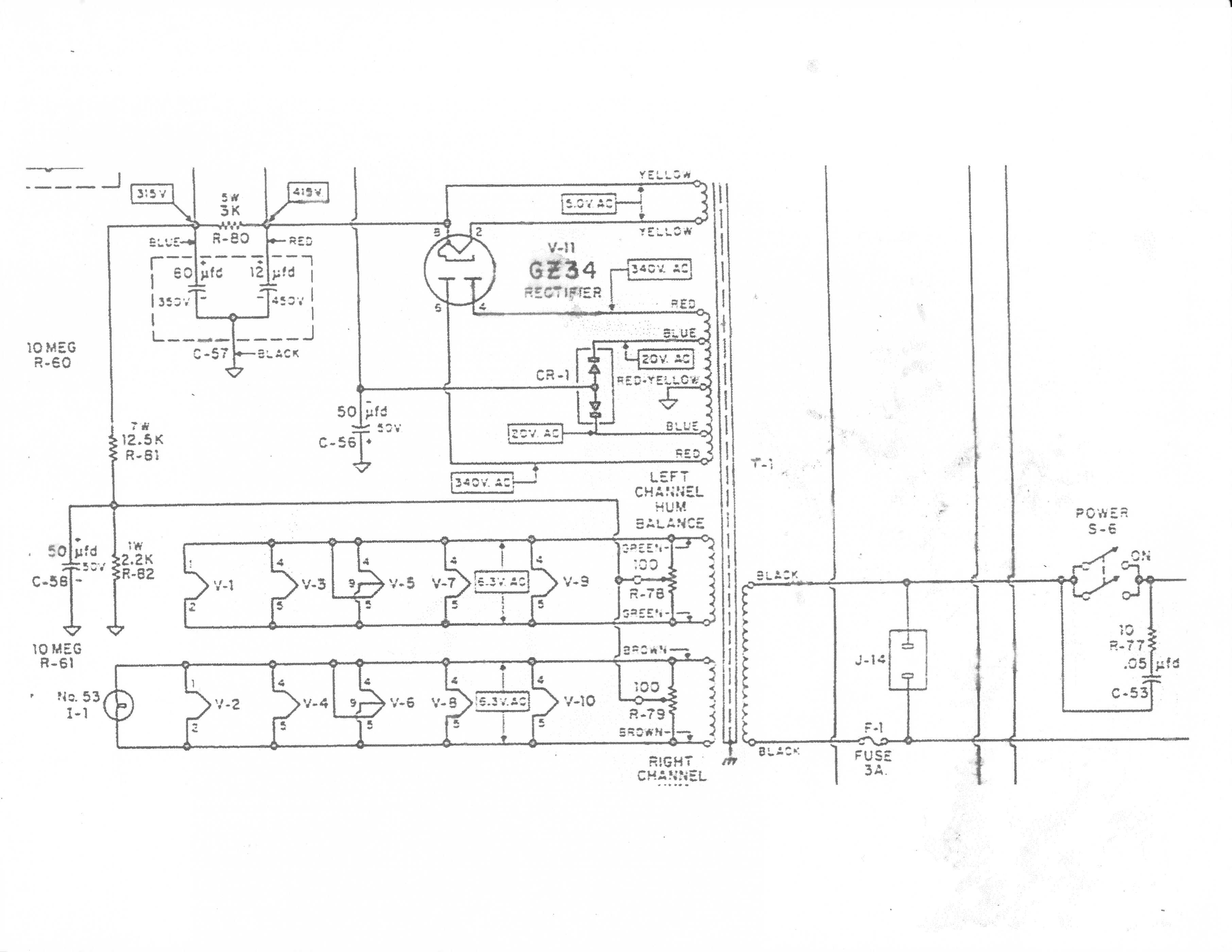

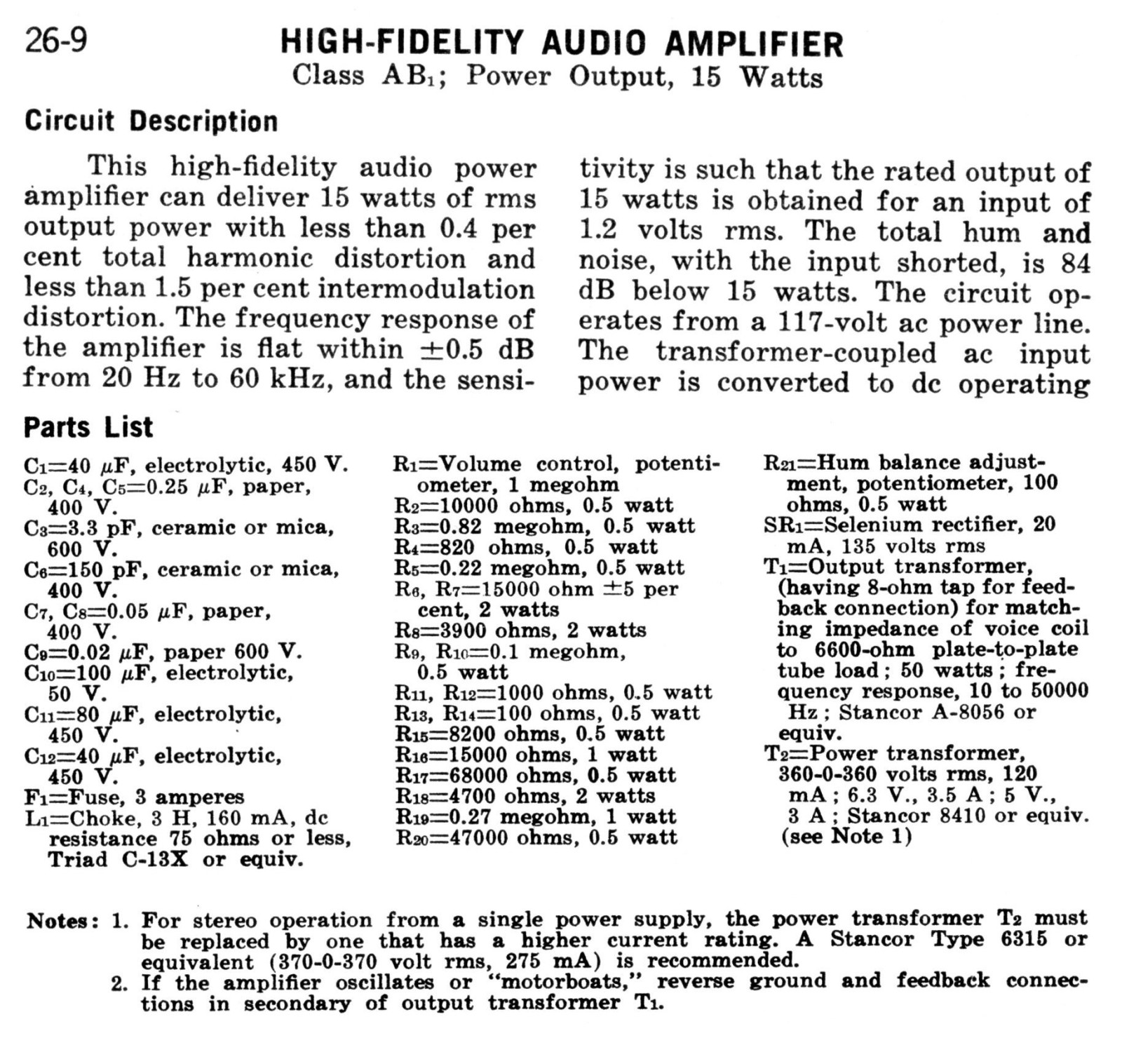

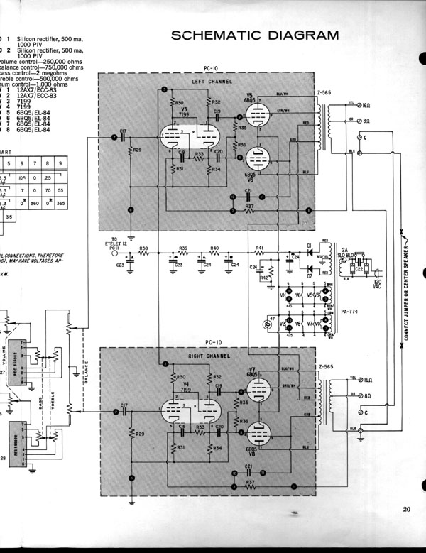

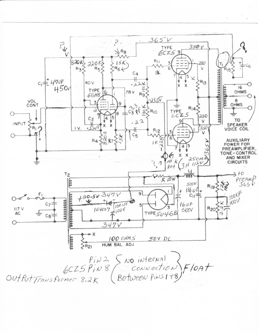

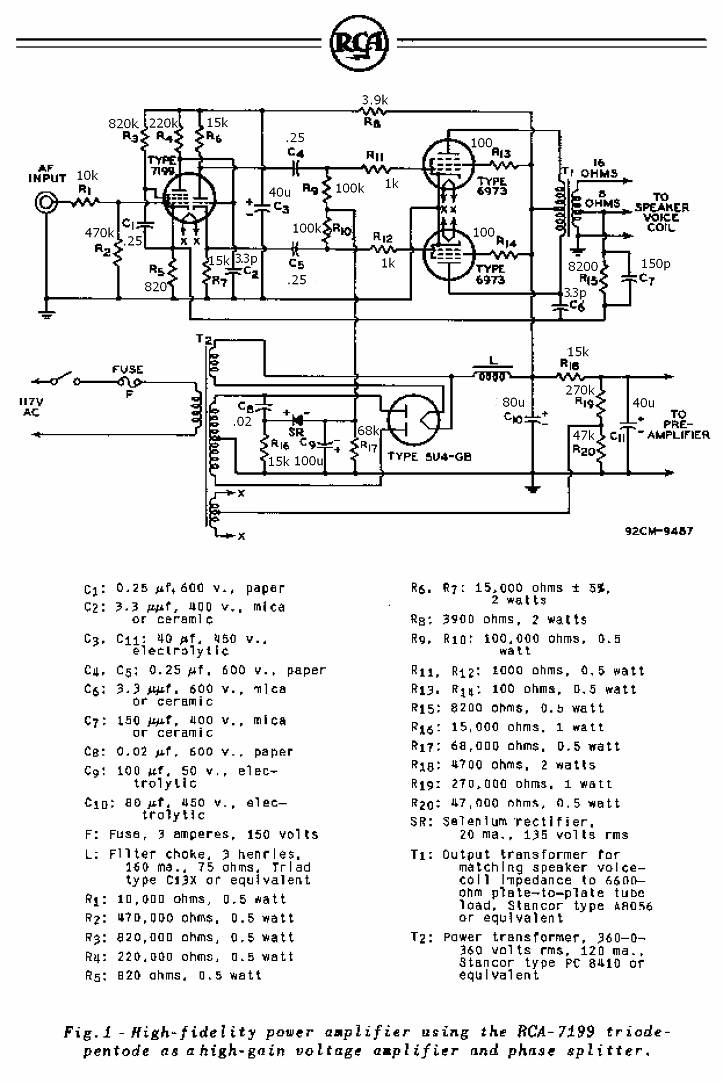

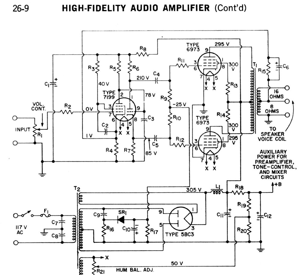

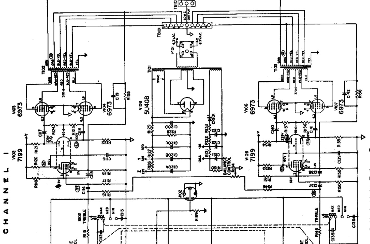

Hello Everyone, I need some advice please. I have a Knight Kit Stereo 40, KA-55 Amplifier that is trashed. I want to use the Power and Output transformers for this project if feasible. The first RCA schematic comes up in a few places on line. The second schematic also shows up on the net and has a few voltages attached that some seem incorrect in the power supply. Also attached is an ultra linear set up from a Seeburg jukebox amp that uses the same value resistors for the 7199 tube as the rca schematic shows. What I want to do is use 6GH8 and 6CZ5 tubes in this amp and use it as a power amp. I started working on a schematic according to the Sylvania 6CZ5 tube data sheets and what I have on hand around here. Please be kind, this is my first project and I am stumped as to if this will even work. I have rebuilt several amps in the past. Thanks, Tom
If possible, please provide the original Knight schematic.
A 100 Kohm log. taper part will be fine as R1. Perhaps the uploaded schematic fragment will help in sizing R8. Assume parasitic oscillation will be present and suppress that nasty with carbon composition stopper resistors on all control grids.
As it is unlikely your 6ZC5s are well matched, "stand" each O/P tube's cathode on a 1% tolerance 10 Ω resistor and employ individual bias trim pots., to match "idle" currents. Measure the voltage drop across the 10 Ω part and apply Ohm's Law to calculate the "idle" current.
Do you have any gas discharge regulator tubes on hand? Full pentode mode O/P tubes yield max. open loop linearity, when g2 B+ is regulated at a fraction of anode B+.

Thanks Ed, Attached is part of the KA-55 schematic and the power supply schematic. I do not have the instructions for the kit. I do have around 20-30 tall bottle RCA nos 6CZ5 tubes and some Sylvania's also. I should be able to find a matched quad. I do not have any gas discharge regulator tubes.
I can do the carbon composition stopper resistors on all control grids and put the output tube cathodes on a 1% tolerance 10Ω resistor and employ individual bias trim pots to match the idle currents.

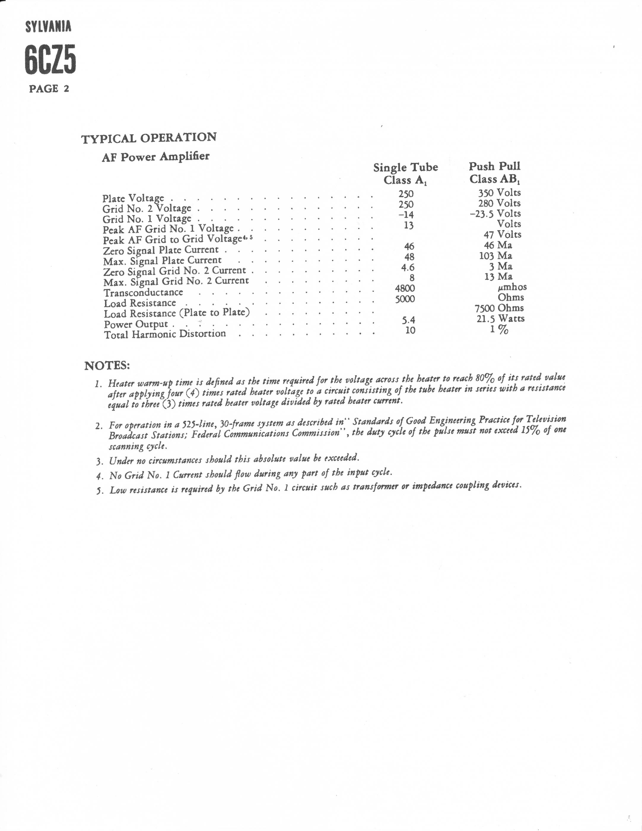

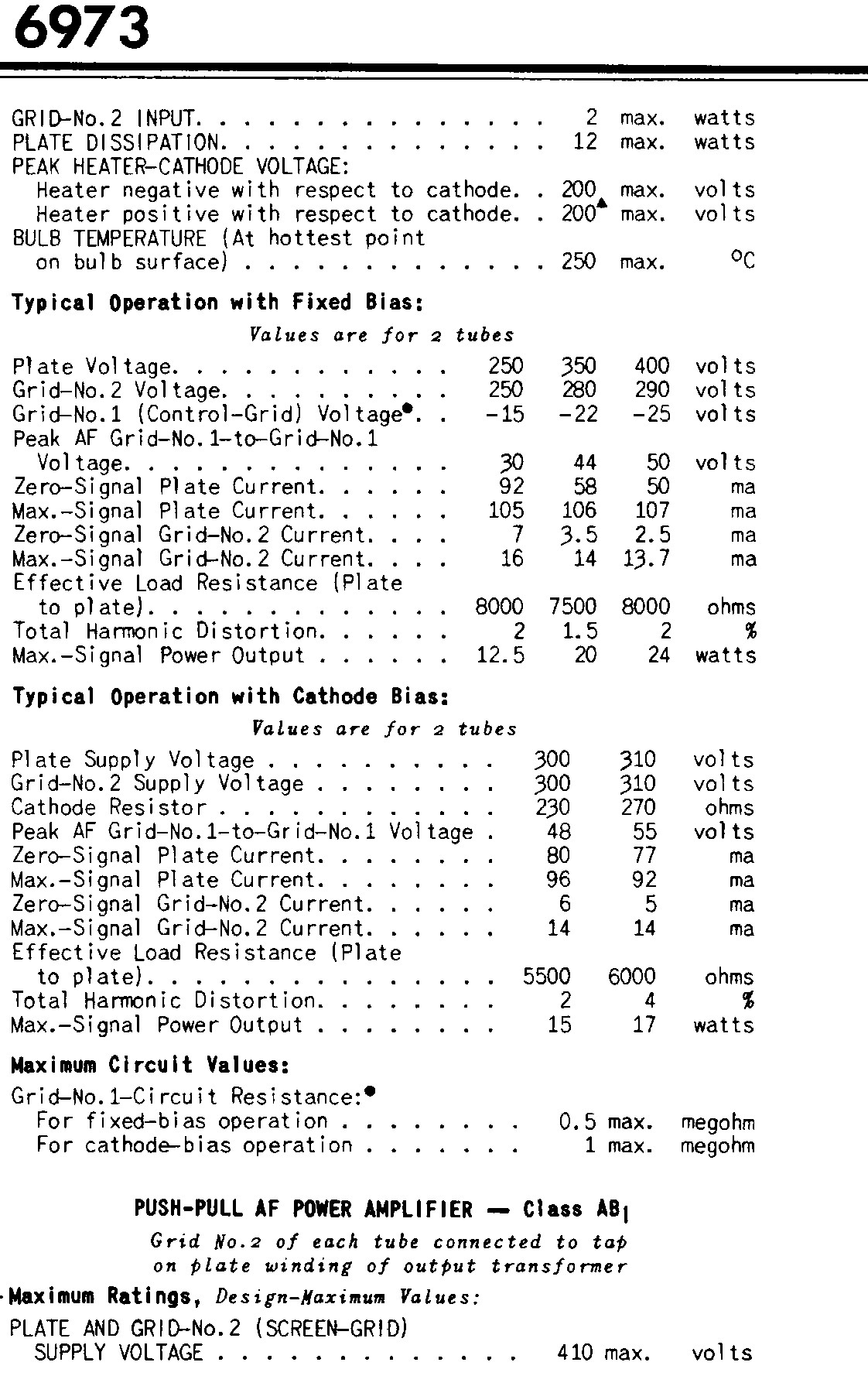

Attached are the 6973 and 6CZ5 tube specs for type AB amps.

Even with well matched tubes, separate bias trim pots. are a good idea.
You may be in trouble using a 5U4 rectifier, which draws 3 A. of filament current. The OEM 5AR4/GZ34 draws 2 A. Also, the forward drop in a 5U4 is greater than that in a 5AR4. You can completely dodge the vacuum rectifier issue by using 2X 1200 PIV Schottky diodes.
You are fortunate in being able to FWCT rectify the bias supply. A couple of these Schottky diodes will do nicely.
If I read the 6ZC5 datasheet correctly, stacking a 0A2 & a 0B2 will take care of regulating g2 B+. A stack in each channel will surely work.

BZX85B100-TAP Vishay Semiconductors | Mouser is I prefer, myself. But I freely admit not having affinities for the beautiful light show gas discharge tubes offer. I kind of like the 45¢ unit cost, and the fact that Zeners last essentially forever in service.
The only reason I didn't do a Mouser search for 220 or some other higher voltage is that I also like the added dissipation that stacked 45¢ Zeners offers.

The Knight power trafo the OP has is configured for a FWCT bias supply. A bias tap on each leg of the rectifier winding is a nice touch.
Yes, I did not take into consideration a 5U4 draws 3 amps. I was looking at voltage drop. I can get a 5ar4, no problem
Thanks for the ideas. Yes, the 20v taps are nice and convenient to have. If the 6GH8 configuration will work, I was thinking about building a Dynaco ST-70 driver board made for 6GH8 tubes for this amp.
A Dyna ST-70 board configured for 6GH8s is reasonable. However, the 7199 parts values from the SCA-35's power section could be best. Like the ST-35, the SCA-35 uses EL84 "finals"

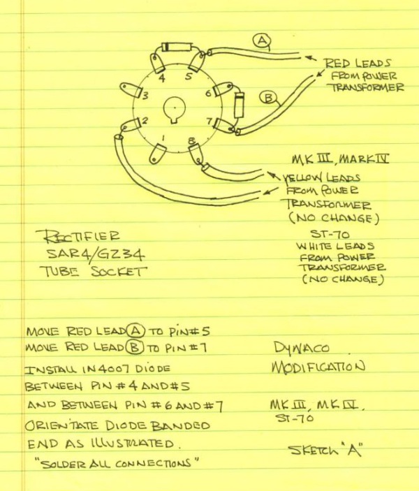

The Sovtek 5AR4 will serve you well, provided you install the series SS diode tweak. I suggest you use UF4007s, instead of the 1N4007s shown, given the concept that less SS switching noise, from the outset, is better, even though the vacuum rectifier blocks the noise.

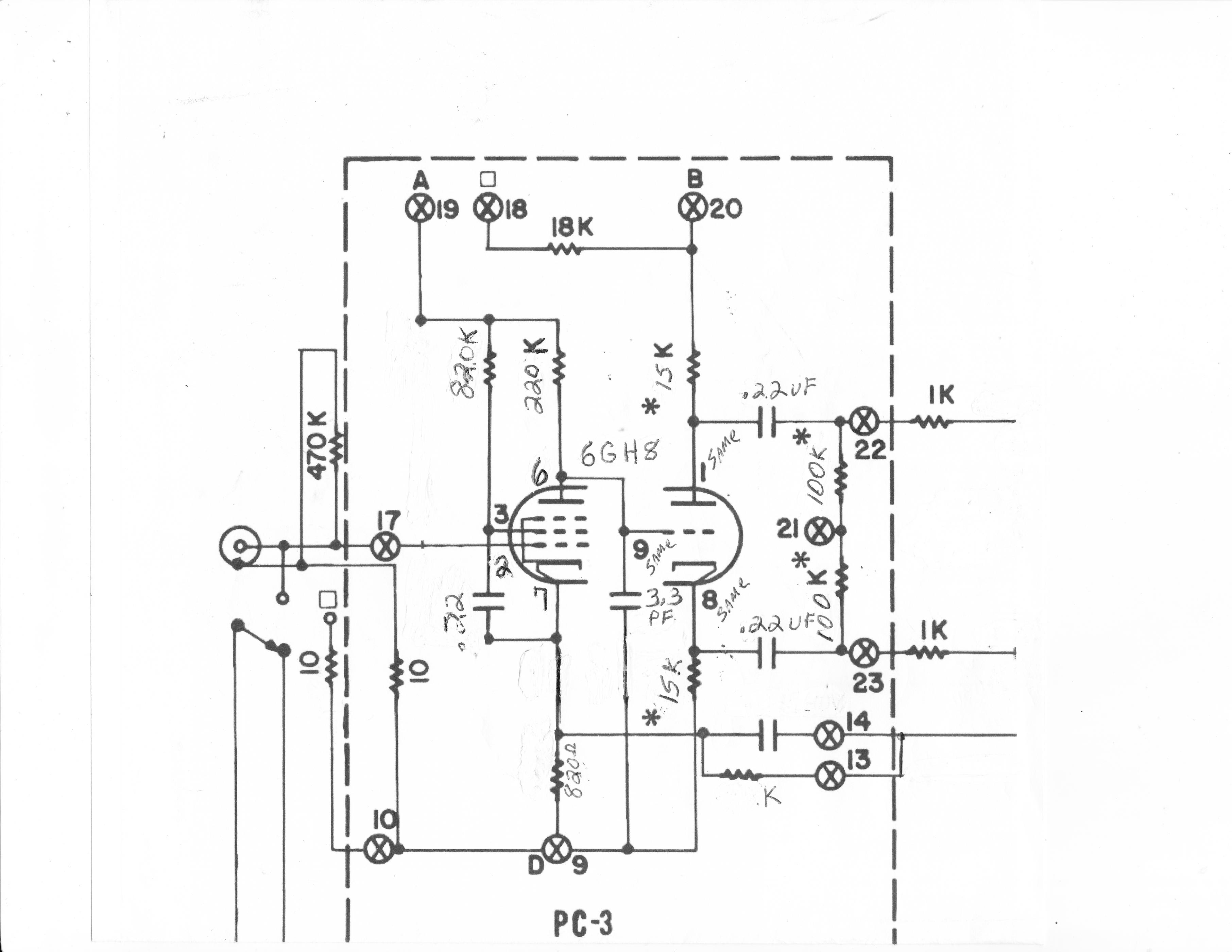

Thanks Eli, attached is a link to the 6gh8 driver board I want to use, also attached is a schematic of the PC-3 board with changes.

Be prepared to "pad" the volume control with some additional resistance. The pentode voltage amplifier may do its job too well and yield more gain than is necessary. The symptom of this situation is barely moving the volume control from 0, before the sound is too loud. FWIW, this is called a "hair trigger" volume control.
BTW, the 470 Kohm resistor shown across the I/P is replaced by the volume control. The control's wiper connects to the voltage amplifier grid.

Adjust the value of the 820K screen resistor if needed to get 75-100V on the 6GH8 pentode plate. The 1K bias trim pot won't do anything unless you add a resistor to ground at the junction of R9 and R10 to make it a voltage divider (I'd reverse the two, few K fixed resistor from bias supply, 10K pot to ground). Bias at about 30 mA - also I'd bypass the 6CZ5 cathodes (or use separate bias pots to each one, delete the 100 Ohm cathode trim pots - 2 pots instead of 3). That's assuming there's enough bias voltage - minus 23V should be enough.
Thanks for the advice Tom, Why can't the 100 ohm wire wound trim pots be used as bias pots on the cathodes of the 6CZ5? I have some on hand is all. I got the 6GH8 boards in today, ordered 2. Look real nice.
The cathode should be bypassed if they're used, will give a small amount of bias adjustment (3V or so), so you'll like likely need another bias adjustment. A pot in series as shown won't adjust anything, 1K is too low to use as a voltage divider - 10K would be about right. 1k would work, but there would be more ripple on the bias supply and it would be dissipating 1/2 W or so.
I understand the voltage divider part and I did not finish it to ground or add resistors, I do have a couple 2 watt 10k Bourns available now.
