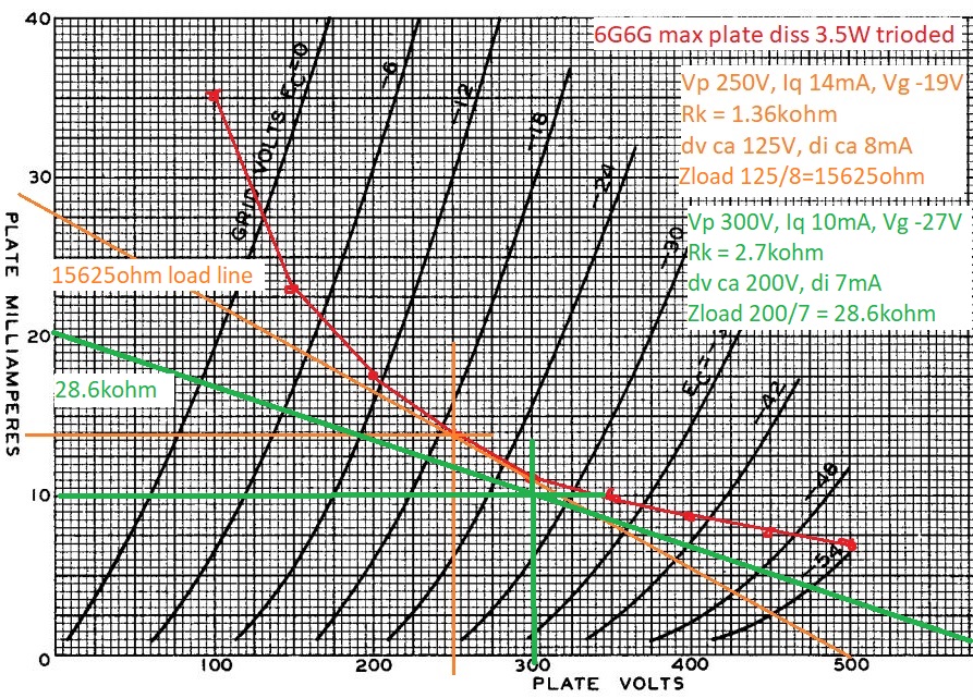

6G6-G decent preamp and driver tube?
If it is the American 6G6G you can expect a gain of about seven while it is triode connected. Originally designed as a low drain power output for American cars. The electrical systems were not very adequate at that time. In the 30s many cars had only 20A on a 6V system. At best, 30A.
Your tube might be a pull from WW2 military equipment.🙂
ok Thanks. I have about a dozen NIB and about as many pulls, all look good. I think they are from the '40s.
If these are not problematic with excessive microphony they will be used in my next build.
I've been trying the 6G6G in triode in my SE EL12 amp as driver tube. It's very nice, superior I think to the 6V6 in triode despite that tube's popularity. I compared it with the 37 which I have been using recently and though I prefer the more natural sounding 37 as a true triode, the 6G6G isn't too far away at all. So a positive recommendation here.
This looks to be quite an underrated tube. Available and cheap as well.
