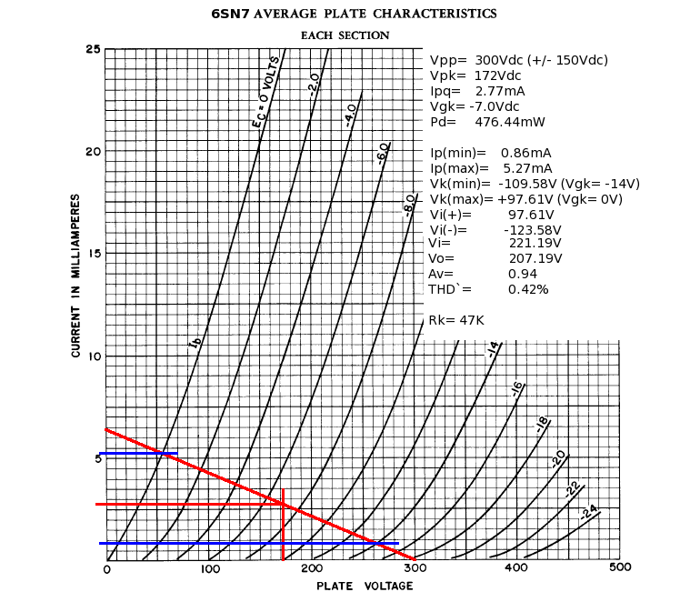

This isn't all that difficult to figure out. Given a Po= 17W, and a Rl= 8K (P-2-P) you can figure:
V= sqrt(17 * 8E3)= 368.8Vrms (P-2-P)
V= (368.8 / 2) * sqrt(2)= 260.8Vp (per phase)
Av= 260.8 / 22= 11.6
For the 6K6, Crt= 0.5pF, so Cmiller= 0.5 * (1 + 11.6)= 6.3pF
Cgk= 5.5pF, so
Ci= 5.5 + 6.3= 11.8pF, guesstimate Cstray to be: 30pF, and
Ct= 11.8 + 30= 41.8pF
At 30KHz:
Xc= (2pi * 30E3 * 41.8E-12)^-1= 126K9
I= V / Xc= 22 / 126.9E3= 0.17mA
By the "Rule of Five", the driver plate current should be 0.85mA or better. Given that you have a -150Vdc rail already, you're good to go there. The plate of the cathode follower can be set to +150Vdc for headroom.
As a side note: Do you know who I could ask to plot some UL curves if I send them a few of my extra Russian 6F6S tubes? It'd be very useful for everyone, I think.
Yves just might have some already.
Finally resurrecting this project. I've redesigned the 6SL7 LTP, feeding 2.5mA into the pair. By the rule of five, 1.25mA per 6F6 ought to be OK, right? In any case I still have enough heater current to spot an extra 6SN7 as a CF and I'm beginning to think it's worth it.
One question I have is the 150V that seems to feed the CF's in both schematics. Where should it come from, and how much plate current will each channel's 6SN7 need? I've got about 310V to work with but an extra 20mA total, say, will drag it down to 300V or so.
The two reference schematics also use different means of biasing the CF's. They both have capacitors to ground in common. What is their purpose/what is going on?
What is the resistor/capacitor from each output tube's plate to the CF input grids? Some form of feedback?
Also, what is the inductor/resistor network connected to each output tube's plate in both schematics?
Thanks a bunch. I really want to turn this amp into a reality.
P.S. Yves says he's super busy at the moment, and his curve tracer isn't in operation...
The new 6SL7 LTP has an output impedance of 28K or so. Is this objectionable?
The details (rounded a bit):
B+ 310V
Ia total: 2.5mA
C- 155V
Ra = 80K 1W on top, 82K 1W below
Rk = 62K 1W
Va-k 210V
Vg-k = 2.11V
Gain = 22.25
Vo max = +-47V
(Thanks TubeCAD)
