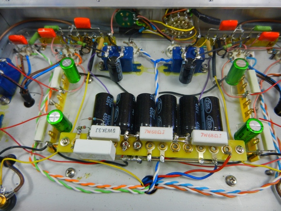

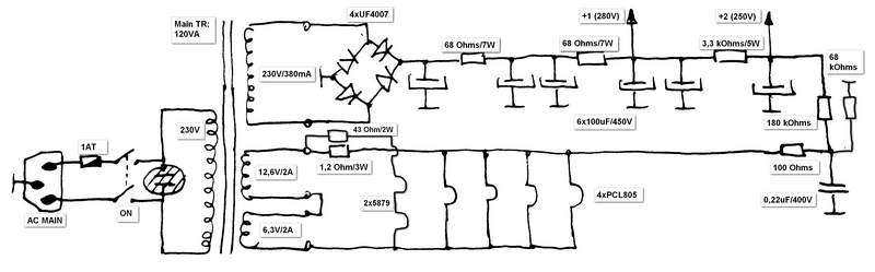

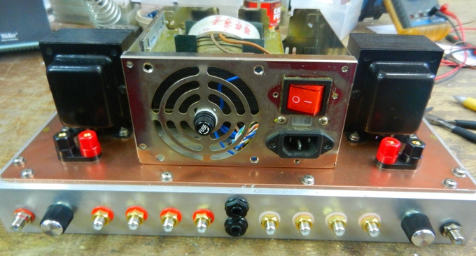

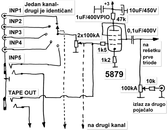

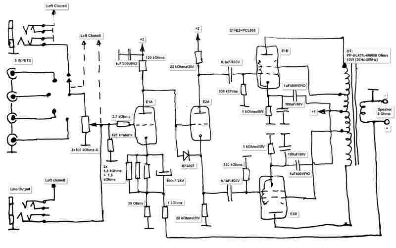

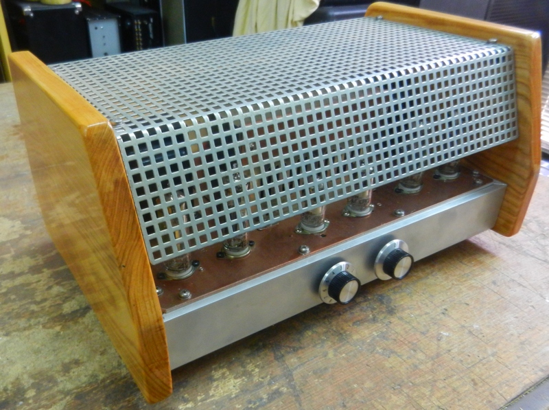

Here is my small int.amp. with 4xPCL805 and 2x5879:

PP circuit are used in chokes, cathode resistor, is not a good way, it will seriously affect the PP circuit performance.
Why not indeed! With almost double the allowable plate dissipation (9W) a pair of ECL86s will easily produce 14 watts of power with 300V supply voltage.
