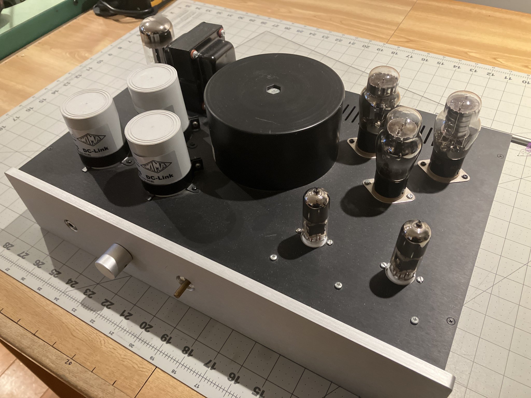

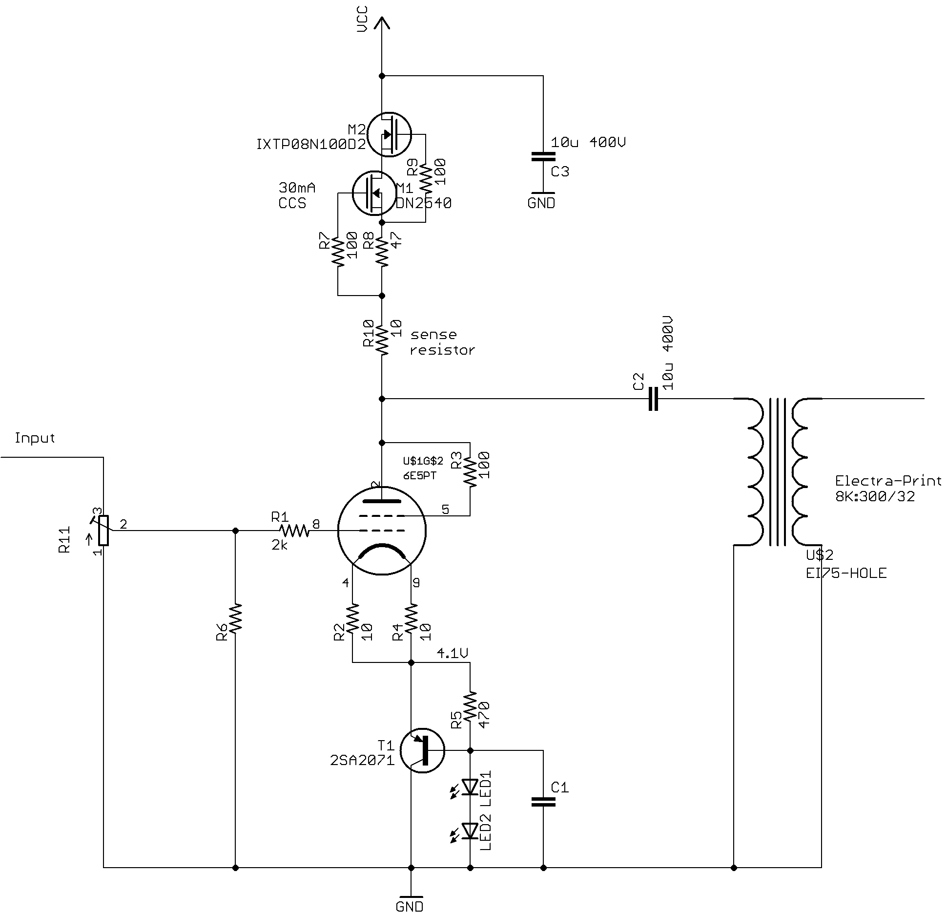

I've been working on a single ended parafeed headphone amp that I've had for the better part of the past decade. Every few years I take it apart to try something new. Most recently, I converted it from 6S45Ps to 6E5Ps and can't seem to dial these new tubes in.
I've attached the schematic of the amp section and a photo of the amp. The power supply uses a big SumR toroid followed by a 6BY5 rectifier and LC filter (5H + 420uF MKP). The raw supply is shunt regulated. The regulator is a simple IXYS DMOS CCS with no cascode set to 120mA. The shunt leg is a high voltage MOSFET with 3 0C3 glow tubes spanning from the drain to gate to generate a 330V regulated B+ supply. All tubes are heated with AC, with the rectifier tube and signal tube on different windings.
The amp section is quite simple. The 6E5P has about 4V on the cathode and is biased to 30mA with a CCS on the plate. There's a 2k grid stopper, 10R on each cathode pin, 100R on g2, and I've experimented with plate stoppers but ended up taking them out. The tubes are on teflon sockets which mount directly to a small PCB, and the stoppers are 0603 thin film resistors that are physically no more than 2mm from their respective pins.

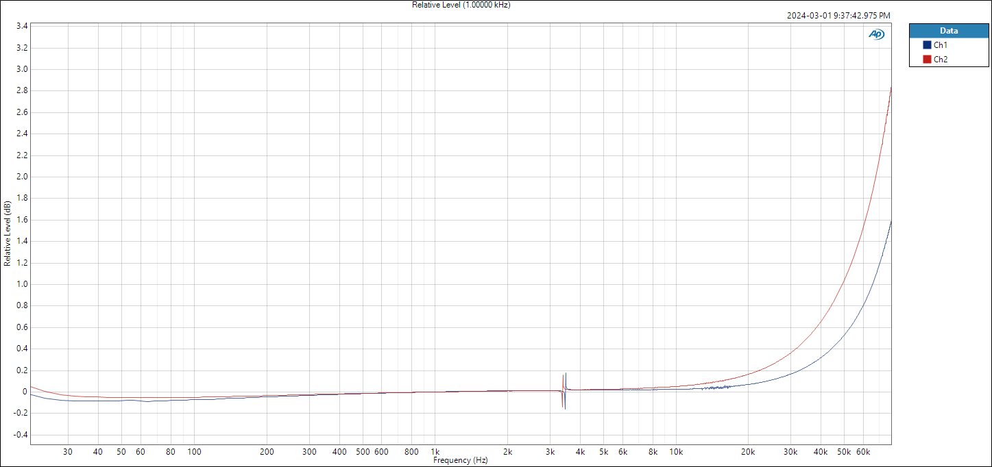

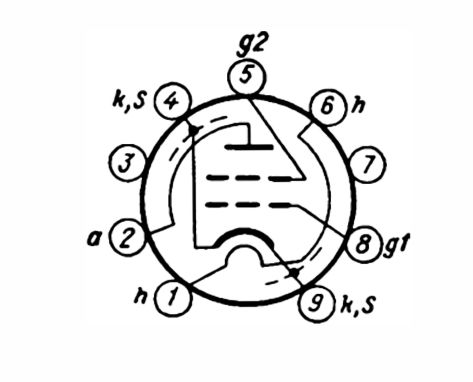

The issue I'm hearing is really strange. Certain notes seem to excite a microphonic resonance in the tubes right around 3.5k. As the volume is increased, the intensity and duration of the ringing inreases, too. Hi-hats just sound miserable.
I had a couple of hypotheses: either the tubes were oscillating at RF, making them more prone to microphonic ringing, or there's some junk sneaking in through the power supply. Here's a partial list of things I tried.

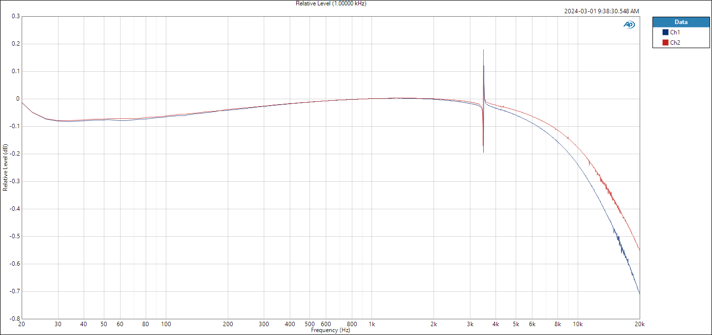

And here's the noise floor, with input transformers, taken before running the FR sweep. Note the peak at 3.5k and the rise in the noise floor centered around 7k. This measurement was also taken with 20k grid stoppers, and the rise at 7k was much higher with 2k in place.
I know the tube is well liked here. Any thougts on how I can get them to sound good?
That's a very odd problem. I would say there is something oscillating at 3.5KHz but not the amp. It too high a Q for simply LC. Could it be your shunt regulator like the glow tubes with the mosfet capacitance. The other thing to try a a series resistor with the output coupling cap.

Why the SS in the cathode when you have a CCS in the anode? They might be fighting each other. Can you try replacing the cathode reg with a resistor and see what happens?

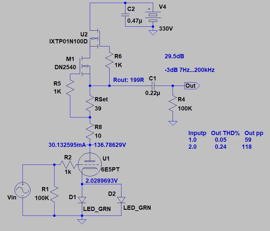

What if you replace the pnp tr. and the two leds and the 470 ohm resistor with : 4.1v/30mA= 136 ohm resistor. Actually use a 200 ohm pot (Bourns 3299, or 3386). This way you have the added advantage of setting your plate voltage to 1/2 B+ by adjusting the 200 ohm pot. The plate current is set by CCS, adjusting the cathode pot would not change that.
You have no way of adjusting your plate voltage in your circuit. Also the leds current is only 1.2 mA.

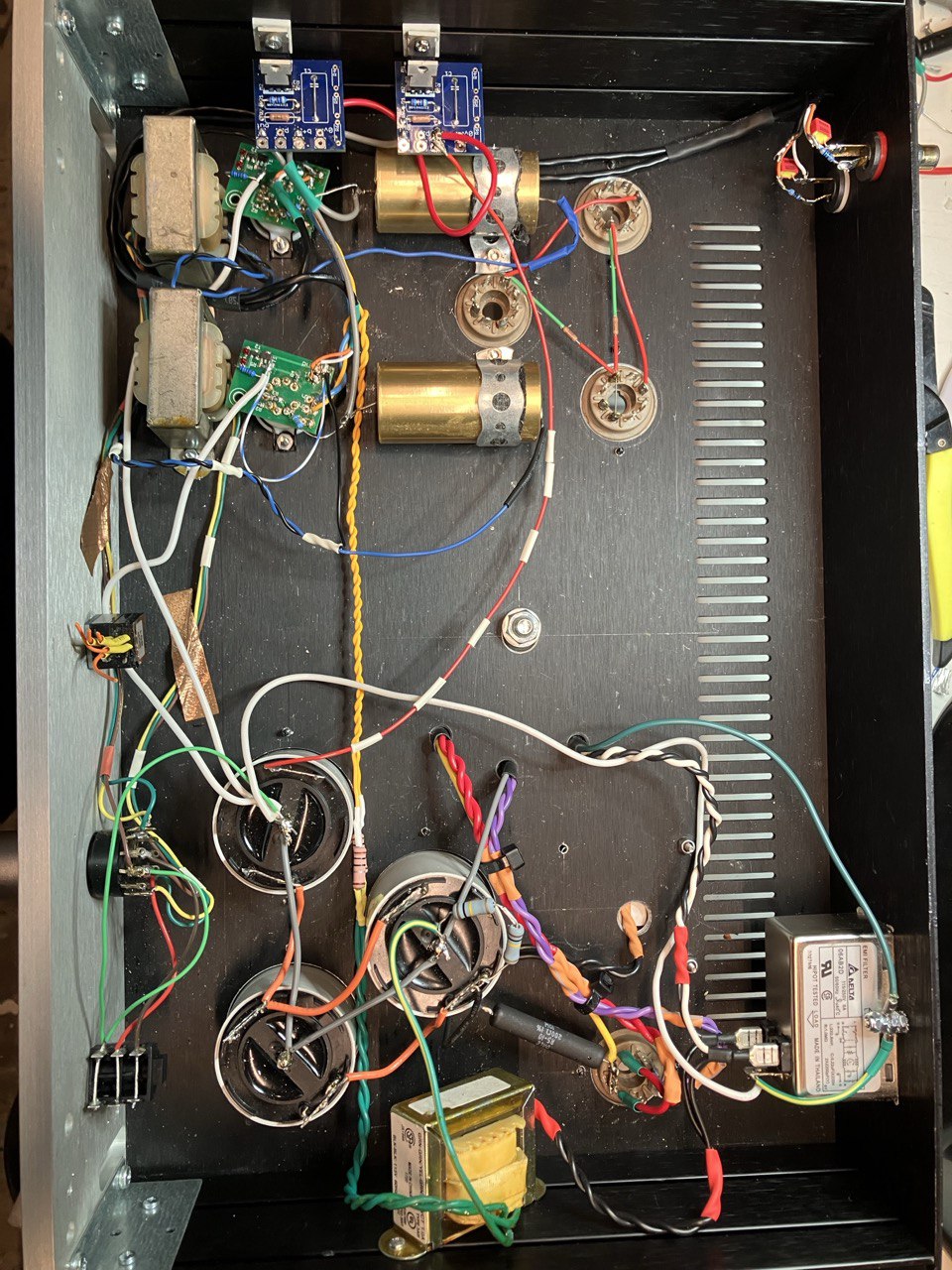

Here's a photo. The amp has seen better days, right now it's a bit of a rat's nest.
I just removed the regulator entirely, so the three octal sockets in the back are not connected to anything. They were for the glow tubes. I'm listening to it now-- it's great, but some songs still make the tubes ring. I wouldn't be surprised if someone with a different music catalog didn't notice it at all.
The two blue boards are the plate load CCSs. The green boards mount directly to the 6E5Ps which are on teflon sockets.
I've also disconnected the volume pot. The input RCA goes into an EMI filter (1k + 330pF), into shielded mic cable to the 6E5P boards. I've tried tying the shield to different grounds and haven't noticed any difference, so right now the shield is floating.
The rotary switch next to the headphone jack is an impedance switch.
The small transformer inside the chassis for the 6E5P heaters. It's a 12V transformer, so the two heaters are in series, with the center tap tied to ground. I tried elevating the center tap but I can't say it changed anything.

Some comments.
You use the "wrong" output of cascode CCS.
The "low Z" output of CCS guaranteed much lower output impedance. It's most "immune" to the cathode resistance changing.
The cascode CCS stage does not require regulated power supply, the only criterion is the appropriate headroom (at least 30V greater B+, than output swing upper corner).
If you use CCS loaded stage, the LED is prefect in the cathode. If you want higher bias, series connected (if the current is high, paralleled series strings) LEDs even gives lower dynamic impedance, than BJT.
The CCS loaded 6E5P gain is enormous (near 30dB), so any mistake may generates excitement. It's also has very high bandwidth, so some restriction is necessary.

BTW 6E5P cathode pins 4,9 must to connect together with wire (as short as possible) under the socket, instead of 10R resistors.
These pins are the inner screen too, so AC grounding IMO is necessary.
