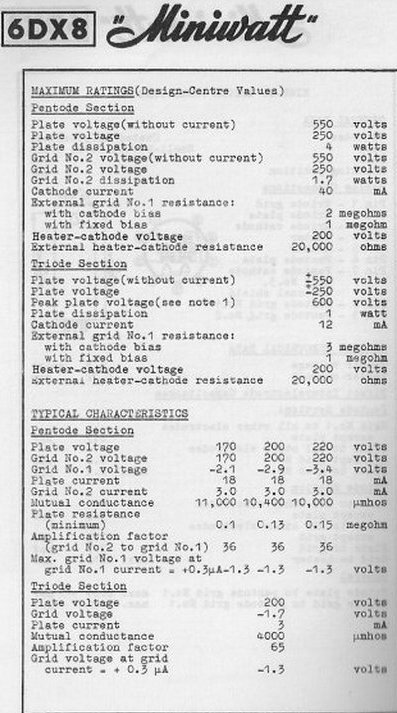

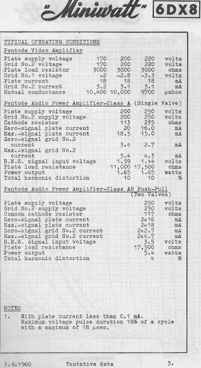

Hi@all,
some time ago someone provided a 6DX8 datasheet to our community that in contrast to any other known sheet showed AF (SE and PP) applications for this TV tube. Sorry, as it is a *.webp file, I can't upload it anymore. I hope the person may recall anyway. Does he have the complete and original sheet without watermarkings or know a source?
Best regards!
The 6DX8 electron is equal to the ECL84 according to PHILIPS.
